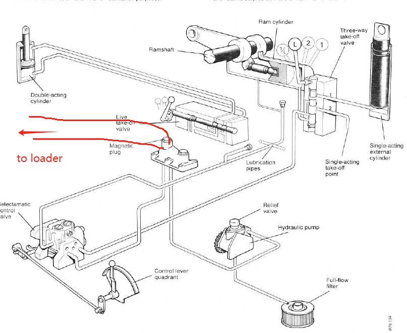

Center raises the tph and I think my loader is loader is plumbed as you show circled...

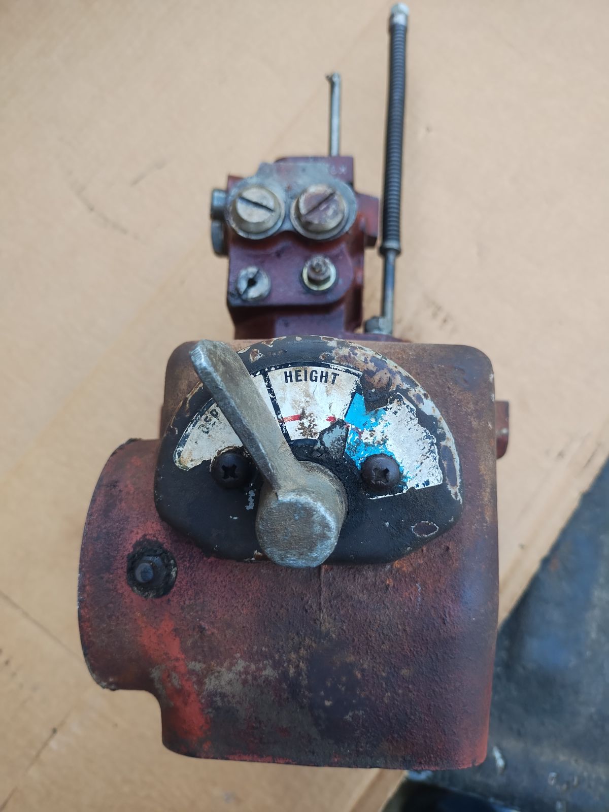

I noticed the switch dial #13 on this DB can be turned anong left/mid/right 3 position no matter the hand lever is in the rearmost selection position or not. In contrast, the manual says you should first pull the lever all the way back, then turn the switch dial. Is it normal on your DBs?
Btw, the switch dial knob on this DB is damaged. The wing on #13 is gone, left a bare stud. I turned it with pliers. Not sure if it's another redneck modification. Because the remaining of #13 looks very heavy duty, should not be easily damaged, and damaged in that clean cut manner.

Correction to last post: The dial switch should be okay. When the lever is not fully pulled back, the switch can be turned from left or middle to the right, but not able to be turned back from right. So the dial switch linkage should be okay.

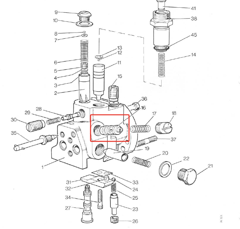

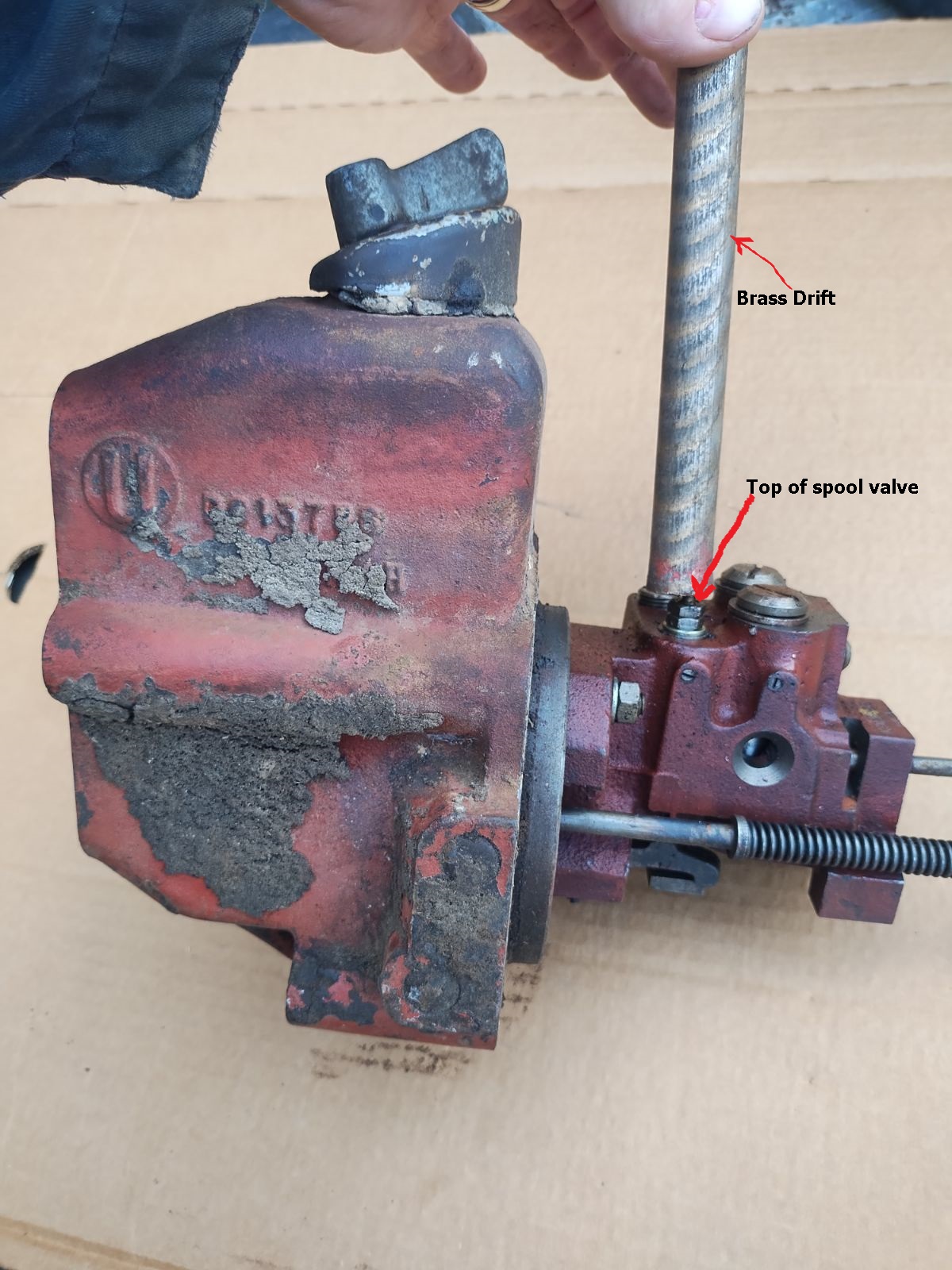

Found the lever doesn't move the spool valve. When I moved the quadrant lever from one end to another, and observe through the inspection window, the tip of spool valve didn't move at all. Might be something wrong with the lever control rod or the linkage mechanism.
According to manual, when spool valve seat at the bottom, it feeds pressure to the ram cylinder (which is my case). When push the lever forward, the control rod will push the spool valve upward to the middle/hold and upper/bypass position, the ram cylinder will stay and lower. So it should be the issue.

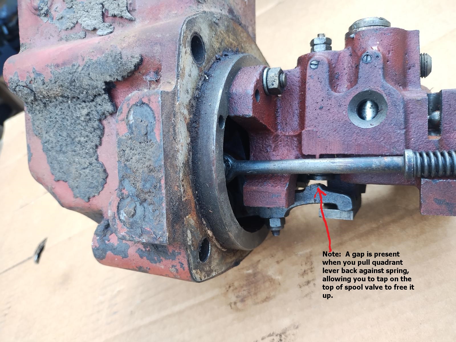

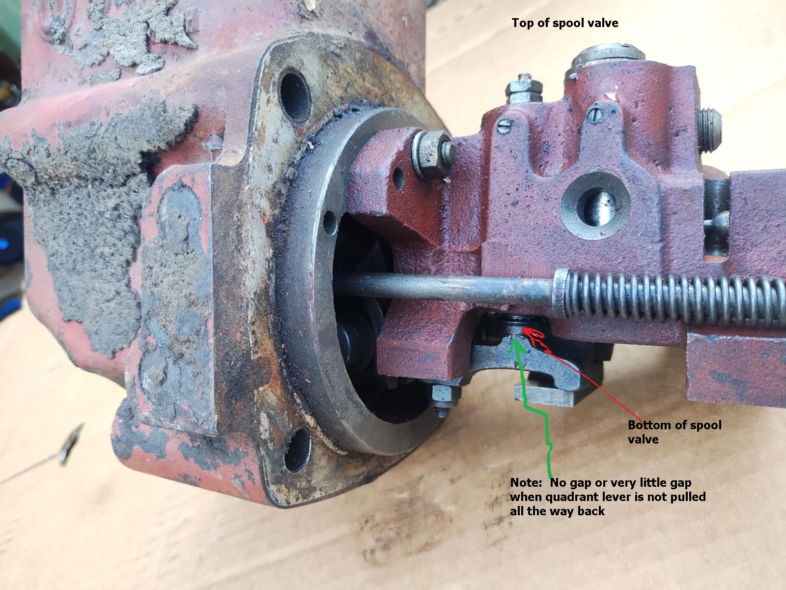

Your spool valve is frozen, probably from some trash in that milky hydraulic fluid.
Take a brass drift and gently tap on the top of the spool valve. Do this while the selector dial is in the "depth" position (as pictured) and a friend is holding the quadrant lever all the way to the rear against the spring. Spray some penetrant (WD-40, Kroil, PB Blaster) on the top of the spool valve before tapping.
You will have to use a smaller diameter brass drift than the one I have pictured. You will also have to be a contortionist in order to perform the tapping, since the spool valve lies askew to the kidney shaped opening in the case. It might be beneficial to remove the seat in order to open up the work area and allow yourself to angle the brass drift through the kidney shaped opening and to be able to tap on the end of the drift.
It is important to have the selector dial in the "depth" position and to have a friend hold the quadrant lever back against the spring. By doing this, you are moving the "hammer" away from the bottom of the spool valve, such that when you tap with the brass drift, the spool valve can move. Otherwise, you would be tapping against a hard resistance (solid steel).
I am recommending that you TAP. Do not POUND on the brass drift. You do not want to bend anything or damage threads.
I have freed up a couple of spool valves using this approach.
Having said all this, I still have one DB990 here that has been refractory to all attempts to free up its spool valve. I will have to remove the valve chest and approach the problem on "the bench".
I hope you can free yours up "in situ".
View attachment 62987View attachment 62988View attachment 62989View attachment 62990

Per manual, the 'thermostart' is in the fuel pump, a butterfly valve, and it's optional feature. On this tractor, the buttlerfly knob is gone (or never existed). Since it fires up every time eventually as long as the battery is strong enough, I have not digged into the thermostart yet before solved more critical issues (lift hitch, sinking loader, milky oil, frozen brakes, rusty links).
The hydraulic system on this tractor has been modified in pretty redneck way. They cut off the top of "connector plate" (part#K917127), and welded 2 fittings that lead to loader control valves. Homemade quality welding. According to the diagram, in this way the pump feeds pressure to the loader directly.
Manual says the pump is driven by PTO shaft. So you should be right, in theory the pump should stop when PTO shaft stops. I didn't notice that yet. Too many things to worry about (vague shift, stiff clutch, throttle don't stay, loader keeps sinking) As a newbie, every time sitting on the tractor is as scary as rodeo for me.
wechat%E6%88%AA%E5%9B%BE_20240315081043-jpg.62689
wechat%E6%88%AA%E5%9B%BE_20240315081125-jpg.62690
Does the redneck way the "the pump feeds pressure to the loader directly" mean that the pump can only work the loader and never the 3pt hitch?
They cut the connection plate in right hand that with a pressure test port, the test port was cut off and welded 2 fittings to feed the loader. So that the loader and 3pt hitch are in series. Pump feed the loader directly which is the upstream, the return oil from loader feeds into the 3pt hitch control valve and ram cylinder.

Yesterday I removed the valve chest. As expected, the spool valve is fully stuck. Next step is to remove every valve, clean and reassemble.

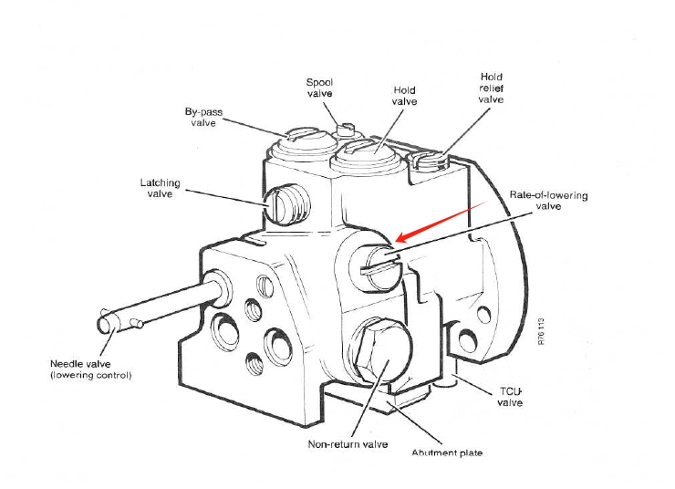

HELP!
Today I started to dissemble every valve from the valve chest according to the sequence on the manual.
All valves were removed, except the "Rate of lowering valve". I removed the cover. The plunger/spool stuck inside. I tried many times with pliers, no luck.
Any idea? Many Thanks

HELP!
View attachment 63885View attachment 63886
Aho! 5/16 deep socket bolt extractor works.
The teeth bited the nipple, twisted it, pulled it...
