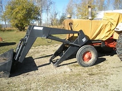

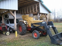

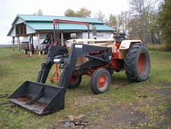

This Loader was on a JD 30?? series....
My Neighbors assured me it would NOT/ NEVER fit my CASE 830........
Imagination,and a cross section of skill sets.......:)
Hang the loader/ loader frame....from rafters......between two trees...etc,etc,
Start fabricating...

I still prefer the mounts to go back to the rear axle and bolt there. then if you want the loader frame to come off from there fine. I don't trust those bell housing mount loaders to not break the bell housing then you got a mess to fix. With it going to the rear axle they lift from there and are supported from both ends of the tractor. I see a good number of broken tractors from loaders mounted to the middle of the tractor so all the stress is on the middle when loading and carrying loads. Most were probably from abuse but still happens.
Yes, but a lot depends on what you are doing with it. For just moving dry round bales and not driving 15 mph over rough ground, the frame mount loaders will work fine. If you plan on digging dirt and generally abuse you tractor and loader, you can very well break your tractor in half without the back axle support.
