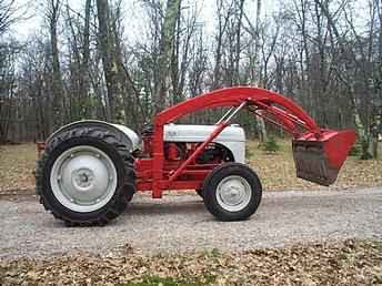

Does anybody know where I can get a new hyd. cylinder for the bucket and what make of loader this is?

I believe that is a Skyline 90 loader and I think it was made by Davis (but is not the same as a Davis 99). It may show as related to Midwest (which Davis bought) in some searches. It is long out of production.
I doubt you will find a new cylinder other than measuring every detail of the existing cylinder and finding the closest match you can. What is wrong with your cylinder? A full-service hydraulic shop should be able to rebuild it even if it needs a rod or barrel.
Thank you for the info. Yes it would need a complete rebuild I was hoping to get it faster than sending it off and waiting. I have looked for a ram close to this one but haven't gotten close yet. But thanks again for the information.

Even if you could find a repalcement cylidner i dont think you could get it faster that a hydraulic can rebuild yours.

Odds are you are not going to find an exact match. Most loader cylinders are completely custom lengths.
What's your closed length center-to-center on the pins, and the stroke length (or fully extended length center-to-center)?
Hydraulic shops around here are weeks or months behind. I ordered two cylinders from "RuggedMade" the other day and they were here in 2 days.
Some cylinders may be widely avaliabe and able to ship quickly. I just put a new one on the dozer at work a while ago and we got it in just a few days. His loader does not have a modern mfg to supply parts. Unless he can find a used on on the internet a shop would probably be his best bet.
