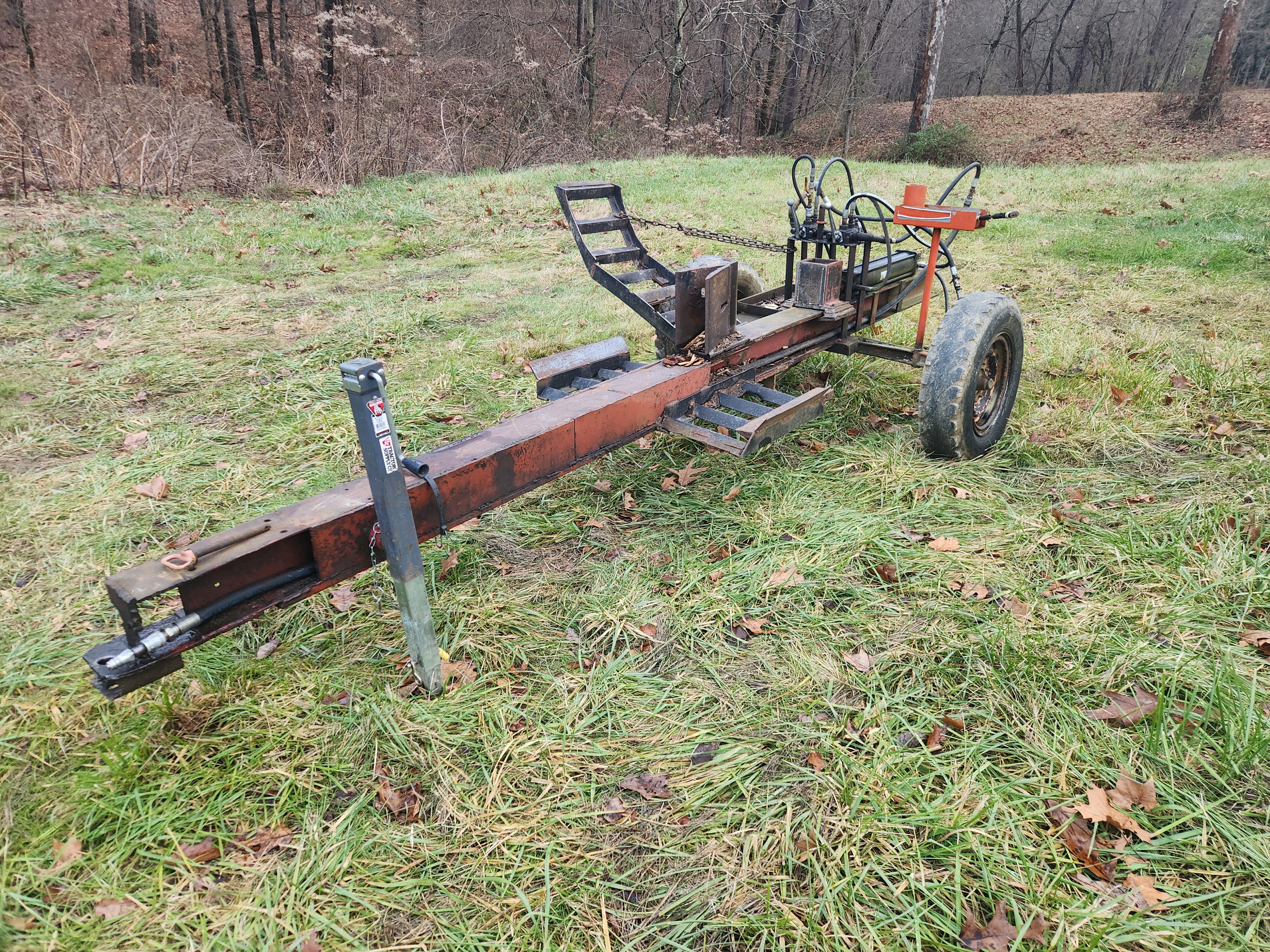

Here's mine I built in 1985 I put one on each side of the wedge. I can unbolt the wedge and move it out on the end to split 8ft locust fence post. I had a few motors on it through the years now it runs off my tractor hydraulics. She ain't pretty i made it with whatever I could scrounge up at the time but still works good today.

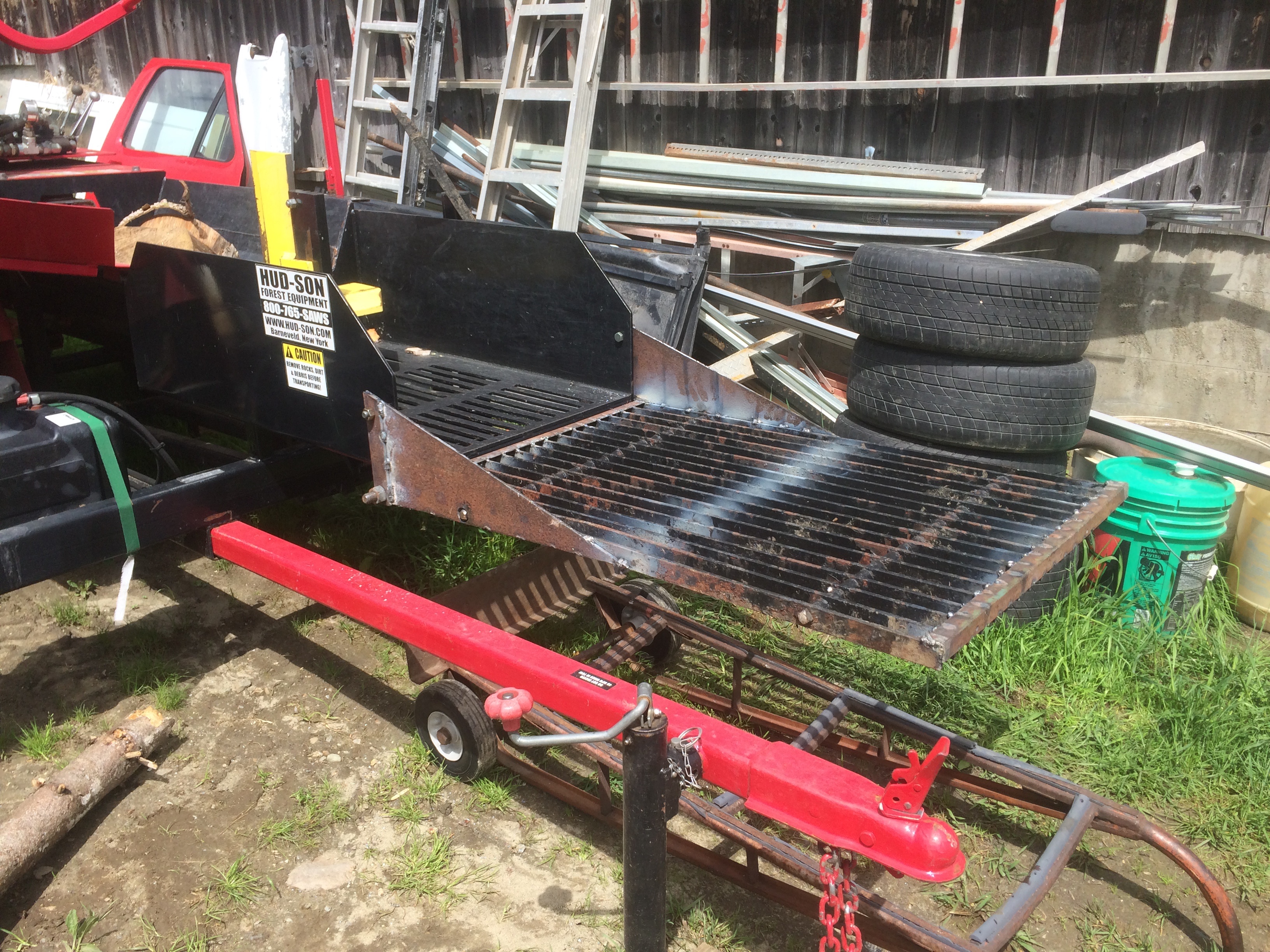

Scrapped a steel fire escape. This was part of the landing. I used two of the steps to make a table for my other splitter. Since this photo was taken, I added sides the full length of the table with
