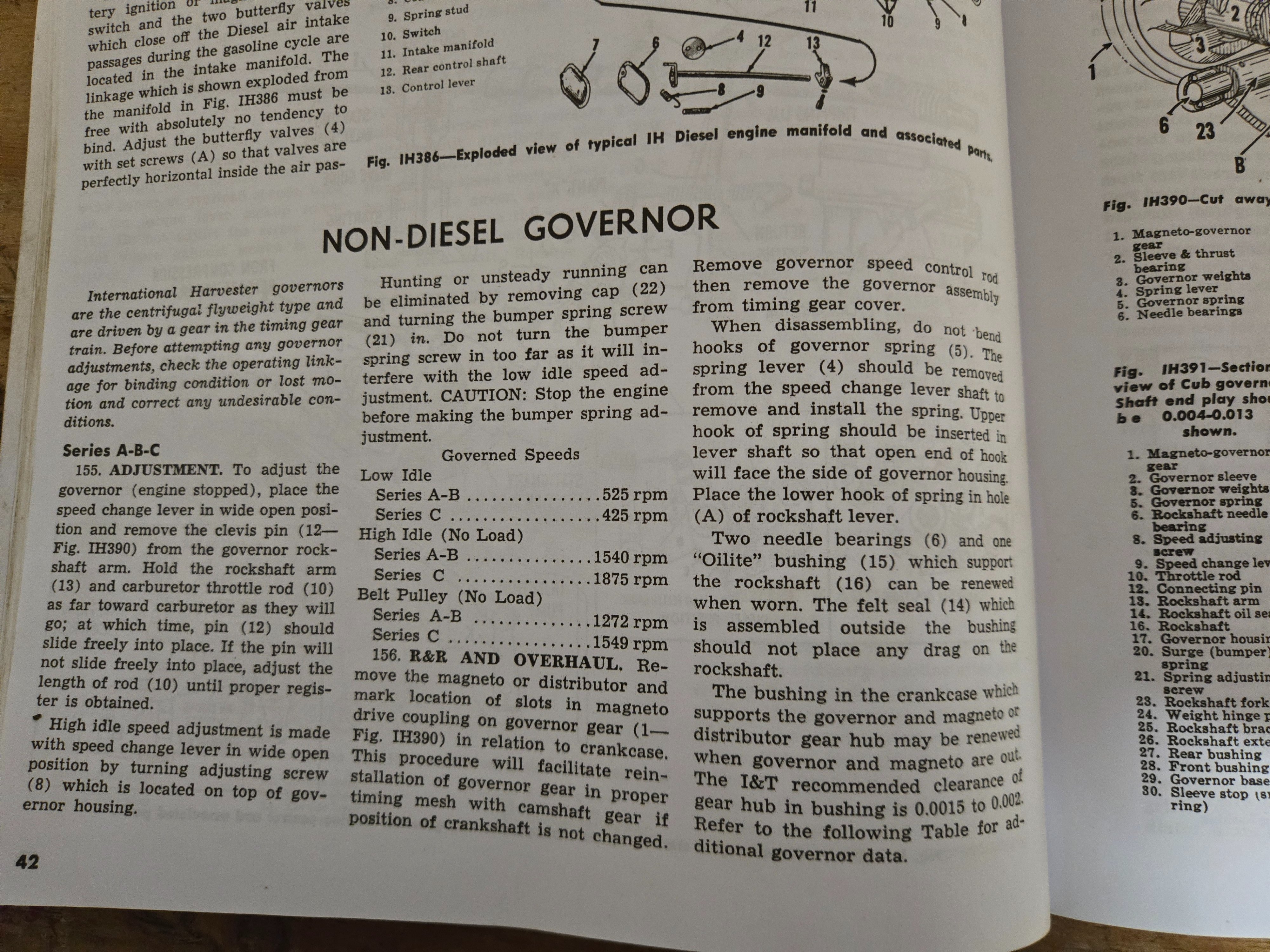

Yep, you guys beat me to it. Like mentioned above id suspect the spring is done. Here's a pic of the insides of a govenor from a '47 a i have sitting on a shelf. 20260107_172950.jpg
Edited to turn the picture right side up
Sorry, the pages are in the reverse order. Had both pics loaded but once again this one was upside down.
Thanks! Let me check the carburetor first and then I'll go from there. Are those two pages all I need to follow to take the governor off to service should it in fact need a spring? Also, what manual is that, I think I will go ahead and get my own.
Its just the I&T shop manual. Im sure there are better ones out there. This one covers the letter series farmalls and the cub.
While removing the governor from the tractor, don't remove the gear assy., because it drives the distributor and you would likely get it out of time. Not a fun job to remove the governor housing as the fan shroud is right there. Unbolting shroud helps a little bit to give more access.
