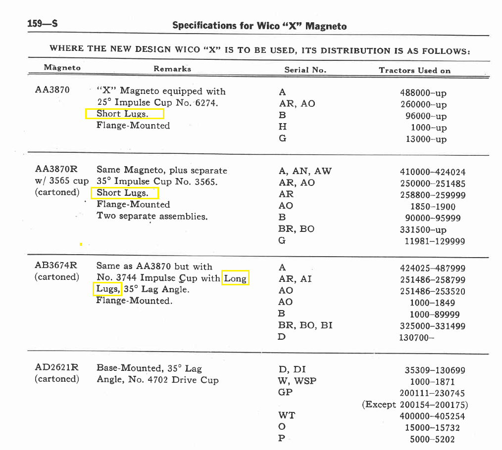

I have a 1936 Model A and I currently don't have a magneto. Can one tell by looking (without having a magneto on hand) whether the magneto I need is a short or long lug? I looked inside the case where the mag fits in, and I saw the number "33" stamped on the piece that receives the magneto, The "33" was inside a keystone shape. Thanks for any help.
According to a magneto replacement chart in Field Service Bulletin 159-S, model "A" tractors from S/N 424025 to 487999 used long lugs. All other "A" tractors used short lugs.

Thanks for the info--now if I can find a magneto in the SE South Dakota, NW Iowa, SW Minnesota area, I can continue my project.

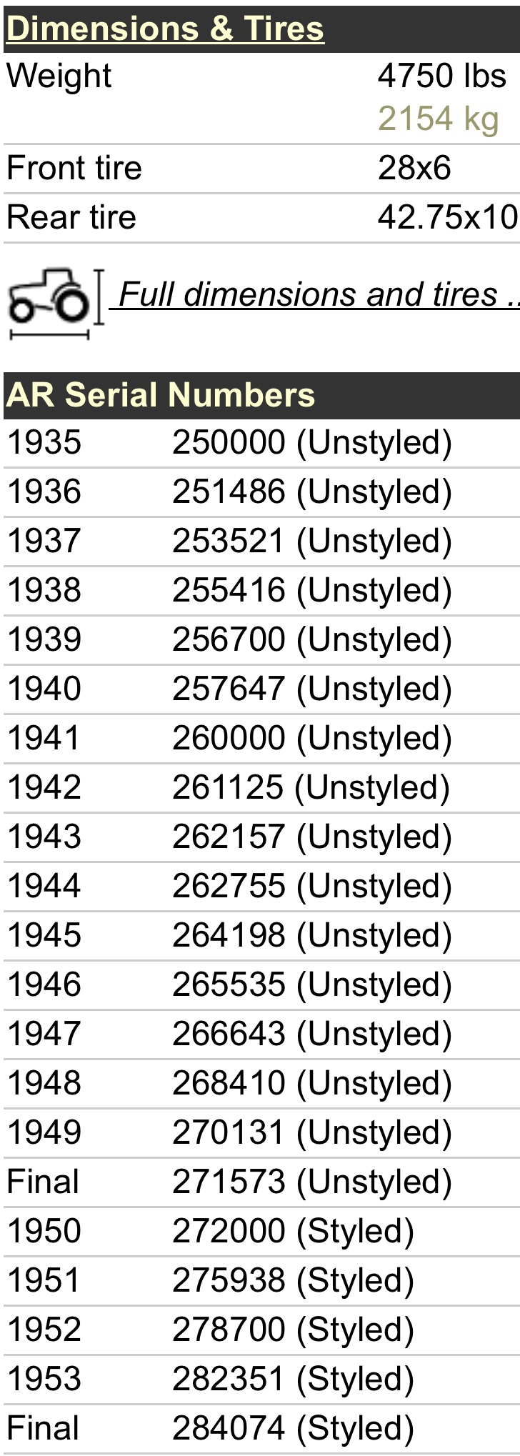

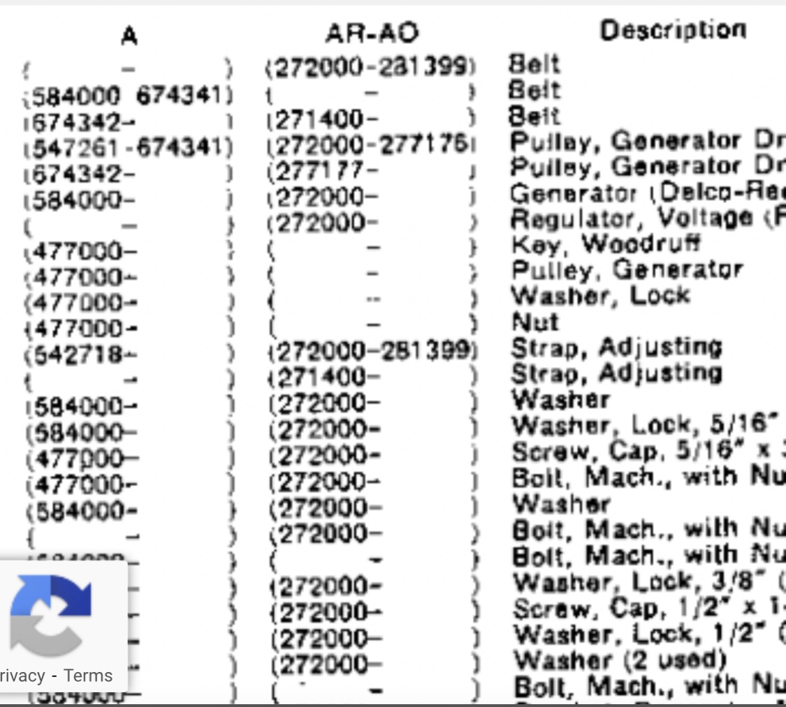

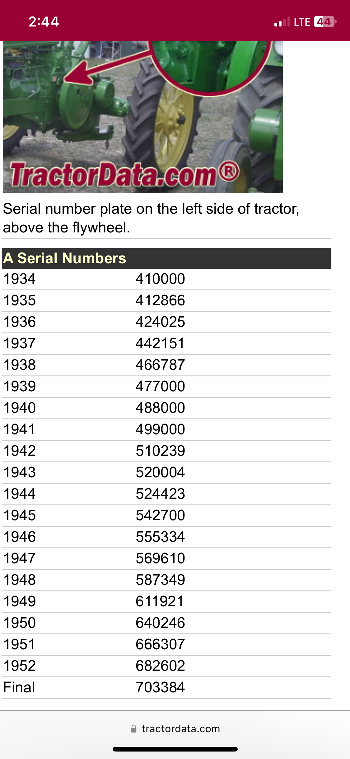

I wonder if there was a lighting option back then ?
Looked at the parts book . Not sure when the A had lighting . The AR and AO were early
according to the parts book . 1939 was the first year for a generator on an A . Thought it was years sooner .

I’m assuming it would be the similar to the b as the g at home looks generally similar. I think it would take a different fan shaft to get that pulley? I’ve never measured the 2 at the farm to see but I think everything else is the same for the life of me I can’t remember if there’s that generator cross over bracket down below either that would be the other thing. This is a question I’ve actually had. lights on my mower might be nice from time to time especially living on the highway if I wanted to scoot to the farm and it got late.
