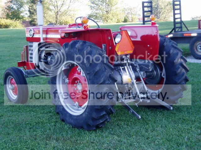

I never had a 150. My 2135 Turf is an outstanding tractor. Your 150 in the photo is the nicest looking 150 I have seen.
