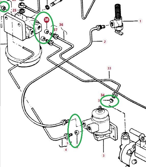

I don't have a MF240 manual to see their wording, so slackening the unions may be the same as the high-pressure fuel line nuts, I mentioned. These would be the nuts on the steel lines from the injection pump up to and attaching to the side of each injection nozzle delivering the high-pressure fuel. Did you get fuel from those lines?
How did you clean the injectors?
The green circles, in the picture below, show the locations of some of the olives. The parts book does call them sleeves, olive is a very common name for them, with many mechanics. The fitting nut slides on a tube, then the olive (sleeve), before inserting into the hole of the receiving fitting. Tightening the nut compresses the rubber sleeve sealing the tube. The old ones usually do not come out of a female fitting without digging, most often destroying them, you would need to install them, or new ones, on the lines into the new lift pump.
I have attached a link to MF 240 parts book for serial numbers 0001 to 522354. If that is not the range for your tractor, click on Home on that index page. On the home page Click on parts Book. When the parts book page opens type MF 240 in the search box below Model and it will open the MF 240 choices for you (there are 7-8 of them). You need to determine if this is the right book for your tractor then find the lines you worked on to select the correct olives(sleeves) as there are different sizes. (They are used on the fuel supply lines, not the high-pressure lines.)

The injectors were dismantled and soaked in chem-dip for about an hour and reassembled. As for the olives we did not see anything that resembled a rubber gasket when the fuel lines were removed from the lift pump. We have to revisit that to see if they are in fact, plugging up the connection. But, on the other hand we have been getting fuel to all the bleed points when the fuel lift pump is activated. Looking into ordering some olives now. I assume this is the serial number of my tractor? see attached photo

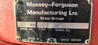

From your serial number tag it looks like you may have a Great Britian 240, so the fuel lines might not be the same as the ones in the parts book I linked for you. You may want to check the other parts books for the Great Britain 240s to see if those match your tractor.

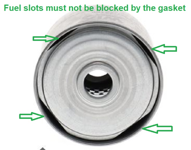

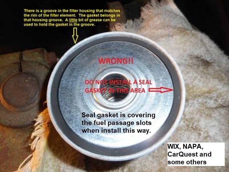

I will add pictures below of something you need to be aware of with that type of WIX fuel filter. You might have covered this however I am going to put it out just in case.

Hi Jim.ME, yes the new injectors are in and have not been disassembled. The fuel filter pictured above is the one that is installed on there now and the top gasket is in the correct place inside the groove on the filter head not the filter itself. I picked up some olives yesterday from a Massey dealer in Columbia, MS and will install those this morning. Once installed we will crack open the high pressure nuts on the injectors and see what happens. Multiple fingers crossed!!

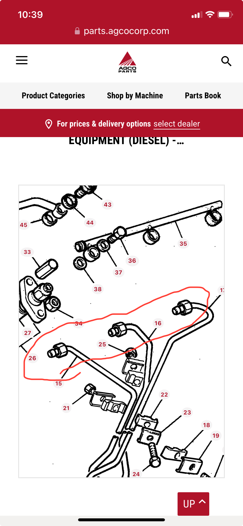

The olives have been replaced or installed where none were supposed to be. But I'm seeing that cracking the high pressure fuel line nuts will be almost impossible with the fuel tank in place. Any hints? Stubby open end wrench maybe???

These are difficult to access? Sorry I don’t know the exact configuration.

These are difficult to access? Sorry I don’t know the exact configuration. View attachment 109770
They are no fun to get at. I believe you posted your manual said to loosen 1 and 3, I expect those two will be the easiest to get to and just the two should do it. Angle head wrenches as used red MN suggested may work. Maybe a crow foot wrench. I have bent wrenches, but that is usually best done with a torch. This is why some people tow them around to spin them faster rather than fight with the injector lines.
Thanks gents!! Yes, they are a bear to get to with the tank installed and very little room to work the wrenches. Both options look viable. Heading to Harbor Freight in Hattiesburg now!!
