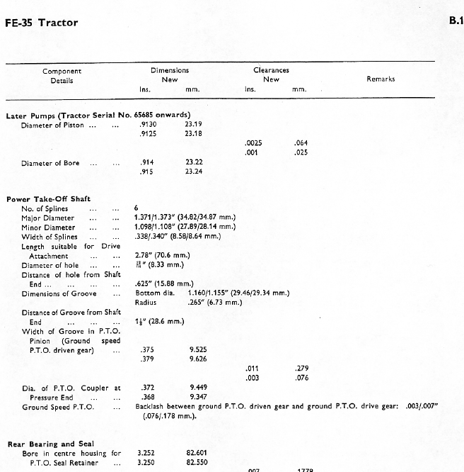

I am trying to find a clutch for my mf35 with Perkins diesel. All I can find has a 1-1/8 inch shaft and a 1-3/4 shaft. Mine has a 1-1/8 inch shaft and a 1-5/8 inch shaft. Has anyone had this problem before and can tell me where to find a clutch? Thanks in advance.

somethings a miss here. there is no 35 diesel with 1 5/8 pto disc. the parts catalog doesnt list one either.
there was a 10" fine splined orgainc disc on some of the 100 series but that is of no use oem ref. 1865836M91
Upvote 0
from origonal service manual

My mf35 has a 11 inch disc which I assume would be the PTO disc. It fits a 1-1/8 inch shaft with 10 splines. It has a 9 inch disc which I assume would be for the tractor. It fits a 1-5/8 inch shaft with 10 splines. All the clutches I can find have a 9 inch disc that fits a 1-3/4 inch shaft with 10 splines or either a 1-5/8 inch shaft with 25 splines. All the clutches have a 11 inch disc that fits a shaft 1-1/8 inch with 10 splines.

The 11" disc is your engine (traction) clutch disc that drives travel. The 9" disc is the PTO disc.
