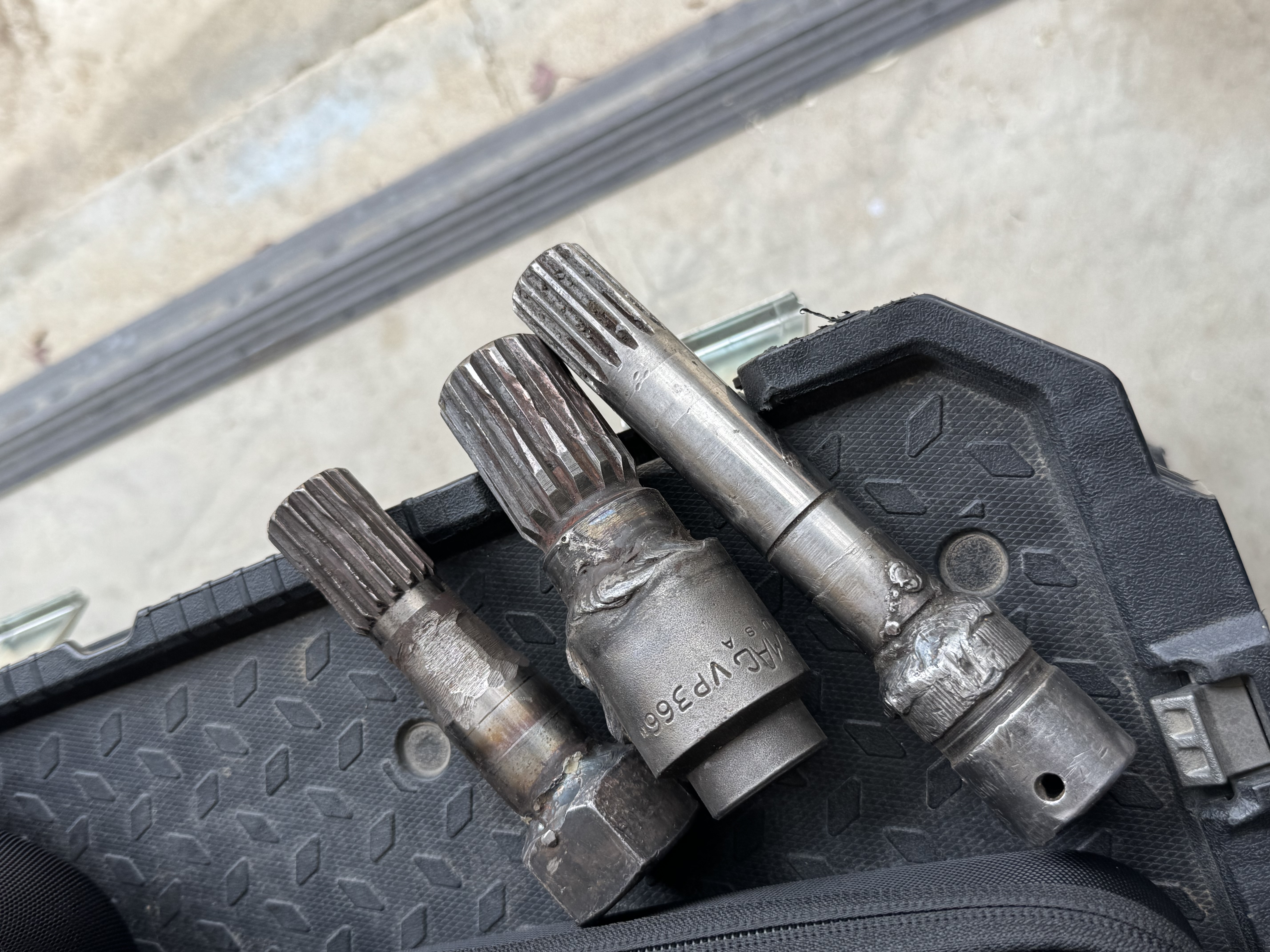

You seem to be very knowledgeable I was cleaning my driveway and lost reverse (instant reverse) thats why I might have to spit. I thank you very much for any info.

Looking at the 300A parts book it shows the Left-hand thread on the engine end of the shaft. The pump end appears splined.
Upvote 0
do you think it will be in issue to take apart?
Getting a hold on it to turn it may be the biggest problem. some have made splined adapters, with a hex nut on one end, to fit into the pump end of the shaft so they can use an impact wrench to break the shaft threads free.
You may have room enough to remove the 4 capscrews that hold the shaft drive adapter to the crank pulley. Then you could pull the shaft and adapter forward and secure them clear of the crank pulley to allow you to run the engine.

You don't have to remove loader to split it you support bucket with a good stand tall enough to roll front under a bit. Jack stands under loader frame wedges on front axle rolling jack and good bottle jack

Looks like a split cleaned changed fluid it was really nasty probably never changed clogged filter clogged screen I've seen cleaner mud puddles then the sludge that came out I let it drip for a week started it up forward no problem still no reverse it seems clutch or valve.
