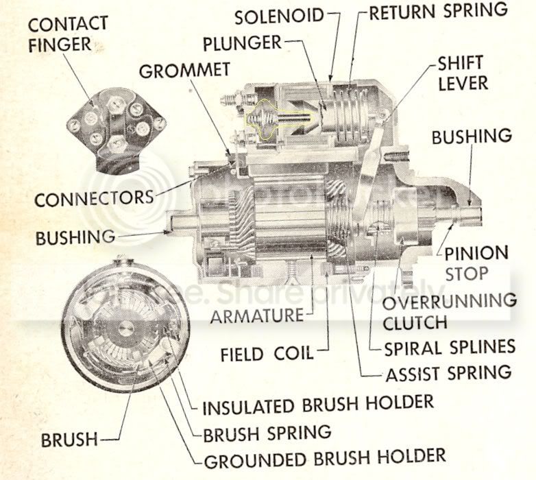

Solenoid could be sticking, thus maintaining contact. The parts circled in yellow (springs, plunger, copper washer), if stick in left most actuated position, will keep power applied to motor even after you remove power from the small terminal. Or even the main plunger could be sticking.
This is all based on the premise that "I suppose this could be marked up to not being solidly grounded at the point & the wiggly motion momentarily removes ground, starter stops & you interpret this as 'it works fine just laying on tractor'???".
Just saw your post to dell about 3 solenoid replacements. Are they replacing the whole solenoid assy? Note, it separates just right of the copper washer/spring that make up the contact portion. If they are replacing only the right portion (not yellow parts), that could be the problem.
