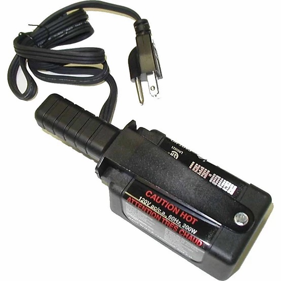

Or a magnetic block heater. I kept one on the hydraulic sump on the 8N so I'd have faster response on the back blade when plowing snow. I think I put another one on the intake manifold a few times when I knew I'd be plowing in bitter cold.
