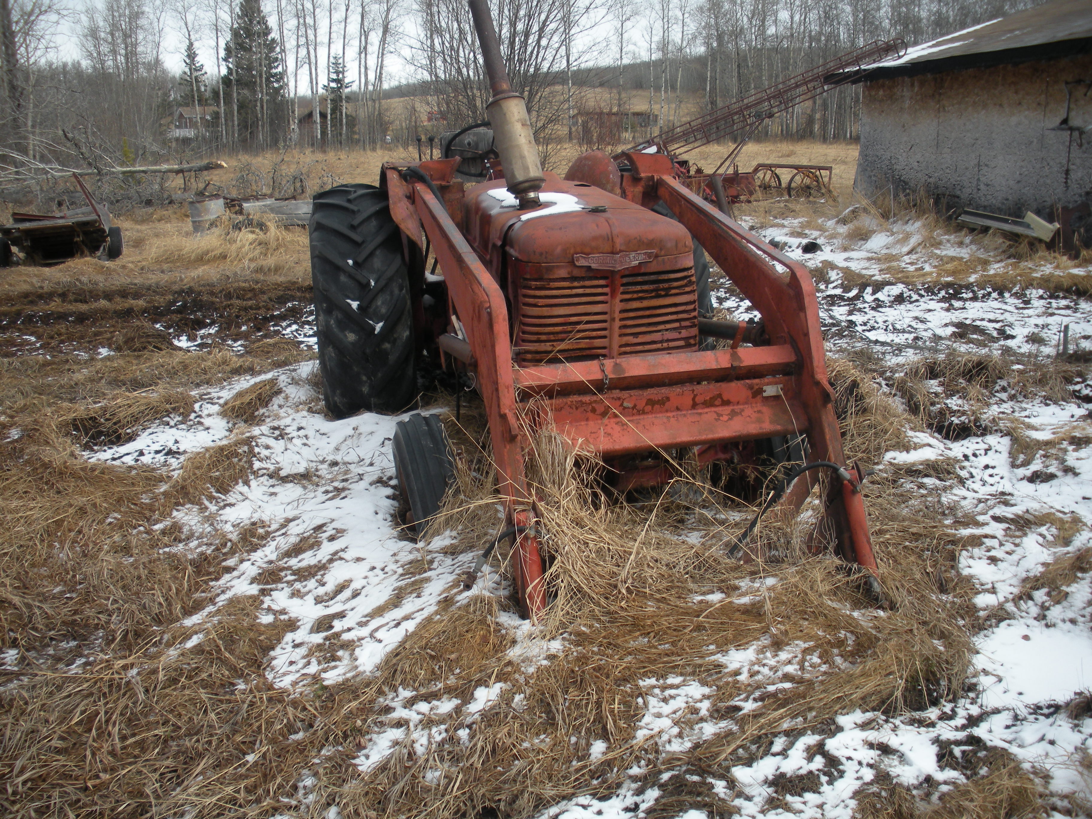

I've probably missed the boat on this one, but a Ford 3000 has caught my eye. Private seller, doesn't know tractors. I believe it belonged to their dad. Currently dead, would need to get it running to raise the loader and load it onto my trailer. My question: If it's not possible to repair it on-site, is there some way to raise the loader in order to winch the tractor onto the trailer? I haven't seen it in person, don't know the extent of what it needs or even if the motor is freed up. But this info may come in handy in the future. Thanks in advance, Gerrit
WD9........In this neck of the woods we call a specific style of Jack a "JACKALL". Once loader frame was off ground,placed a pipe in such a location....then winched Tractor onto trailer.

I would jack the loader up into a position having the bucket 12-18” off of the ground. And cut a couple pieces of 1 1/2” or 2” angle iron that would be long enough to place against the extended cylinder. And fasten the angle irons in place with gear clamps. Once you let the jack down, the weight of the loader and the gear clamps will hold the angle irons in place, making the tractor easy to load and unload, as well easy to roll into the shop to repair. And there will be very little risk of the loader falling and hurting anyone.
