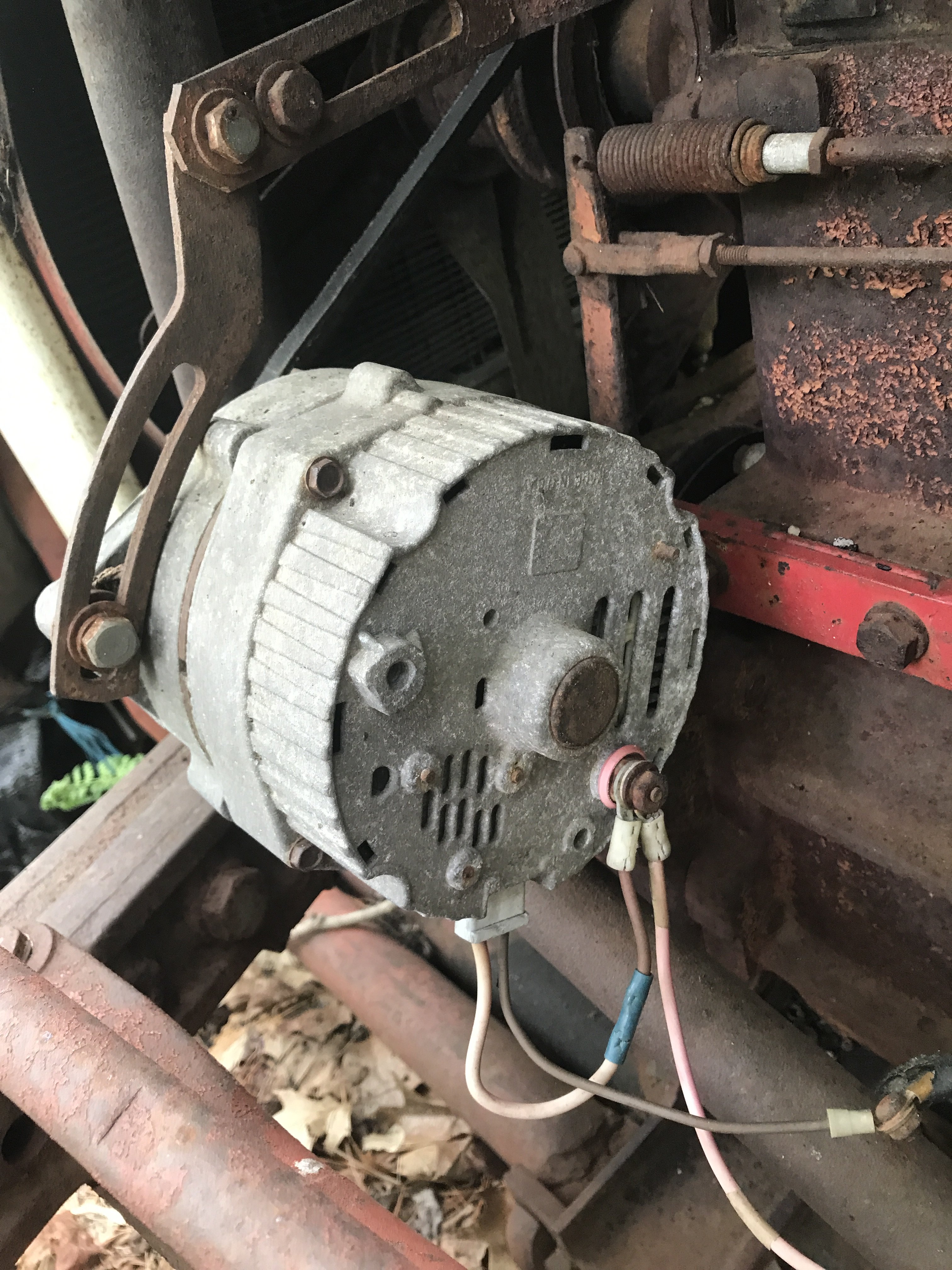

When I saw the after market bracket I assumed (again) that this was part of the conversion
Maybe not
Upvote 0
Maybe notView attachment 71450
Hello Pac-Man, welcome to YT! That is an alternator ((a Delco 10si to be exact), IT HAS TO HAVE THE BATTERY CONNECTED AS A “NEGATIVE GROUND” if you connect it backwards from this and it was installed correctly the alternator and maybe your wiring will be damaged. You will need a 12 volt battery. (Just FYI a 6 volt battery can be easily identified by it having 3 caps on top to check the electrolyte (fluid/acid)

Thanks for the great info on the alternator
Now I can move forward to find my problem
Yes I have a 12 volt battery and coil because that’s what I bought with out knowing for 100%
That’s what I needed, I assumed it was converted but as I struggled with no spark I started to question what I was doing

Hopefully you didn't hook the battery up + ground because if you did you smoked the alternator and that could be a big part of your problems since it could be a direct short to ground now

I would suggest disconnecting the alternator for now take the wires off circled in yellow and unplug the plug in the side. Tape up the wire eyes for now and tie or tape them out of the way. I see some farmerization circled in red you better tape that up as well. None of that wiring has anything to do with it having spark at the ignition and running. Unless as old suggested the alternator is shorting to ground, disconnecting it will eliminate that problem for now. All that wiring is for the alternator and charging the battery. Get it running first then we can help you figure out if the alternator or wiring for it was damaged.

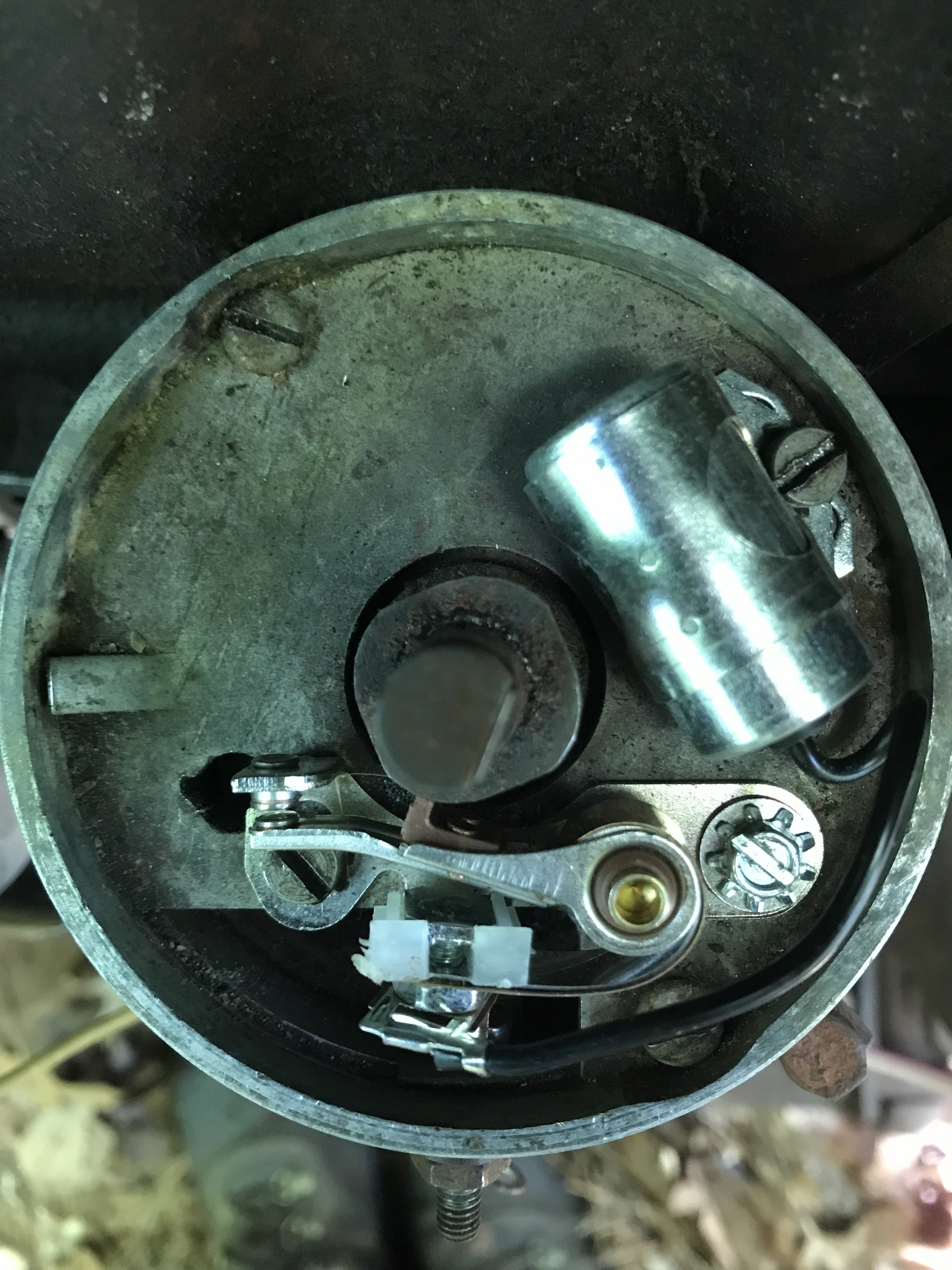

Thanks for all the comments
So to be clear
I never connected battery as negative ground
With a review of all comments I am now 100% convinced that the tractor has been converted to 12 volts and had run for years
Relatively successfully
This is what I found today
I have 12 volts to coil and 12 volts out of coil if wire is disconnected from distributor
Once I connect to distributor readings go wacky (even with points open)
Additional notes
I noticed that a check from the copper strip in distributor to ground revealed continuity
I was told about failing insulators on the screw thru distributor
So I disassembled and inspected
I didn’t see anything that looked odd
I reassembled and repeated above test with
Same results

Continuity with points open or closed?

Using a ohm meter on the condenser can be informative. It should show only a very brief pulse of conductivity, then nothing. if it shows continuous continuity it is bad. the copper strip could also be touching the flat washer under the non standard hold down screw! jIM

I disconnected the condenser and the continuity from distributor and copper post went away
It appears to me that the body of the condenser is shorting
Is this plausible?
Upvote 0
Is this plausible?
Check continuity between the condenser lead and the condenser metal body If there is continuity the condenser is bad(shorted internally) A simple explanation is that a condenser is constructed with two sheets of aluminum foil on opposite sides of a sheet of waxed paper, with another sheet of waxed paper on top. This is then rolled up into a cylinder, keeping the foil sheets electrically insolated from one another. One sheet is attached to the lead wire, while the other is touching the containment can. These sheets can become shorted between them, or at the connections. They can also fail from heat, moisture, or excess voltage that jumps the wax paper. (called a dielectric).
