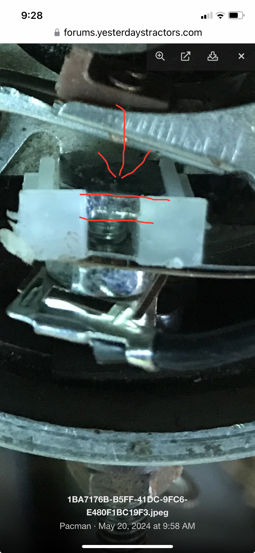

The metal "post" looks to be touching the spring and copper strip. A sure ground there! It must be insulated at that metal support. Jim

Metal post?? What do you mean, the breaker arm pivot post? I don’t see where that is touching?
Unless you mean the bent up tab of the contact plate that the terminal bolt sticks through. I am not that familiar with Ford points. The metal “tab” as I call it as shown between the two red lines and the head of the terminal bolt the arrow points to or any part of it for that matter CANNOT have contact with each other.

That tab is my "post" incorrect assembly there or a terminal end turned crooked could be a short to ground. Jim

Then why don’t you say “this is wrong with what you are telling him”? Everything I said about the the problem he is experiencing and what I am suggesting could be his problem as it pertains to the installation of the points contact set is a fact. The terminal cannot have continuity to ground if it also contacts the conductor strips from the points breaker arm and the condenser lead end.

Base of points is ground,
Spring, copper and lead side must be insulated from ground all along the way from coil

The spring cannot rub/spark, it is an issue to be fixed. The voltage pulses at the points mechanism can be 275 to 300 volts. enough to jump a small gap even. Jim

I posted today my story of finding a short in the area you are experiencing.
The bolt thru the distributor has to be insulated from the case of the distributor.
Mine had a crack in the insulator on the inside that was allowing a short circuit.
