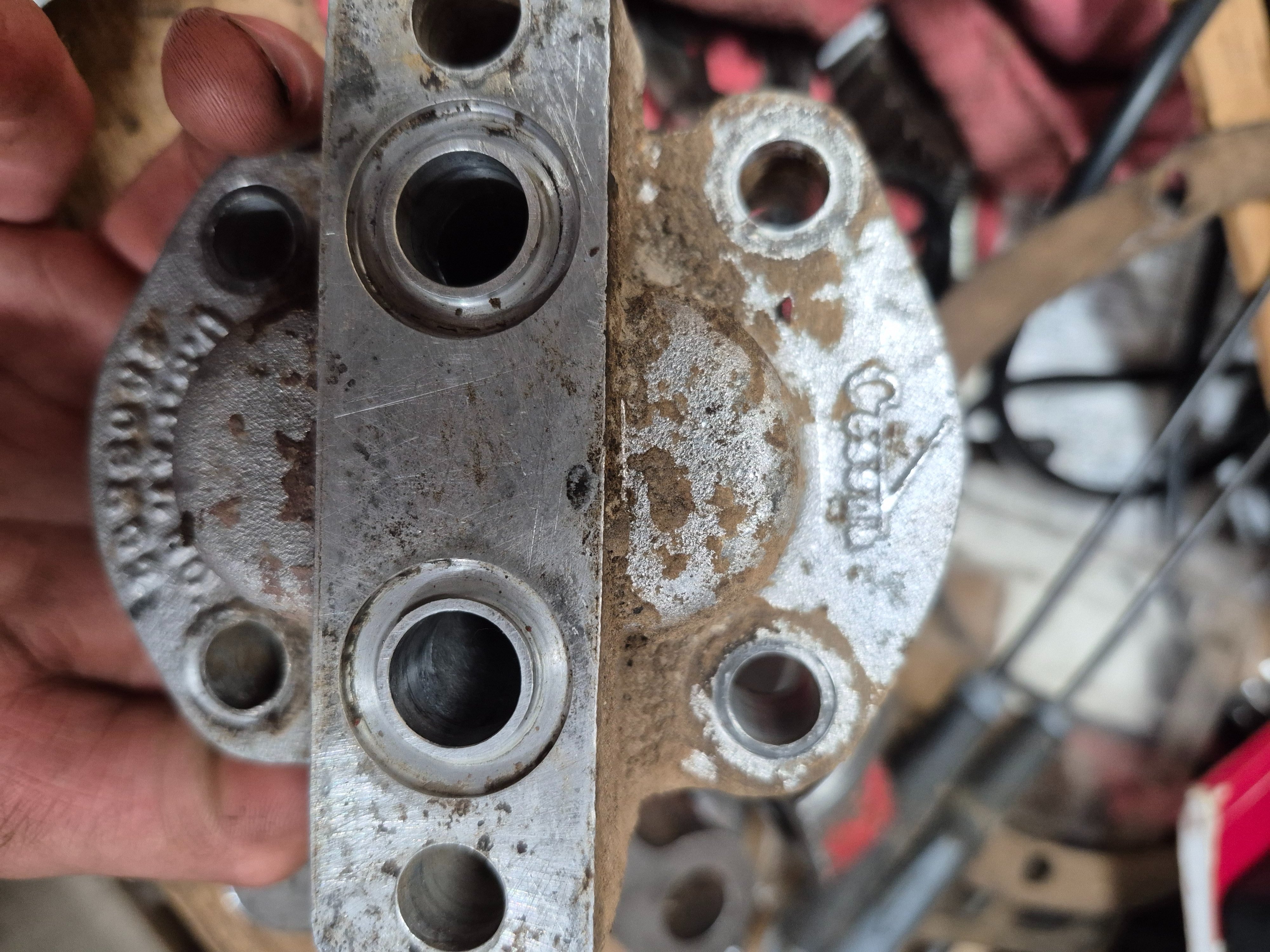

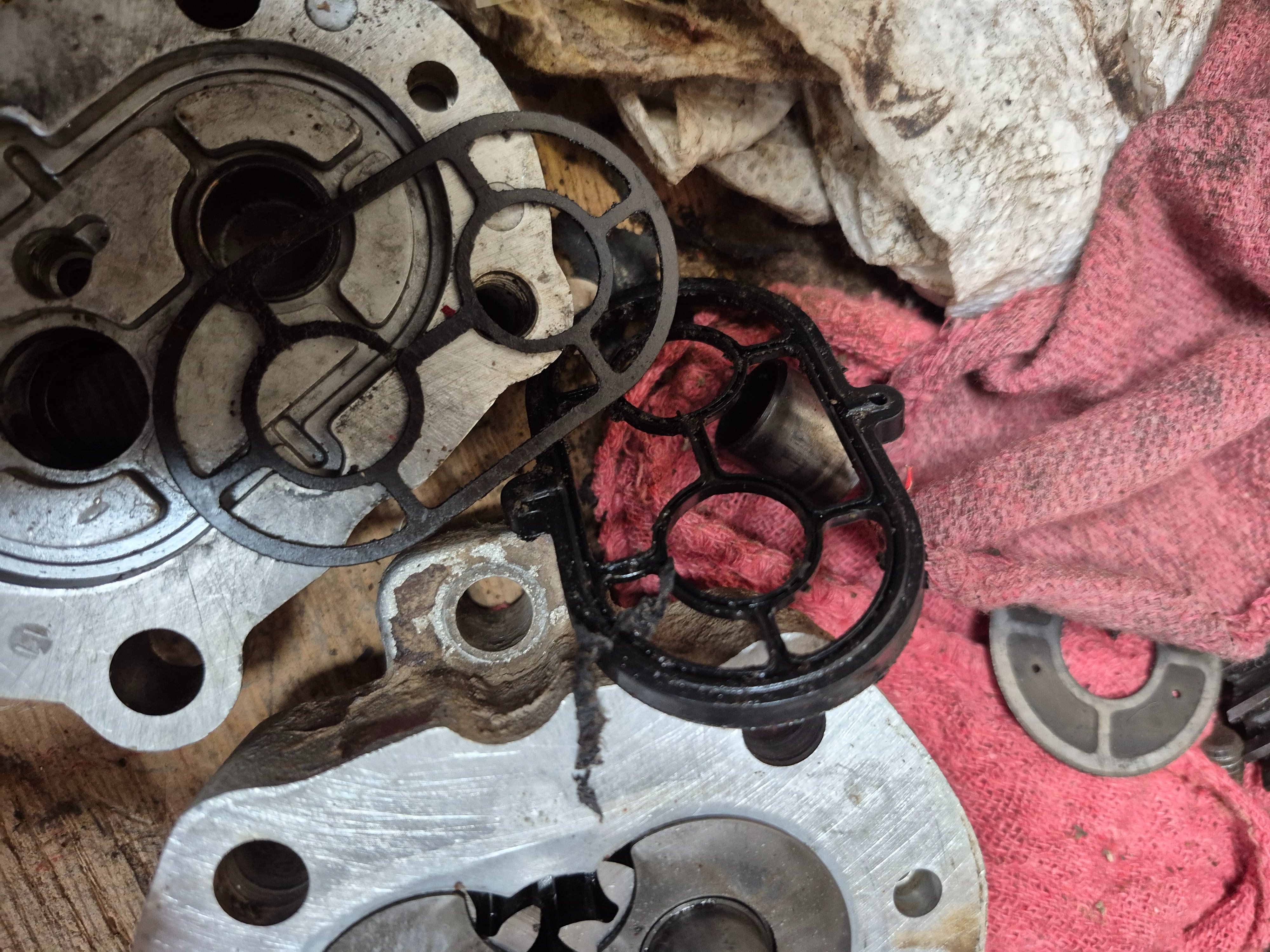

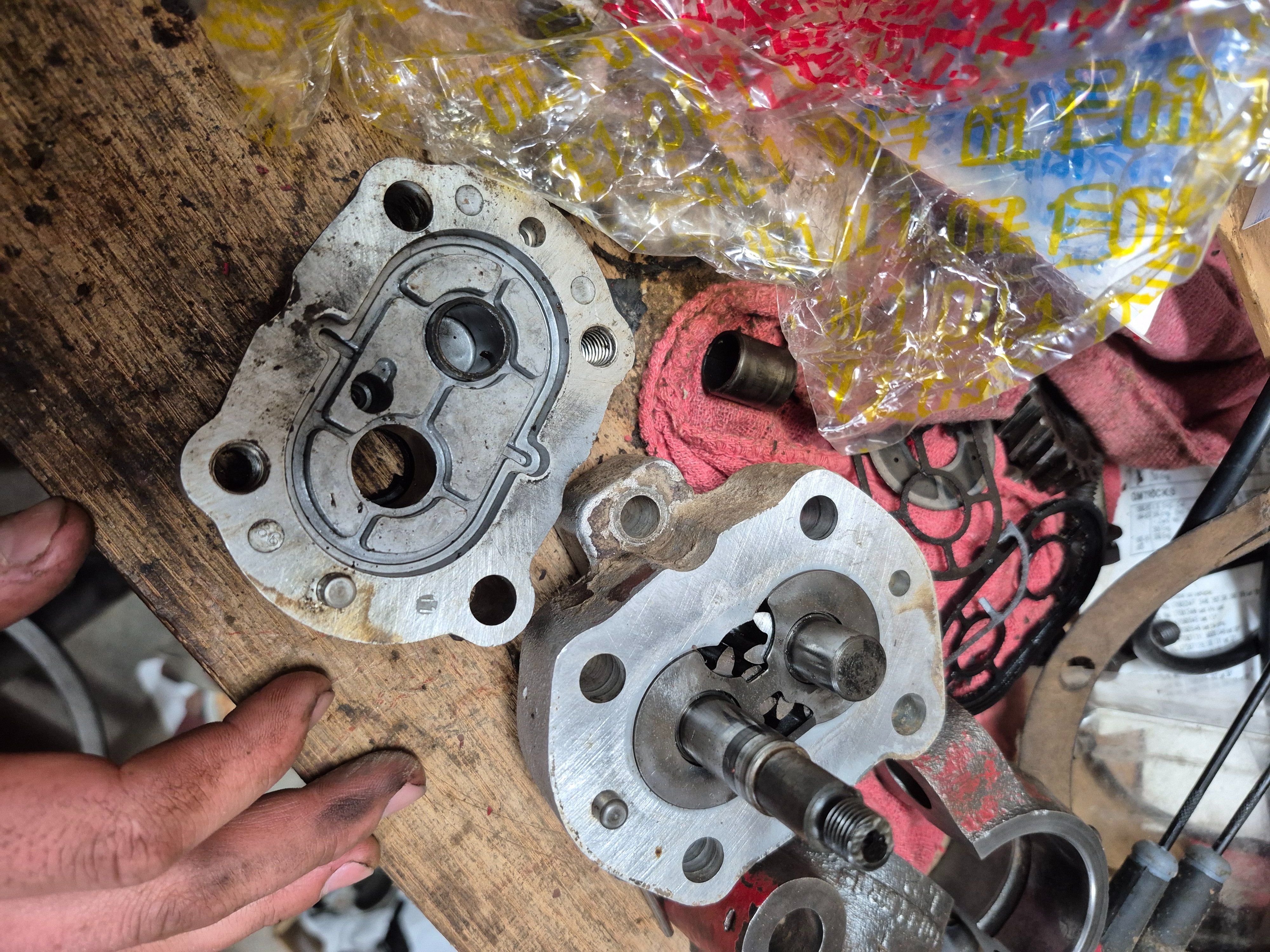

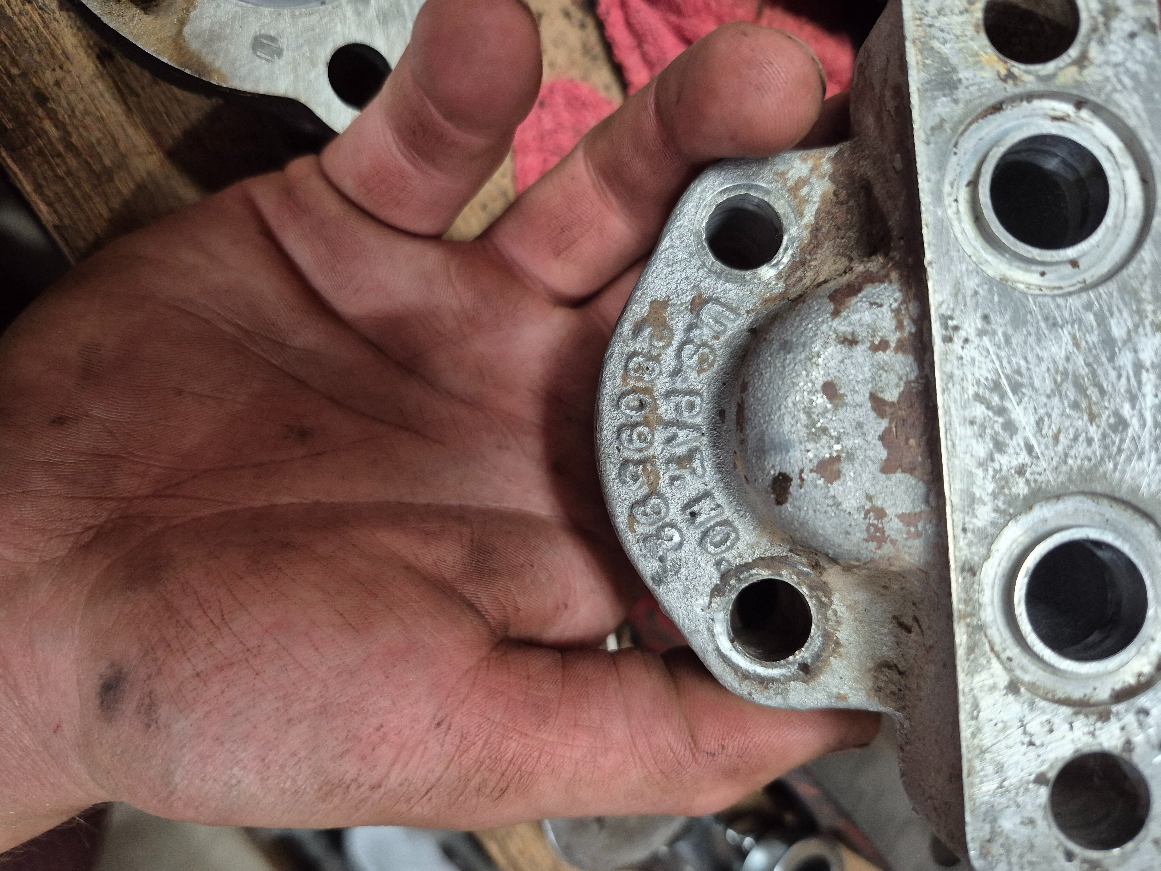

Need help finding a rebuild kit for this cessna pump. I saw this same pump on another Super C at a show recently, so either they didnt touch the unit or theres a kit out there for em. I read on another thread that these pumps had poured gaskets? Should I cut my losses and find a different pump or try and find a kit? Old gaskets were shot, thanks in advance.

The kit I ordered didnt work which sucks. Seems they have multiple different vein styles on these pumps. Tried ordering a different one through farmall parts dot com and they emailed me a few days later saying they dont make the kit anymore. I do have the JD style kit but its useless to me lol. Im probably going to bite the bullet and get a thompson.
Need help finding a rebuild kit for this cessna pump. I saw this same pump on another Super C at a show recently, so either they didnt touch the unit or theres a kit out there for em. I read on another thread that these pumps had poured gaskets? Should I cut my losses and find a different pump or try and find a kit? Old gaskets were shot, thanks in advance.View attachment 155370View attachment 155371View attachment 155373View attachment 155374l

Never even heard of them. I just poked around on their website, they dont have anything with pictures though. I did find from another website that this is a Cessna Series 24200 pump. Id have to make an account to order through that site though, and it ships from the UK.
There is an Agco kit for the Oliver Cessna pumps, I don't know if it's the same as the one you already have. 30-3142450 is the part #, take a look at this video and you'll see it in action:
