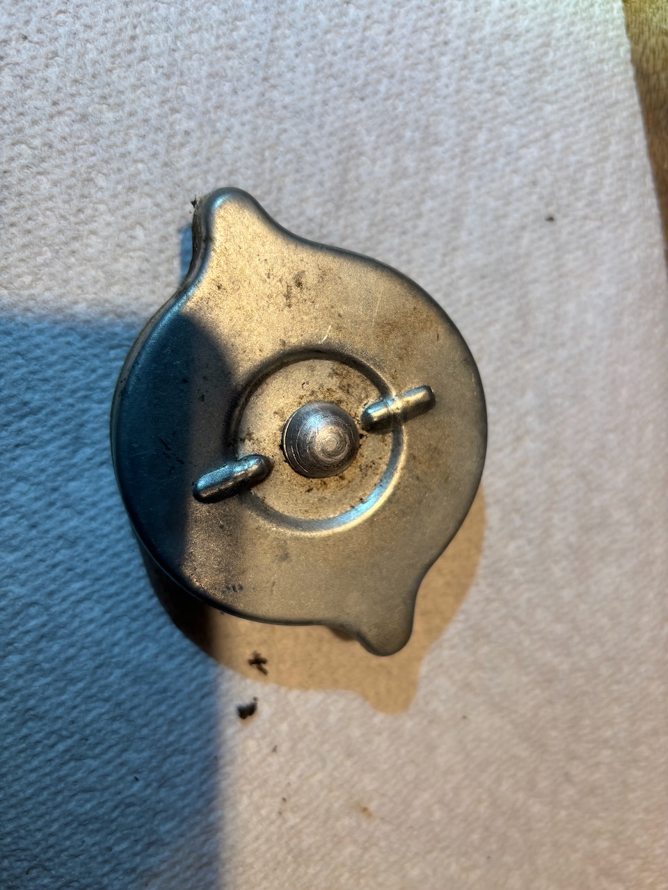

Is this a vented gas cap? It did make a “swoosh” sound when I opened it
Maybe, maybe not, to me the sound would indicate it wasn't vented. You can try sucking and blowing on the center and see if it passes air easily. Try running without the cap on or at least the cap loose and see if it stays running. Or just buy a new vented cap and know what you have.

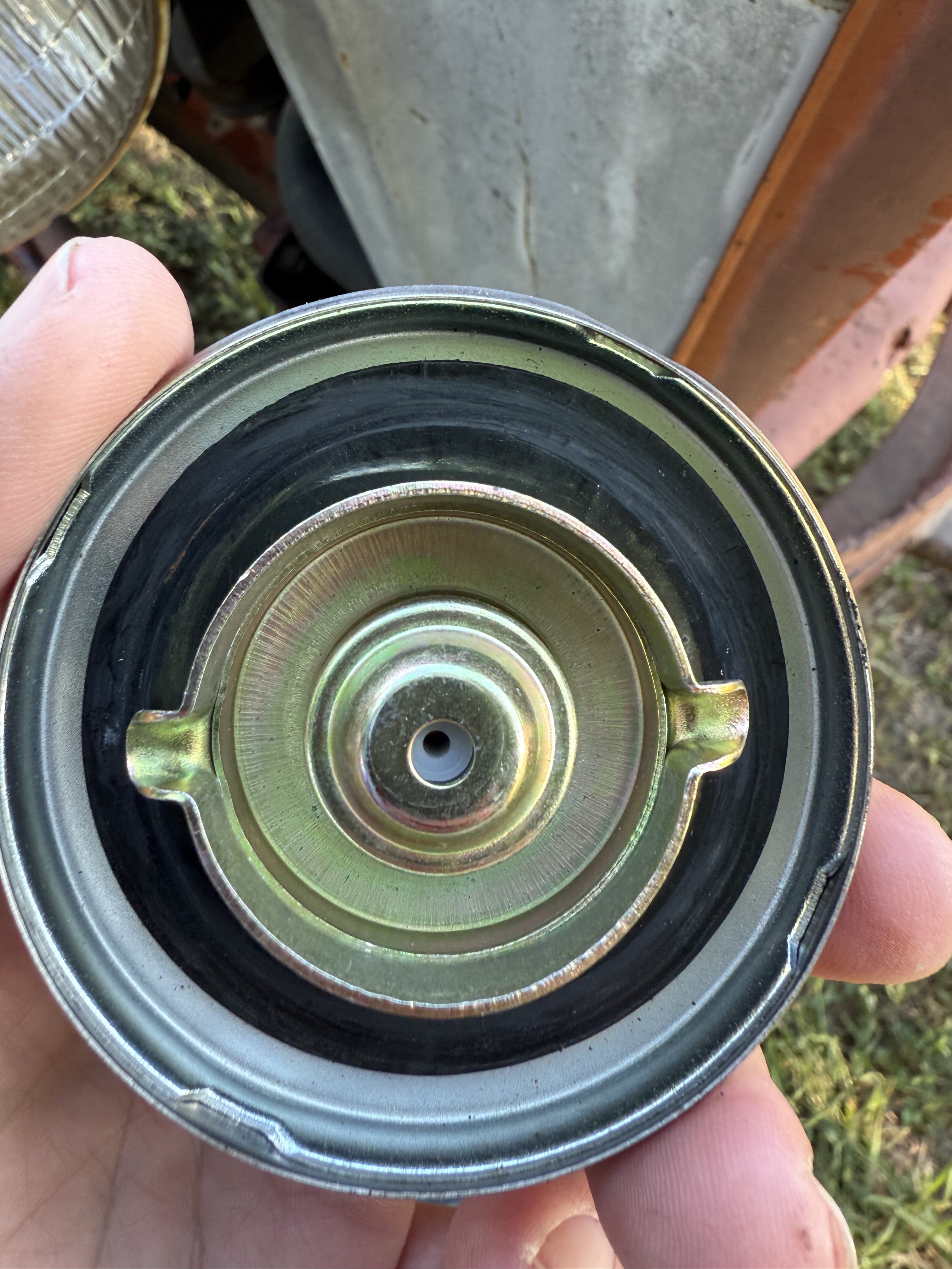

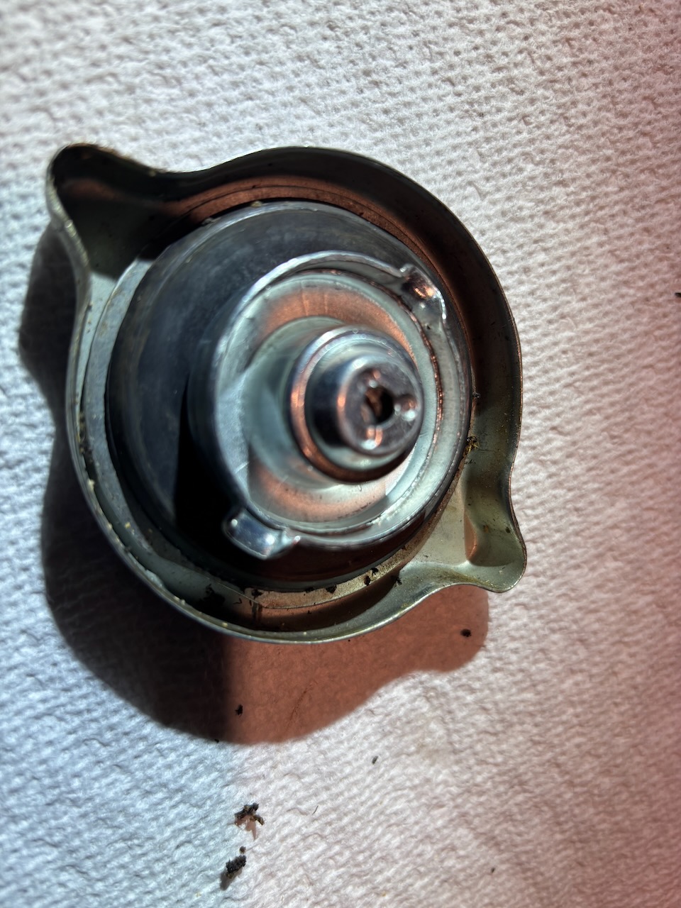

Here's the gas cap in question. Staked orifice in the center has a captive disc that rattles when shaken, looks like it ought to vent but evidently does not have a connection to the atmosphere. It was purchased for a TO-30 Ferguson, I think some Fords use the same cap.
No sign of country of manufacture, but we could speculate....
