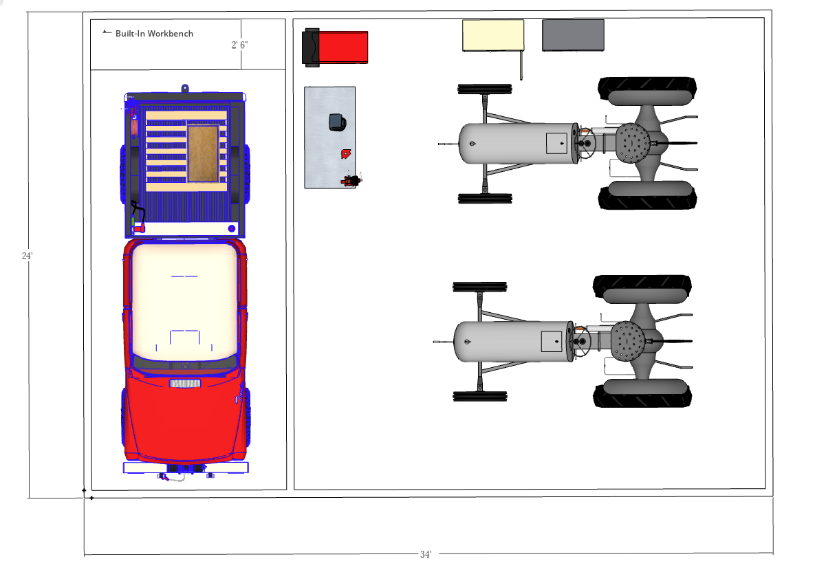

area for a computer desk/office to look up parts, keep up with projects, and edit videos for my YouTube channel.
Friend of mine used an old/free upright freezer, added wood pullout shelves better light(s) and outlets inside.
Then filled it with his shop computer, printer, modem, office paper etc. 99% of the time the door was closed, keeping dust, dirt and overspray out.
Plus he could relocate his "portable" office if needed.
Now days a big french door style freezer or fridge would maybe be nicer.
Single car garage, by the time you put in workbenches and tool boxes and any floor standing power tool, you won't have enough room to turn around. Ask me how I know this! I would suggesr a small office, 8x8 or 8x10. Just enough room for a desk, comfortable chair, file cabinets,a couple more chairs for visitors and maybe a small fridge. Put workbench on the same side as the office to the end of the building, leave room for air compressor against the wall in the corner. Add welder outlets along the wall, put wheels on your welder so you can move it where you need it instead of leads strung all over the floor. If you can afford to go higher, build a loft over the office and work benches for storage to keep your floor space open.

Not sure of your location, but insulating beneath the concrete and installing PEX for future floor heat should be considered if you live far enough north. Hooking that up to off peak electric boilers usually will pay back the cost of installation in a reasonable amount of time. Doing that prep work will add some cost right now, but it is not excessive, the big money is in the boiler and accessories.
For everything your wanting to do in there. That's not big enough. By the time you get tool boxes and cabinets and workbenches in there you won't have room to work around any projects. Just my opinion. FWIW
The shop is a gift to me and was told to make the size I want - that is the size I was comfortable asking for and also the max size I could build in the location chosen given other objects/structures around it.
Go to office supply and get a tablet of 1/4 or 1/2 scale grid paper. Then you can easily draw whatever you want with a ruler. Like she said, it's never big enough.
I am currently working on a sketch using the free online sketchup tool.

These replies with suggestions really is awesome! Just what I was looking for.....everybody giving suggestions and brainstorming. Here is a quick sketch I am working on now and not finished with. The size of the building can't change unfortunately. I'm noticing that as I lay things out, it is filling up fast; so space saving and storage ideas are a priority. I have a 1974 3/4 ton IH 200 pickup LWB that I mocked up as worst case to see if it could be parked in there at some point. Most likely use that garage space for small projects and "clean" area workbench work but will have a garage door so space is multi-use. No designation for office/desk yet.

Prep is gonna be crushed stone and plastic with rebar reinforcement. Yes he said he is building a pole shed with 2x4 framing.
Use sticky notes cut into the shapes. that way you can lay it upside down on your printer/scanner.
Played around with the Sketchup Program and figure it out good enough. Check out the post at the bottom...
LOL, I was just about to ask you which program you used.
Good to know, thanks.
It looks impressive with what actually looks like an 1960's IH pickup and Ford tractors.
