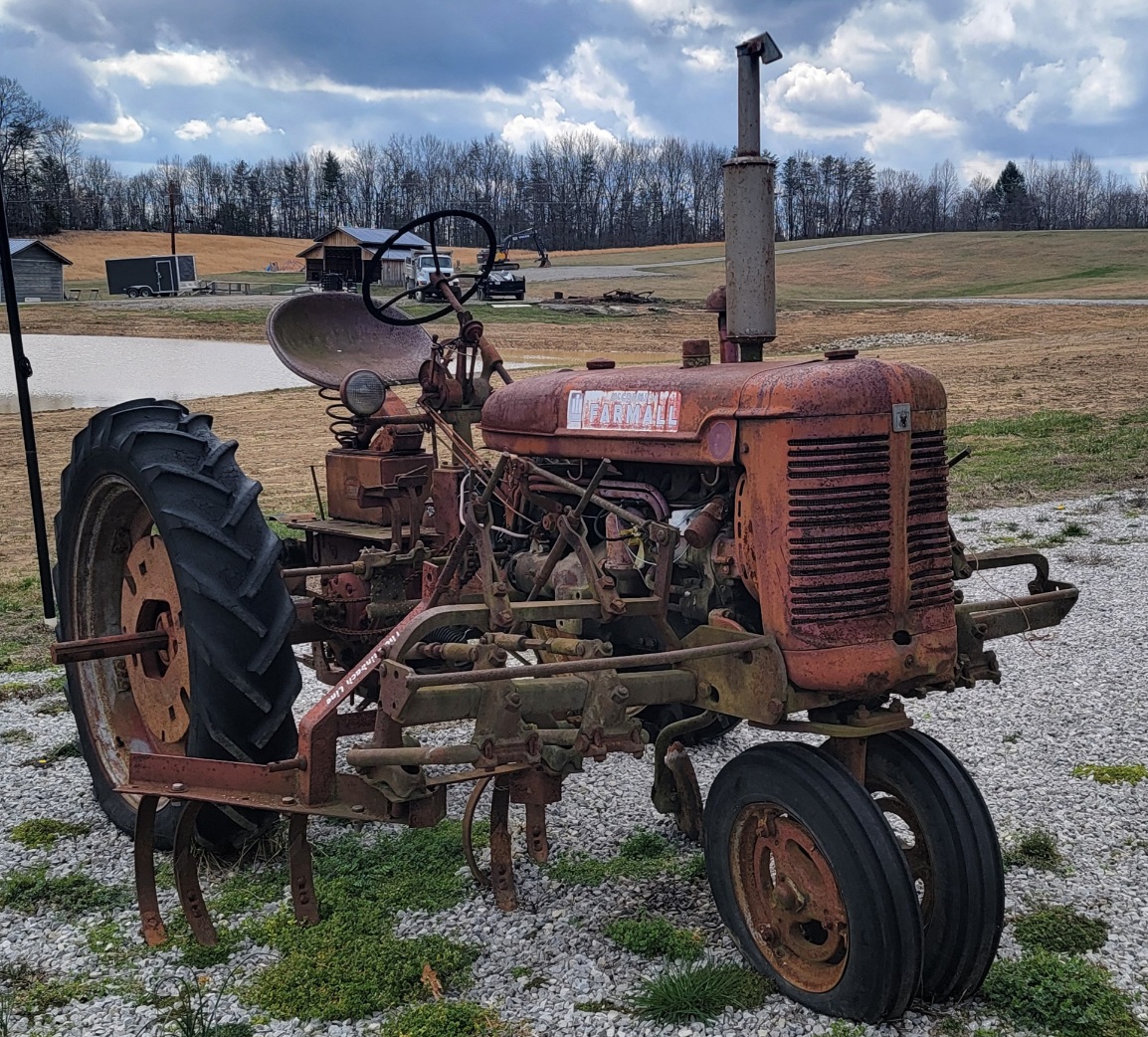

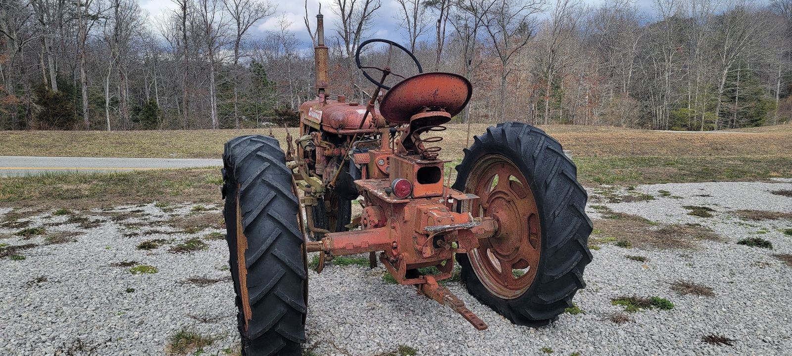

I'm new to tractors and have never taken on a large restoration. I've restored small things and have turned wrenches on different types of machines; cars, motorcycles, an occasional dozer, and manufacturing machines. I worked for Toyota building their cars in KY and now I do leather work.
Now I'm looking at taking on the challenge of a Super C that's on our property still owned by the previous land owner (he's 84) and he used it to work on the property. His daughter wants me to restore it and is willing to pay me for the work but I'm reluctant on taking that offer because I like to do things to my best. I think the cost to restore would be beyond the value so I would rather take ownership of the tractor then if she wants to buy it back for my costs and labor I would be willing to do that but other than that I wont be reselling the tractor.
So, with all that out of the way I know nearly nothing about old tractors. I've always admired these machine and the parts they played in building our country and putting food on the tables of Americans.
I'd like your feedback and advice about what I'm getting into. I made an album with various pictures and I'll post a few here.

The condition it is in is rather tragic in that the tires are all going to need to be replaced. With mounting and the tires, the rears will be in the $1000.oo range for least expensive brand, the fronts maybe 250. The next issue is if the engine is locked up from sitting in the weather. (The rain cap on the exhaust is good, but far from ideal). A stuck engine will be either an easy fix for time and $150.00 materials, or another $1000 for an engine kit and materials to rebuild it. plus labor at your rate??? The metal is there, but the grill is crushed. A new reproduction or good used might be ok and would be time consuming, or expensive. Paint can be expensive or rattle can, so that is not figured in here.
Was it fully drained before exposure to weather, or antifreeze, or is the block cracked? A good running Super C is less than 2000 because there were thousands made and are still out there. So with that info you can see that she is likely into $4500.00 to 5000.00 to see it as it kinda was!!! Jim

nice tractor , the way it is. Just get it to run .
take the plugs out shoot some mystery oil into the cylinders . Turn it over with the plug s let it soak awhile ,no rush . Get back to us

About all I see here is downsides. The tractor itself looks like a major hack job. The alternator appears to have no brace to hold the belt adjustment. The battery is whatever oversized one could be partly installed. The ignition appears to have had the distributor replaced with a magneto that has in turn been converted with an external coil that is just hanging there. The cultivator almost defies description. And if it was driven there and parked 5 years ago, it about had to be done on a flat rear tire. They don't get that bad in 5 years of sitting. The bottom line suggests not much pride of ownership or machine care on the part of the owner.

you have over 2k in new tires for it. do the mechanical , get it running good , straighten the grill up and thats good. wash it down oil up the paint and u be surpriced how good it willl look. why is everyone worried about painting a tractor. its not the paint that makes a tractor. i have a saying... a cheap paint job is like lipstck on a pig. original is always worth more money to a serious collector. its the beginners that spoil a tractor for them. so if you have 2500 or so in your pockets you can make it into a nice little tractor if its not seized up. tires are the killer.
Off to a nice addition with the cultivators on it . Got hillers also . Does he have the rear mounts Cultivators?
forgot To mention ,does he remember where the carburetor went For it ?

I was talking about the tractor in the pictures the original poster showed us. What tractor are you looking at?
i am looking at the same tractor... u made the comment that its already been repainted. well i did not say it wasnt repainted. i gave a generalized quote that people are more interested in painting than mechanical .
Okay. I was genuinely confused by your comment. "This tractor was not painted" clearly does not describe the tractor in the pictures. Your generalized statement is valid, but doesn't apply to this tractor as it already has been repainted. The "original" ship pulled up anchor and sailed a long time ago.
