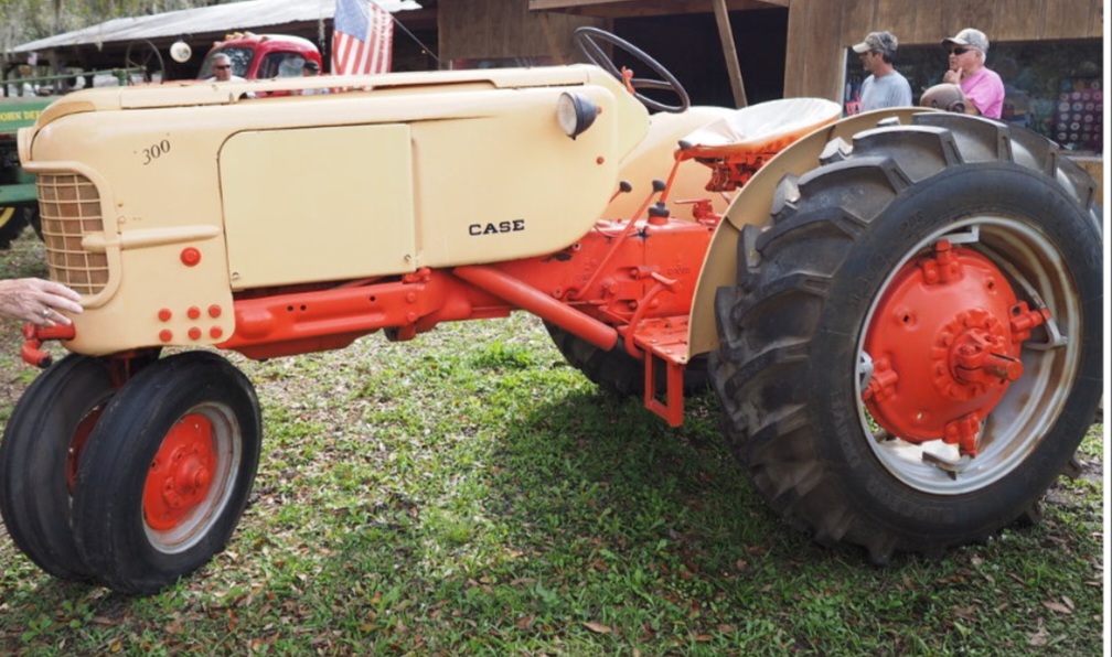

The Case 300 is the tractor you describe, they are so good I have three of them. Power for a 2-16 plow, 6 foot disc, and a 5 ft bush hog. They have 12 speeds forward and three reverses, with road speed up to 22 mph. In addition to the foot clutch, it has a hand clutch witch makes it have live PTO, important for a bush hogging.The three point has the Eagle hitch which works like a quick hitch and allows you to hook up the lift arms while on the tractor. The hydraulics stay where you set them and can be incrementaly moved with out creeping. For your price range you can find a restored one that is top notch.

Good luck to the newbie finding a 300.
Tractor Data says less than 300 ever built. I’ve got a picture of one in my shop and nobody so far has ever seen one at a show or anywhere in or around Texas. You should send Tractor Data your pic because the only one they show is not very flattering. I would love to have one just because it’s rare.

Actually It should be called the 300 series. The 300 was the industrial version and yes 300 made. The 311 was the ag version and 3000 of those made i think. There are no 311 decals. All are 300. Then there was the 311b, same tractor different sheet metal,
Amending my own post. There were about 8900 311s made. and the 300 was really called the utility model, there was an industrial version and it is even more heavy built than the utility.

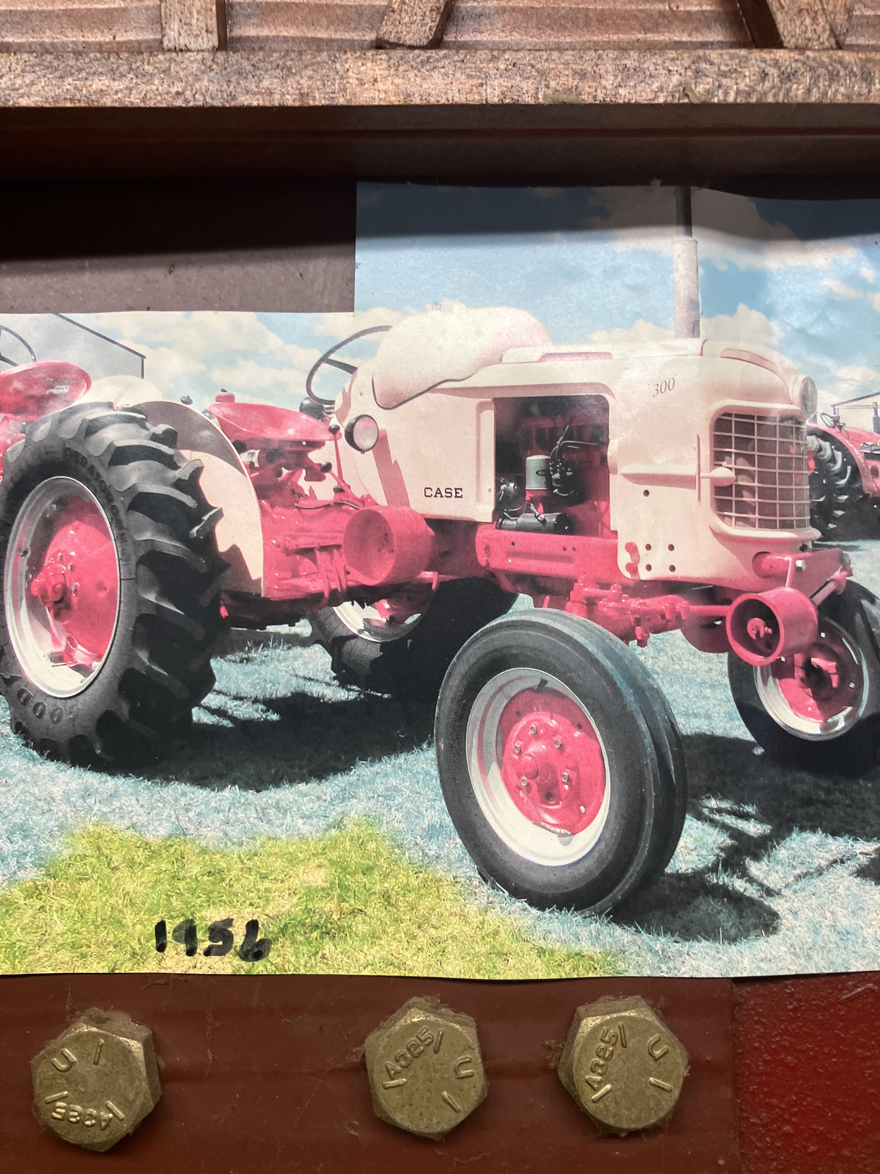

This is the only picture of one that I have, Hanging in my shop. Like I said of all my visitors who look at that picture, nobody has ever seen one. Of course Case dealerships were few and far between in North Central Texas.

Almost non existant here in Ohio

I am 81 now and never knew of any Case dealers untill long after Case was no longer. Then I head of a few no longer in extiance dealers. And as I was growing up if you heard the name case that part was preceded by the word basket.
