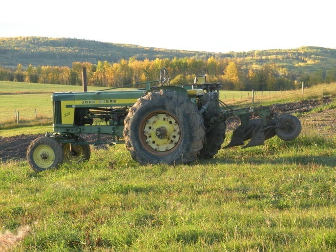

I'm very pleased with my John Deere 520,Live PTO (Independent clutch from Transmission) with 18.4 X 30 Rubber,and my 1963 MF 35 X 3 cylinder Perkins Diesel,Differential rear lock,no multipower 6 speed,H/L Range selector that my parents purchased new.
My Ford 2-N is used for the only thing I find it good for...cutting the Grass in the cemetery. The Three speed Transmission is perfect for the John Deere Groomer.
The 2-N is used for nothing else.
I believe if a person cannot afford the service manual,parts catalogue,operators manual,they should not purchase or own a Tractor.
In a totally different HP range,I am totally satisfied with my Case 830 Comfort King,8 speed manual transmission and equipped with an load loader.
