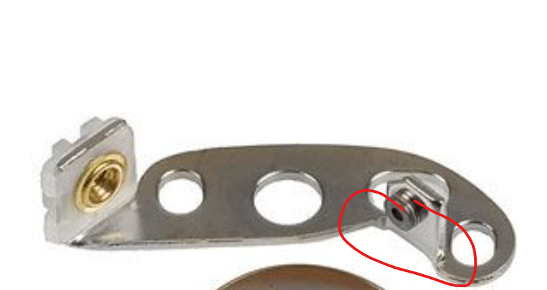

Newly installed points do not close
The problems with points/distributor on the Ford N series seem to be endless, so bear with me if this issue has been addressed. I could not find anything.
My 2N is used for bush hogging. It was time for that job. However, the little sweetie wouldn't start...no spark. It has been idle since June this year. I was surprised with the no spark because it has run without problems for a while now...at least 1 1/2 years. My first thought was the distributor and coil. I purchase the whole shebangy and installed the points today. The old points didn't look bad but bad enough, I guess. ( The distributor is off the tractor...it is a 6V front mount distributor, by the way.) After installing the new points, I was having trouble getting the 0.015 gap set. It just wasn't cooperating. I finally got them set but in turning the tang, it just didn't seem right and worse still, the points were not fully closing! They would not touch regardless of what I tried with the adjustment screw.
When putting those points on, I noticed that it was really hard to get the half of the point set closest to the cam fully seated. I had to use quite a bit of pressure to get them down far enough so that both sides of the points would mate. I'm wondering if that post fit is so tight that those points won't easily move? I think I read somewhere that the distributor itself could be worn out although as I look at it, I'm not sure what I should notice. There is no wobble and the cams are easily visible. For a 1944 tractor, it's remarkable that it will run...once I get this issue fixed.
I have used the multimeter to verify all the continuity, etc., it's just that the points will not fully close. Any help or suggestion would be greatly appreciated. I do not know how to continue.

Classic example of what passes for "replacement" contact sets these days. NOBODY makes good, quality ignition parts any more. Some are better than others, but none are high quality. I suspect if you look closely at both this set and the old set you will see these are shaped differently somehow somewhere. Could be as simple as the rubbing block is too long and needs to have a little shaved off.

Where did you buy the points from?? Good chance you have a set of points made in the land of almost right. I'd go to O'Reilly's or Napa and get new points

Even the last set of Napa points I got for an N weren't perfect and had the same problem. The problem is how the steel is bent/formed at the factory (the bend circled in red in the picture below): Half the points for N's these days have this bend not quite square enough, with too large of a bend radius, or bent not quite at the correct angle to the base steel (they're still bent up 90 degrees, but facing a slightly incorrect angle). Usually you can make them workable by holding in a vice and prying/bending, and hammering with a flat-head screwdriver tip in the corner of the bend to make a more square bend. But best to just take a look at the points in the kit before you buy them - once you know what you're looking for you can spot bad sets pretty easily.

In a pinch carefully dressing an old set of points so a feeler gauge so they will set flat when gapping, then setting timing with a meter will get you running OK in most cases for a while.

If you get back to this show us a photo of what is happening as to why the points won’t close.
Are the screws hitting the ends of the adjustment slot before the points can be closed?
I seem to remember this happening and was posted about here, maybe a couple years ago. If I am remembering correctly a couple members said they had filed, the slots longer to get more adjustment travel. Anyone else remember that, or am I imagining this?
You're correct - there have been a few of those same discussions on here regarding slot length. In my experience, the slot length seeming to be too short is more of a symptom rather than the cause, with the main cause being the arm bent up at the wrong spot. n the bad sets I've seen, you can see where the tab was supposed to be bent up, with the actual bend being slightly out of place. Either they're not setting it right in their bending die at the factory, or they're just mass-producing them with someone and a set of pliers quickly grabbing and bending them up, and not always being too accurate about it (probably because they're trying to produce them so fast).
Update on points and no spark. There is definitely a poor manufacture in these parts. It was quite a task to remove them even though I suspected that would happen since it was hard to get them seated. I contacted the Ag Parts that sold them and they suggested a return request which I have done.
Meanwhile, I re-installed the old points after giving them a little "touch up"...everything else was new...coil, distributor cap and gasket, rotor, condenser. Still no spark. I was almost ready to give up...almost...you can't get a good woman down! So, I looked at the wiring diagram in the repair book and was reminded about the starter switch interlock to prevent starting while in gear. In attempts to start all this time, I had depressed the clutch and wiggled the gear shift. It reacted as though it was in neutral. But, after seeing the interlock, I moved the gear shift to 2nd gear and then 3rd gear...click,,,I heard it. Even though it seemed the tractor was in neutral, apparently, it was not. The moment I hit the starter button, my little sweetie fired right up!
So, that's the story. Yes, the new points were awful but beyond that, it was the switch interlock. I never would've guessed it. Thanks for all the help and suggestions. I'm still surprised at the "hidden" problem. Never again; I'll always put it into and out of gear prior to hitting that button.
