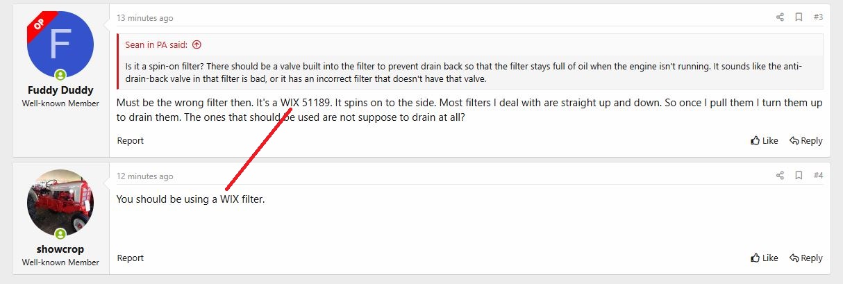

My 861 runs good. Show around 40 pounds of oil pressure. Burns a little oil. But not much. Starter went out. Ordered a replacement. Got delayed in the mail. That seems pretty common these days. So it been sitting for over a month by the time the starter came in. Went out there to pull the old one. Course you have to remove the oil filter to get it out. I put a little tub under it to catch the oil run out from pulling the filter. But I was surprised. None came out. Once off I put it up side down in the tub as you would to drain it. Not a drop of oil came out. Looking inside the filter you could see it had had some oil in it at one time. Once I got the starter back on I cranked it up without the filter on for just a second. Shot out a good stream of oil. So what's going on?

Must be the wrong filter then. It's a WIX 51189. It spins on to the side. Most filters I deal with are straight up and down. So once I pull them I turn them up to drain them. The ones that should be used are not suppose to drain at all?
You should be using a WIX filter.
Wix 51189 is the stubby filter used on some Ford tractor applications and the WIX specs say it has an anti-drain back valve. The valve may not be holding and slowly allowing it to drain over an extended time of non-use.

I have seen filters with anti-drain valves drain down over time. It may not be perfect, but I don't think it is unusual. That short filter won't hold a quart.

They should drain when you remove them. They shouldn't drain back into the engine when the engine is turned off while they are installed.
It seams the filter would also need an anti-siphon valve.
3 ways for a horizontal filter to be dry.
The anti drain back valve is bad or missing
The anti siphon valve is bad or missing.
The bypass valve was activated and the oil is bypassing the filter.
Then again a small seepage from the valves would manifest itself over a month from sitting that would be no problem for a motor used more often.
