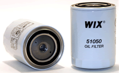

With that said, both of the custom filter adapters for the N’s do include orifices. They include necked down regions which are 3/16” in diameter. Since these do not have any smaller cross sectional flow area than any other portion of the bypass filtration system on these engines, they really do no harm and are more to address the “myth” that a restrictor is needed in the N system than anything else.
With all that said, there are some nice benefits to the spin on adapter. In addition to the convenience of being able to buy filters at virtually any filter retailer (Walmart, Target, Farm and Fleet, etc), they make for a very nice reasonably mess free oil change. Probably the largest reason, however, is the fact you now have options in terms of the filtration you put on your engine. You can select a make of filter which provides far superior filtration to the original filter. If you look up the specs of the original filter, it has a 32 micron rating. Now take a Fram extra guard which has a 94% multipass test score and a 10 micron rating. 32 micron to 10 micron is huge. Add on the fact that you can now install a filter with more filtration media (remember that filtration efficiency is related to the face velocity of the oil through the media – the more media, the lower the velocity and the better the efficiency) and a spin on adapter will take your N to a whole new level of filtration.
