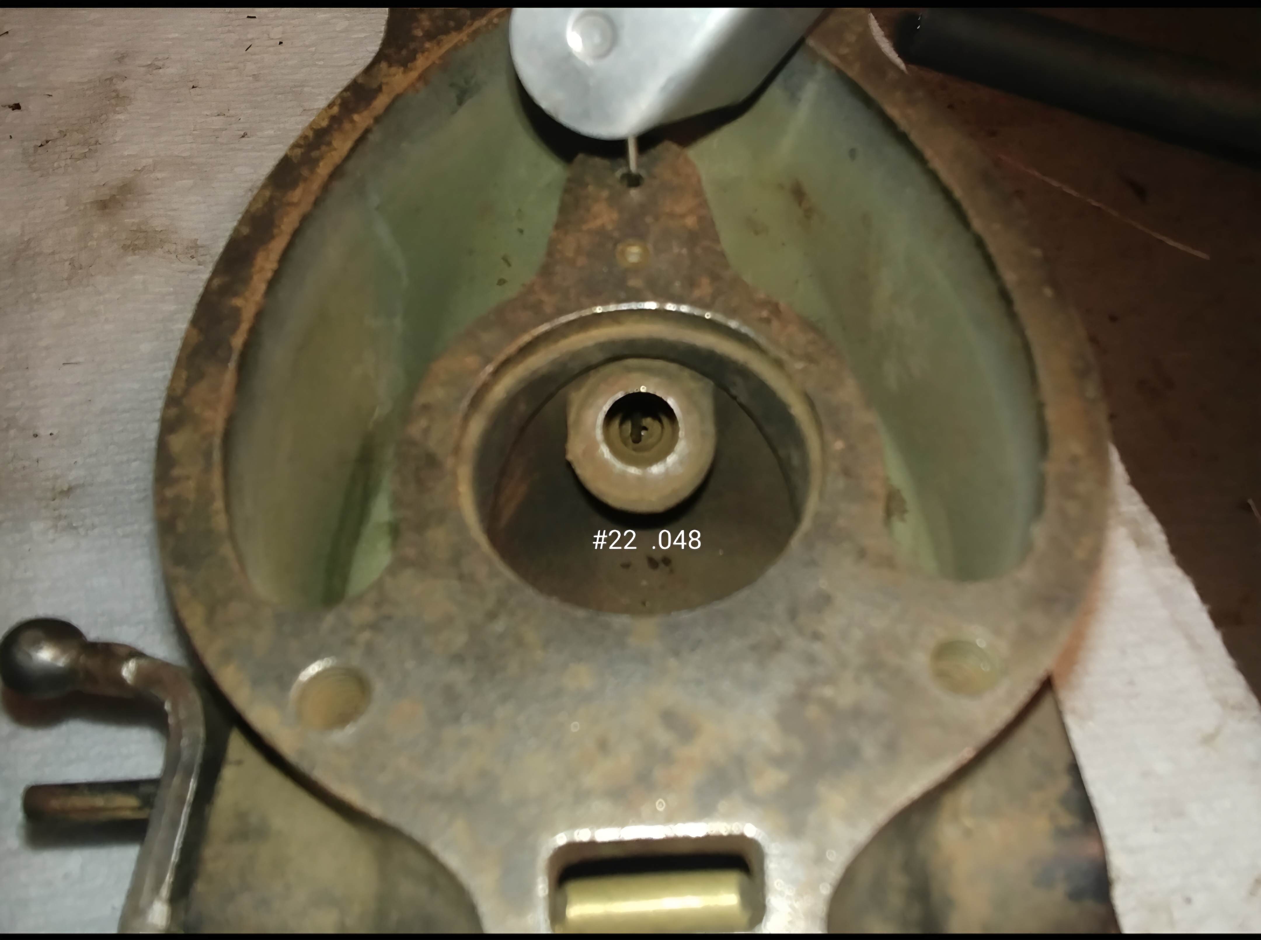

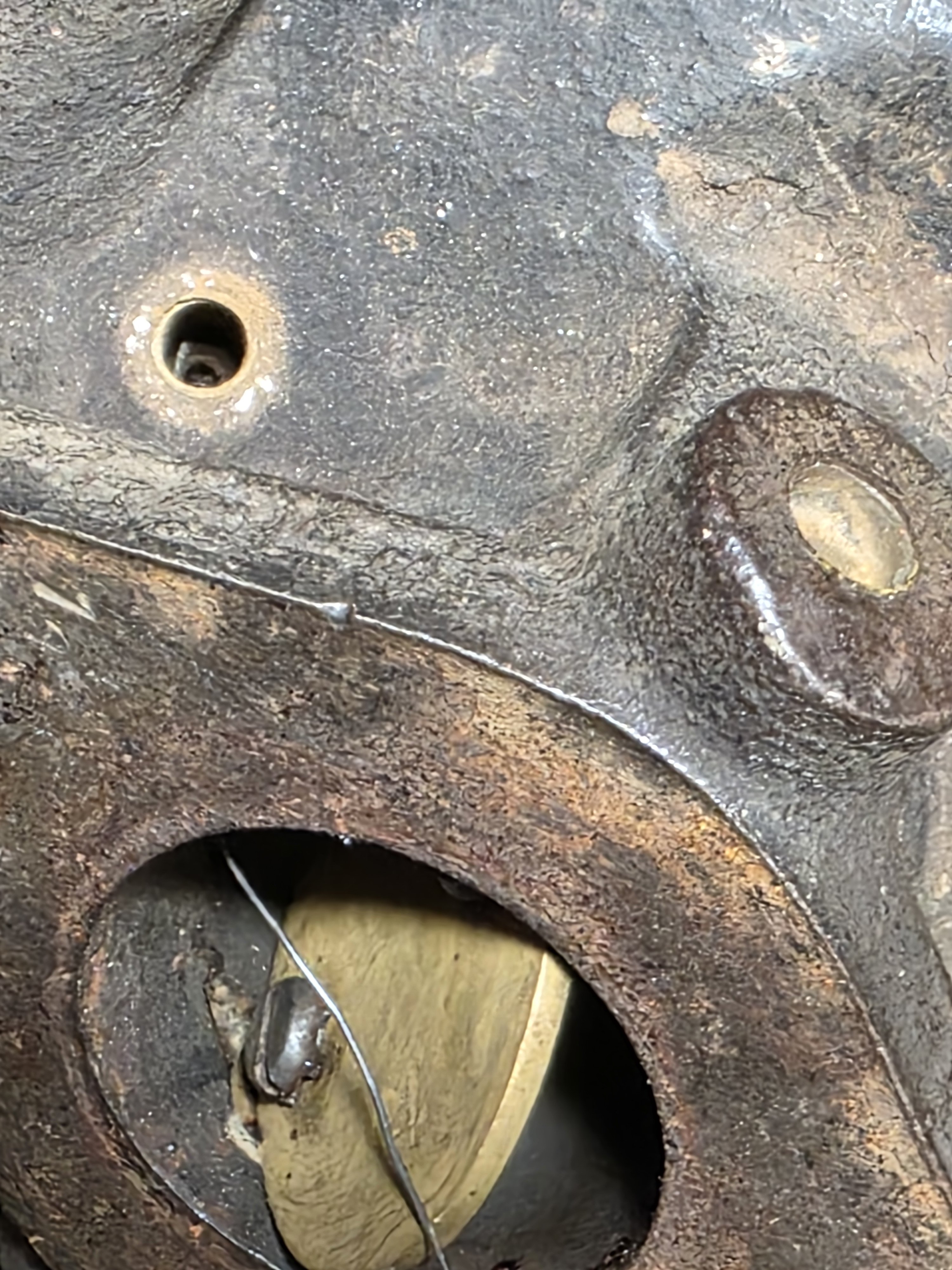

There's not really anything else for it except diving in and determining what's up with the float/needle/seat and why it's not seating the needle. No point trying to worry about how it's running until that's fixed. Ultimately, somethings up in the needle/float/seat. Not much to it except to take apart and check everything. Post lots of pictures here when you have it apart - showing the float, needle, seat, how the float is sitting with the carb upside-down, etc. Has to be one of a few things:
- Float level set too high (in this case, note that when we say 'high' or 'up' those directions refer to 'high/up' when the carb is mounted upright on the tractor, not flipped upside-down on the bench for testing/setting.
- Float bent improperly, so pontoons are in correct spot but needle is not
- Pontoons bent out too wide or in too narrow and catching on the carb body
- Seat not threaded into carb body fully, or threaded in without gasket
- Something preventing the float from moving up fully other than needle bottoming out on seat
- Crack in carb body letting gas come in via another passage other than the seat (rather doubtful).
Note that if an old gasser is choked extensively and cranked continuously, it can suck up a lot of gas into the intake body, often to the point where some will drizzle out the air intake. But once it drains out, it won't keep coming out (unless you kept cranking). When yours was leaking out the air intake, I'm assuming it was doing so indefinitely (i.e., if you left the fuel tap on it would have just kept leaking until the tank was empty). But if it was only leaking for a bit, it might be as simple as something choking it off too much while cranking (or just a lot of cranking with the choke out). I rather doubt this, because it was running. But let us know if it was leaking continuously (as I presume) or just had some fuel in the intake that stopped leaking once the little bit had leaked out. If something is choking it out, then checking the choke linkage and oil level in the air cleaner would be things to look at. Not uncommon for folks to over-fill the oil-bath air cleaners to the point it chokes out the engine. But from the sounds of your symptoms, I don't think that's the issue. I think it's one of the above bullet points.
