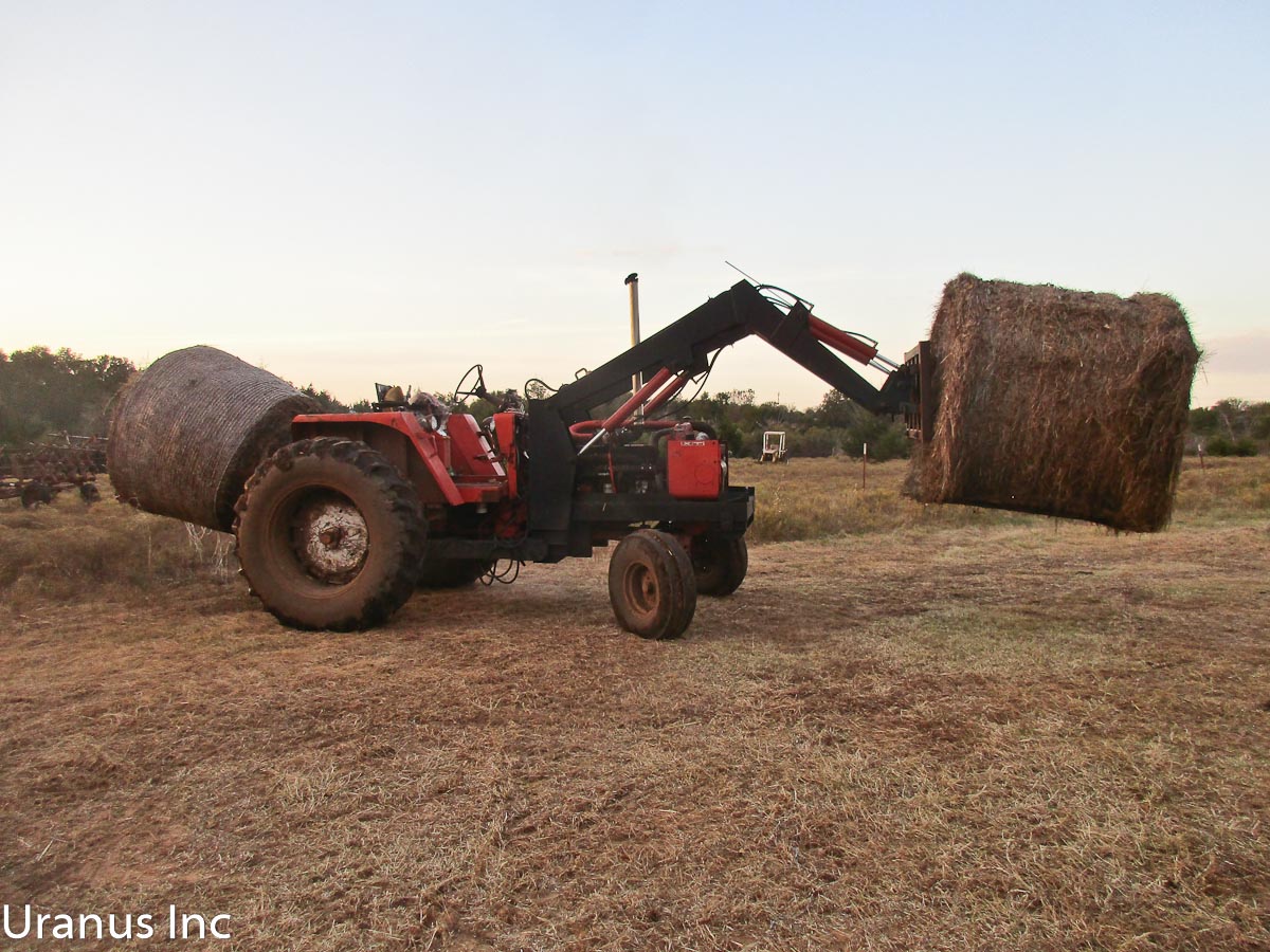

I have two 190XT's. Both have operated with the same loader, in the same conditions. (reason for owning 2 is another story)
I do like the wider front tires for the increased flotation they provide.

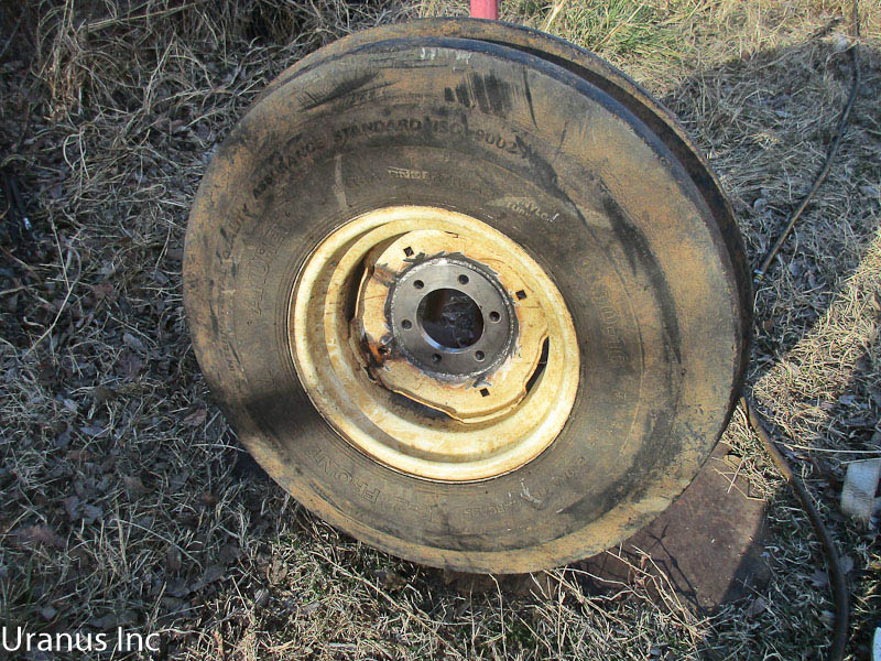

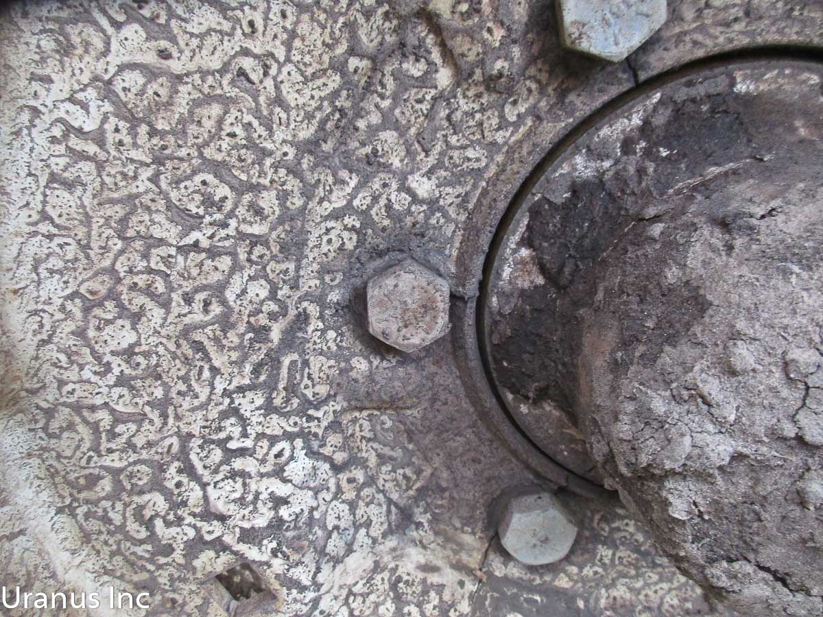

During the Winter, the drylot is exceptionally muddy, and you encounter deep ruts. On top of this, you're running at high speed to keep from getting stuck. This is Hell on the front wheels. BTW, this is the second Allis.......same front tires.

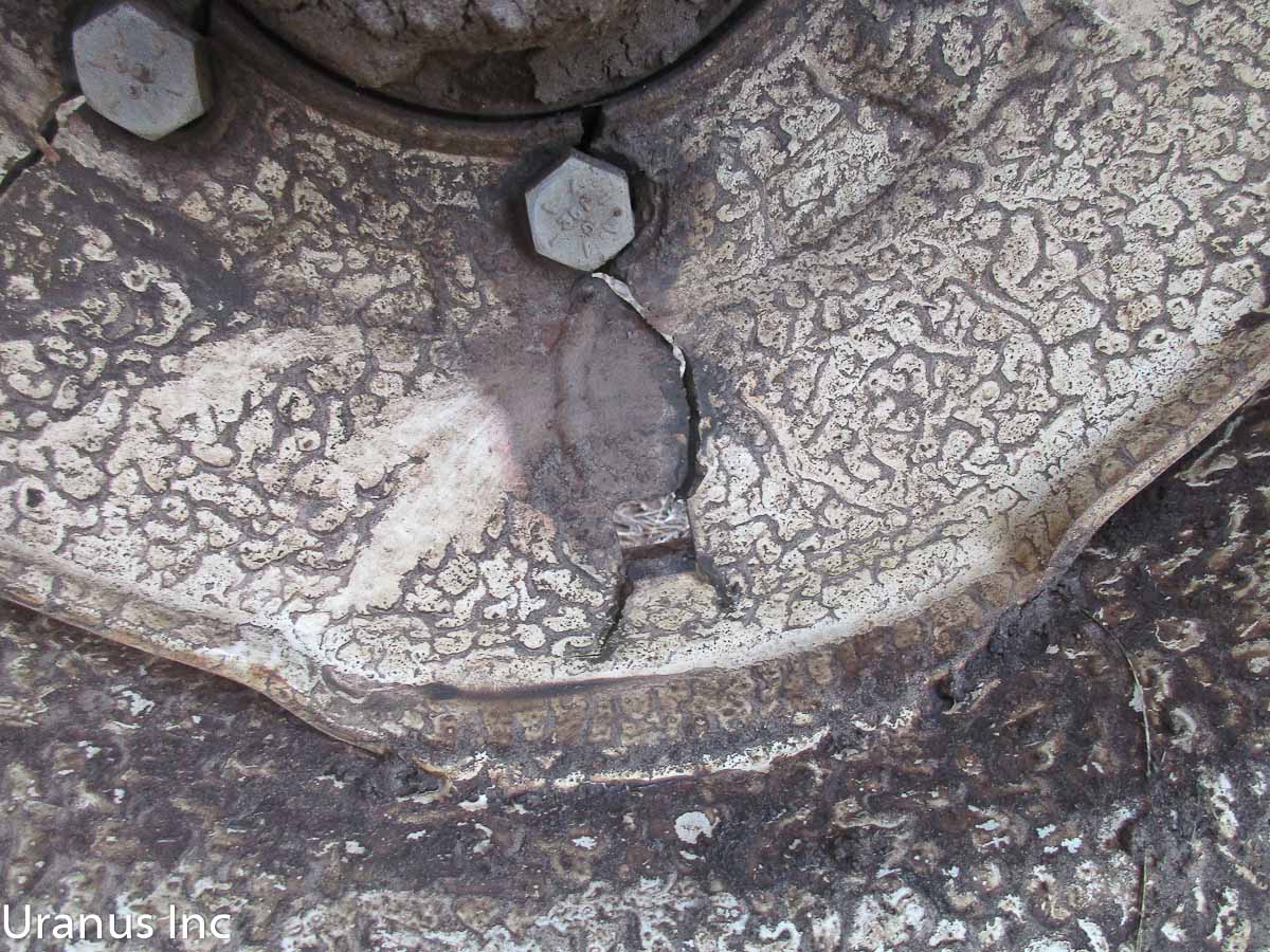

This is what that negative offset can do to your wheels. Heavy loading, repeated cycles(fatigue), and side loading when running in soft ground.
The lug holes are a problem area. Stress concentration around a hole.

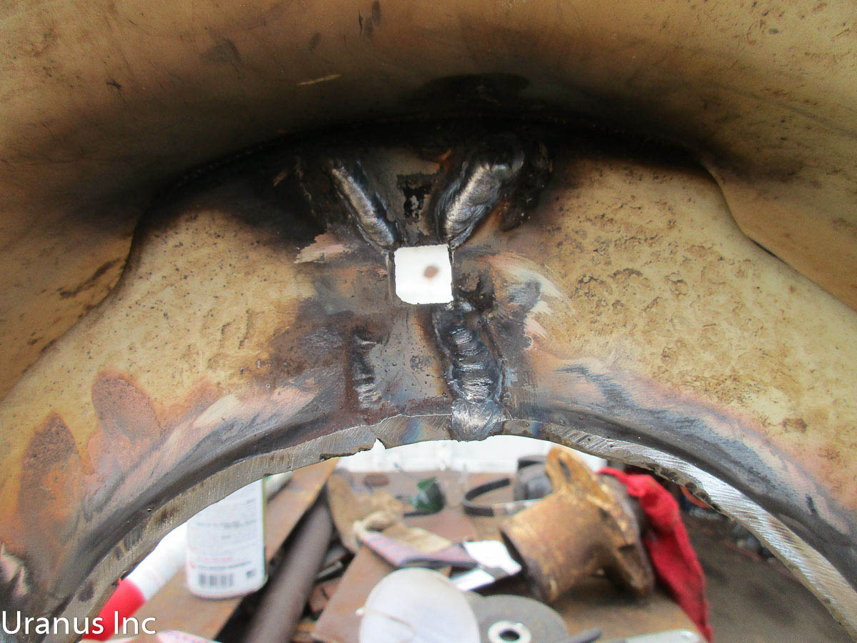

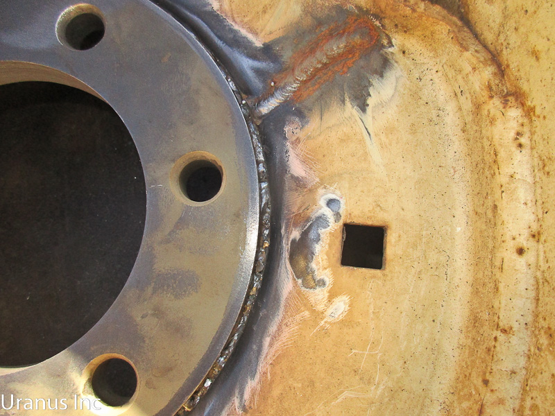

You can keep buying wheels, or modify the wheels to deal with the increased stress. I'm replacing the centers here. Once the center is cut out, the remaining cracks are repaired.

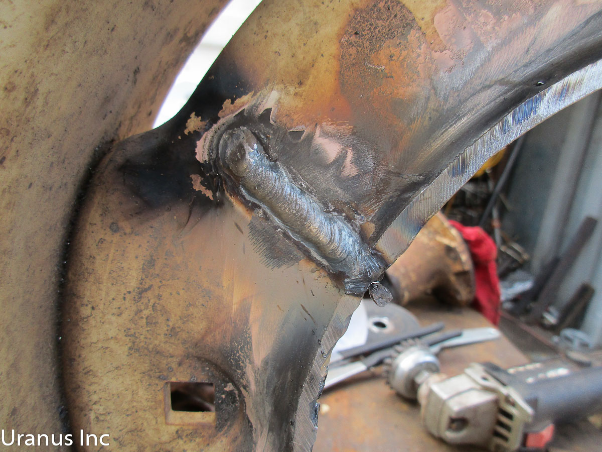

The cracks are V'd out, then welded on one side of the wheel. I recommend welding them uphill. Better control, and fusion. Then the cracks are back gouged with a die grinder on the opposite side, until you run into the weld you made on the front side. Fill in the V's you just made, and you have a full pen weld.

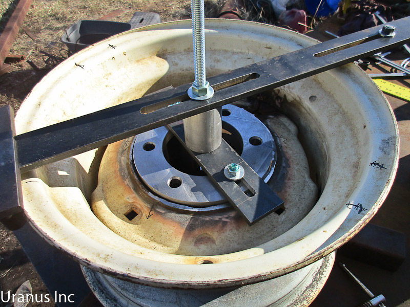

Welding the new center in the wheel isn't a simple process. I made a jig that fits any wheel I need to work on. These new centers have to be perfectly centered, and perfectly planar to the wheel dish.............otherwise you get unacceptable runout.

Root pass is done with same rod, 7018, but in small 3/32 diameter, which enables you to get into the narrow root. And this pass is done EXTREMELY HOT...............and shoving the rod into the puddle repeatedly as your root pass progresses. You're gouging into the backside of the weld on the opposite side. Absolute full penetration. Ain't pretty, but it's just a root pass. Penetration is king.......not aesthetics. This is gonna get covered up
Do your cover pass, and it's a done deal.
