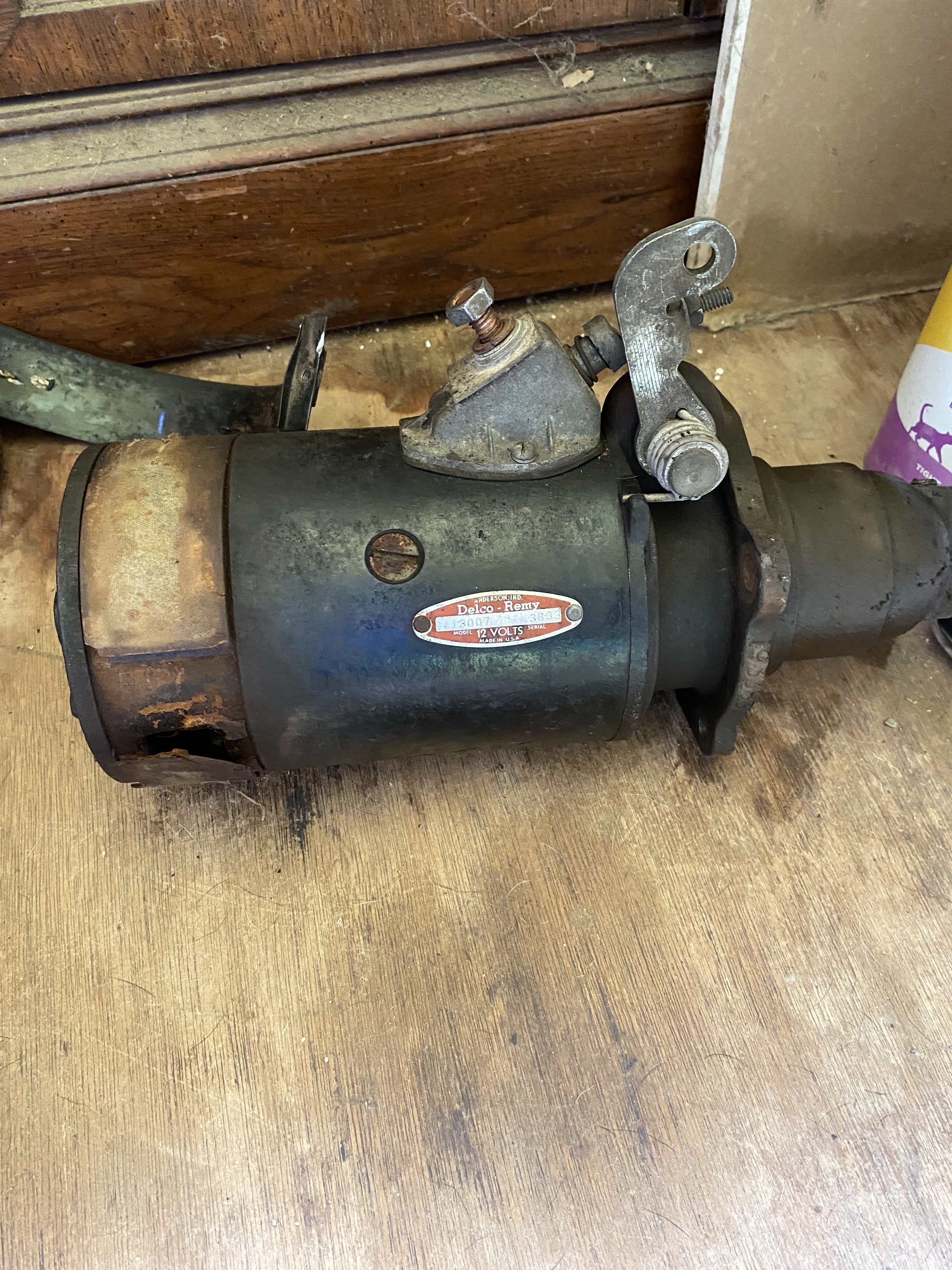

It appears this starter has been modified to use an electric solenoid/relay to energize it. Your starter rebuilder should be able to check and fit one to it. Then you will need to wire it.
Where is a picture of the starter and switch that are on it currently so we can see to compare them for you?

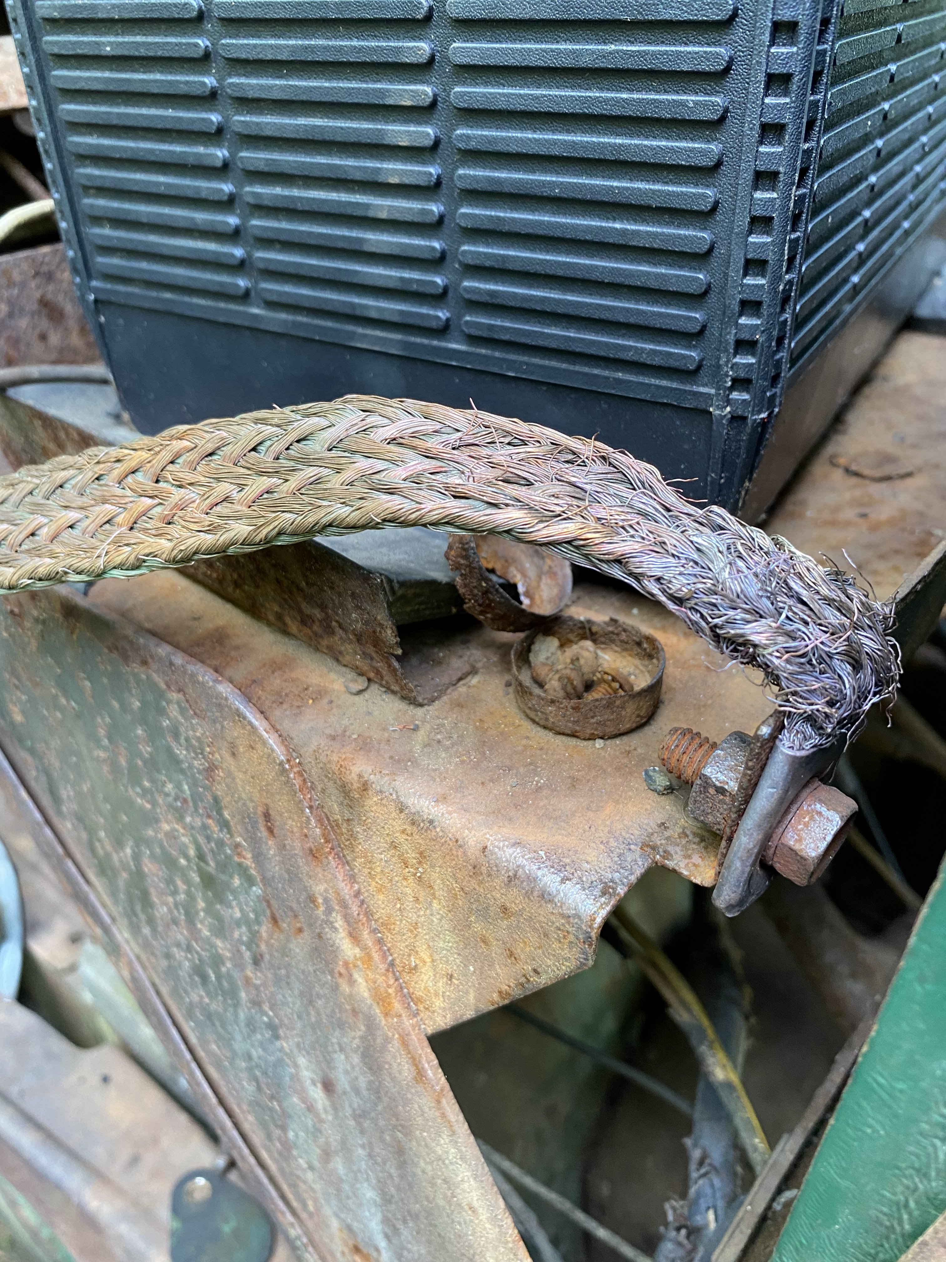

Here’s the starter and a photo of the ground wire to the battery that I’m replacing.

Cable clearly needs replacement. Get a longer cable and run it to a bolt on the main tractor chassis, not sheet metal.
The starter in this picture uses the kick switch to engage it. The other starter appears to need a relay solenoid to engage it. Is the tractor wired for that?

No. The one that I currently have on it was the original I bought the one with the switch rebuilt. I was gonna move the ground to a different spot but that’s where the ground was originally. Also should I keep it positive ground or swap negative to ground.

Yep, like I said several days ago, grounding there only worked for a year or two after they left the factory. The cowl and frame mating rusted and corroded in a hurry. Add another 75 years to that and it's a wonder there's any connection there at all.

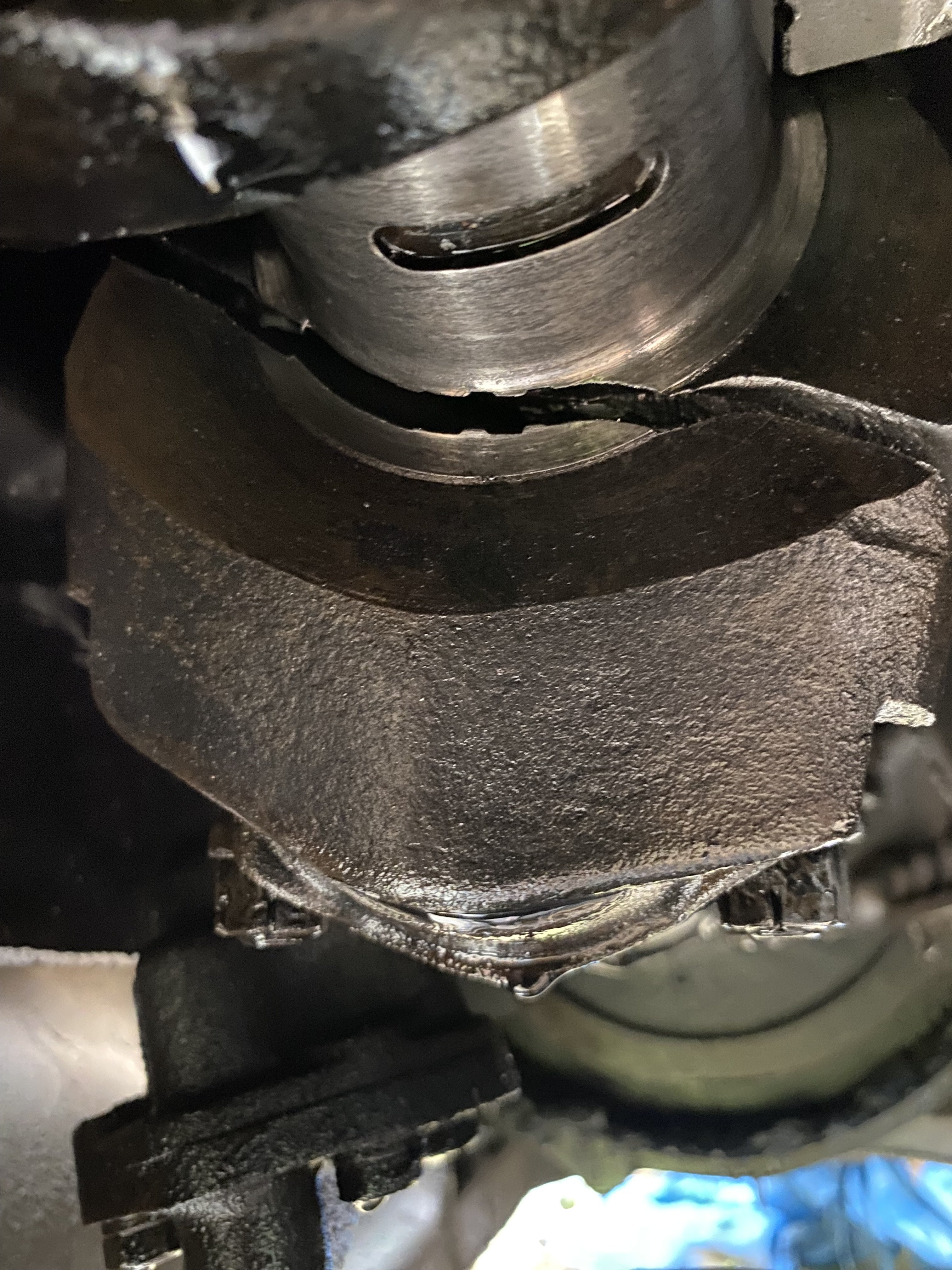

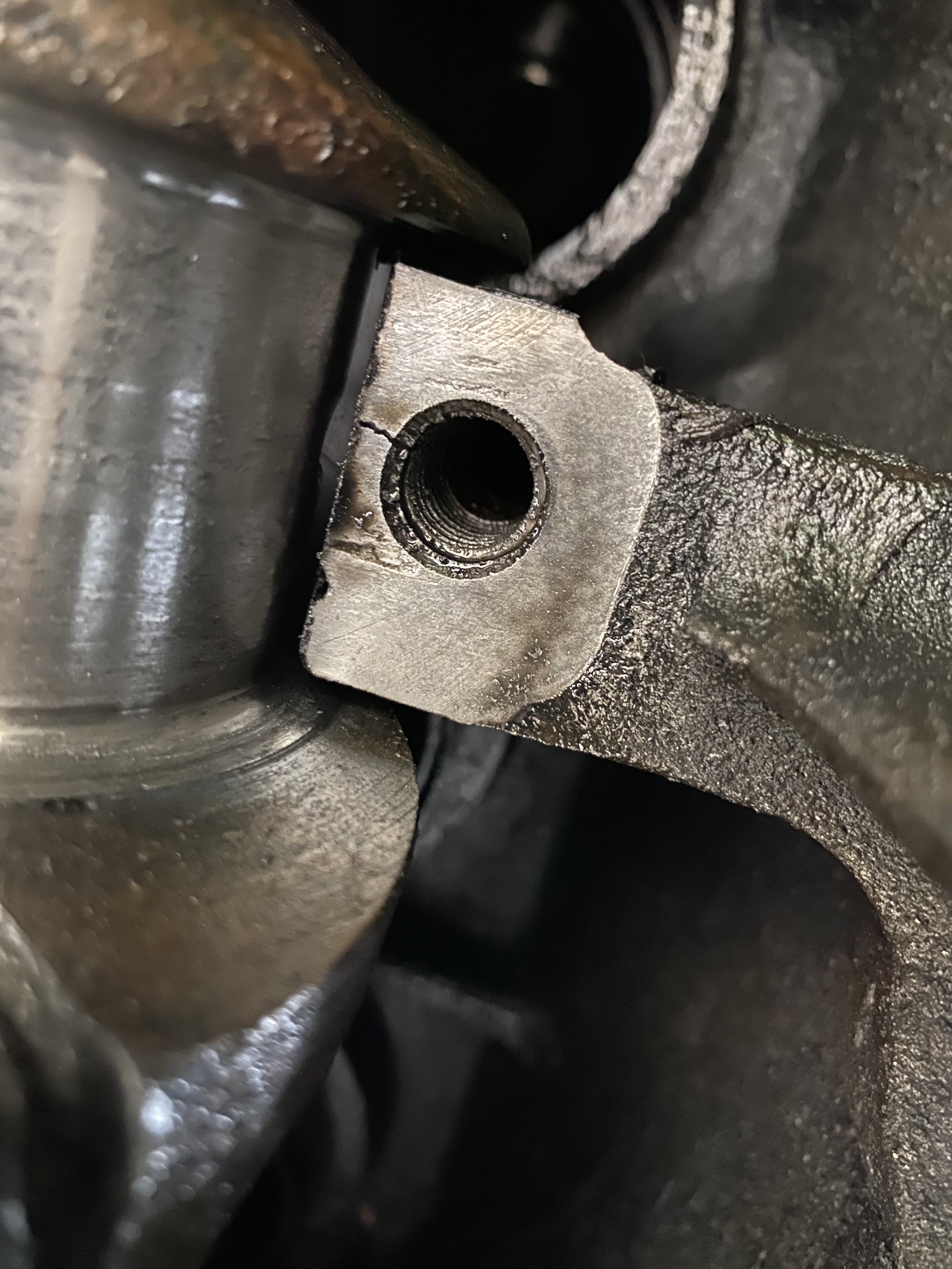

I had oil pressure when starting it normal but found out why it won’t start. The crank is in 2 and I believe the motor is unusable.
Yeah. A few others and and I all checked the crank before even starting to put it together. There was no signs of spun bearings or any cracks but it split right in the main area damaged one of the bolt holes
