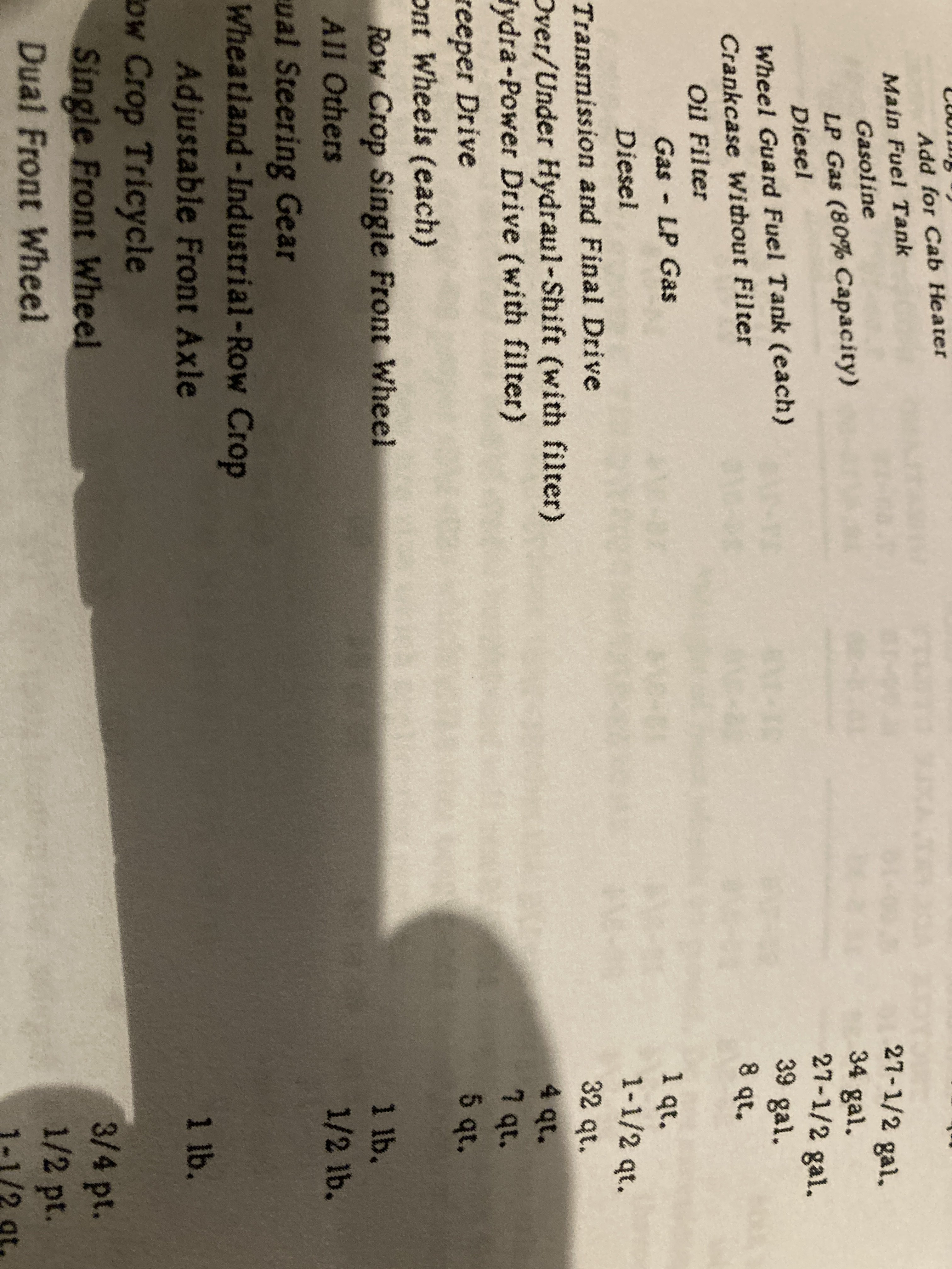

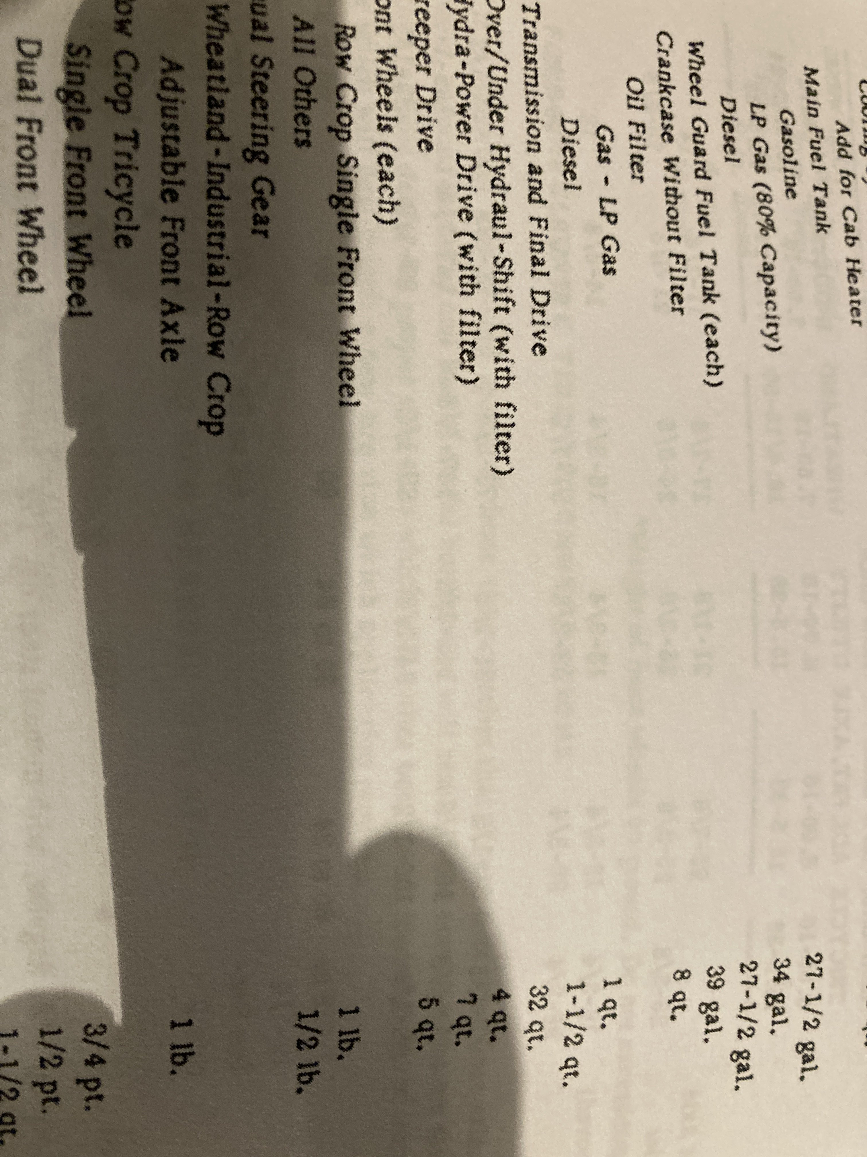

Maybe there's the problem, model of tractor. Do you have a manual for your tractor? Amount of oil should be there.
1650 manual shows 8 quarts plus 1 quart for oil filter. Again, I need 10 quarts to show full on the dip stick. Can't remember who said it, but that a couple of quarts over won't hurt anything.

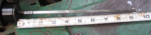

I got done early today so I measured the dipstick in my 1655, 9 1/2” long, full mark at 8”. The book says 8 quarts and 1 more for the filter. I wonder if you have the correct oil pan?? Has someone cut the bottom off and added an extra inch or so to increase oil capacity? No other ideas but that does seem odd.

Just got around to adding this. My 1650/1655 Parts Manual shows three different dipsticks.
OAL 11.5 inches. Part # 156 165-A (order 157 974-AS)
OAL 11and 7/8 inches. Part # 157 562-A (order 157 974-AS)
OAL 13.5 inches. Part #157 911-A
Do any of those numbers match up to what's stamped on your dipstick?

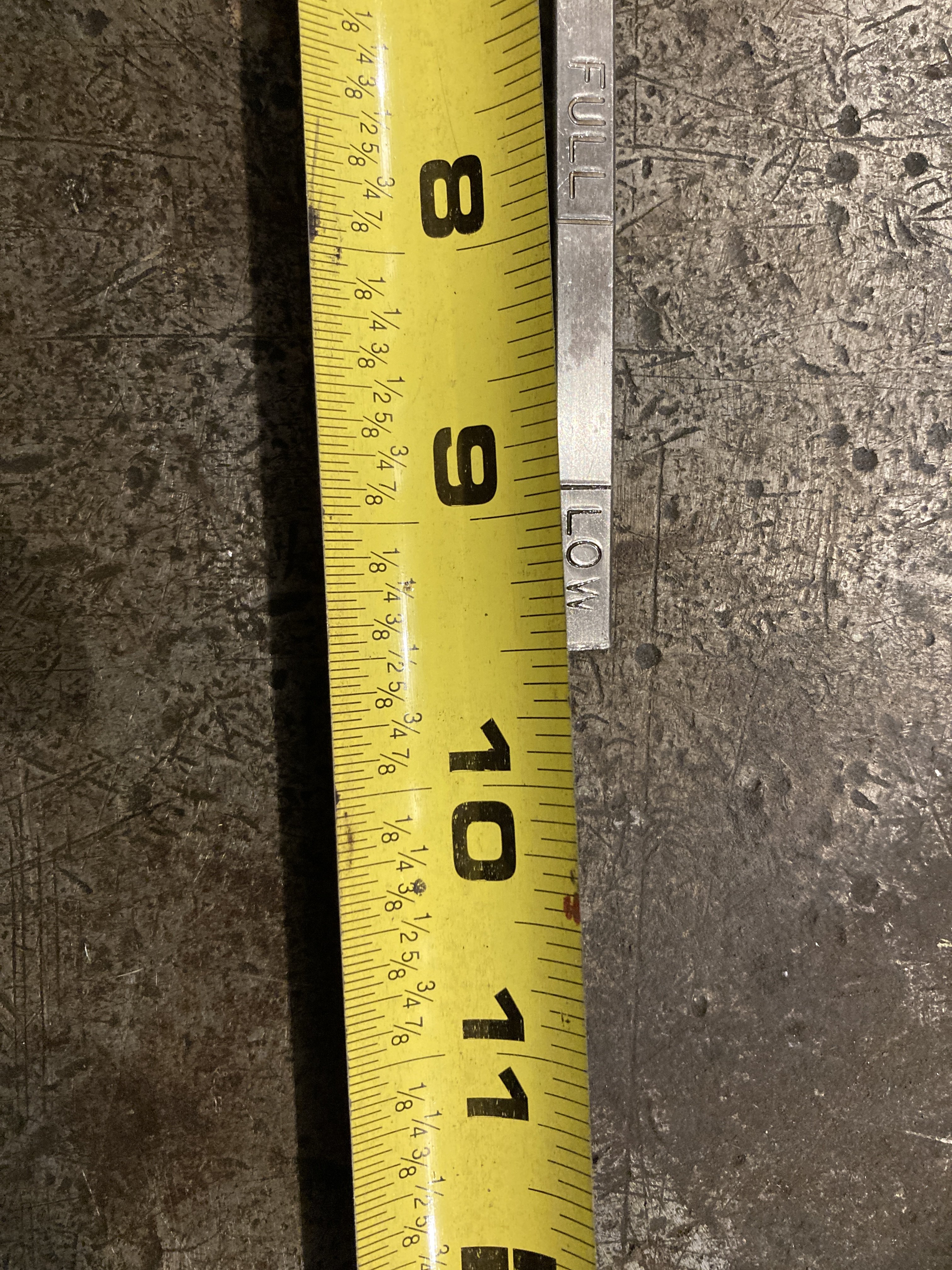

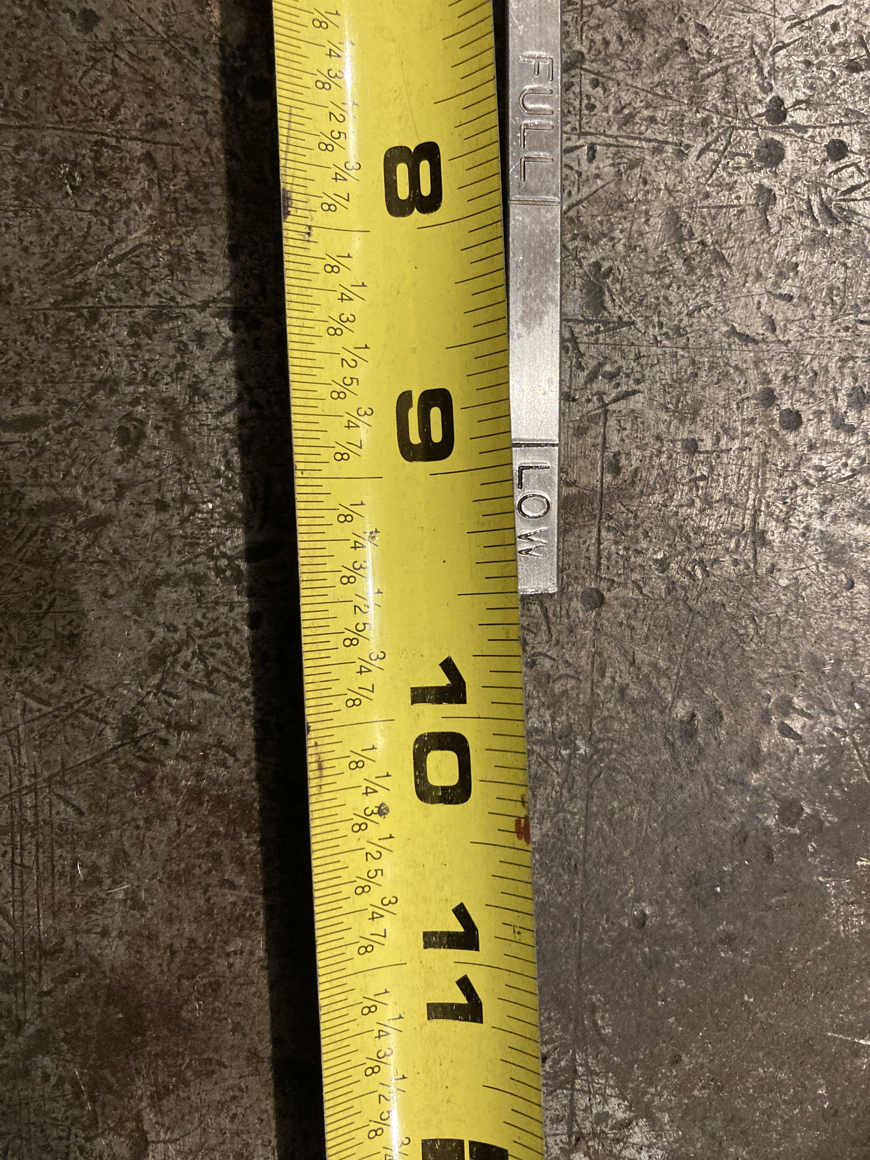

Pic of my dip stick. Just what you see.
The parts book gives OAL-Overall Length, which includes the top section.
I don't have a parts book. Going my tape in the above picture, just short of 9 1/2", add the top section and awful close to 11".
If the engines were the same, why the different lengths of dip sticks?
You're showing 2" difference between part #156 165-A and 157 911-A
The parts book doesn't give any explanation for the different lengths and any engine differences. The two shorter ones default to the same replacement parts number, so they must have decided the difference between the two was too small to matter. No idea why the third dipstick is so long. I wish John S. was still around, he might know.
