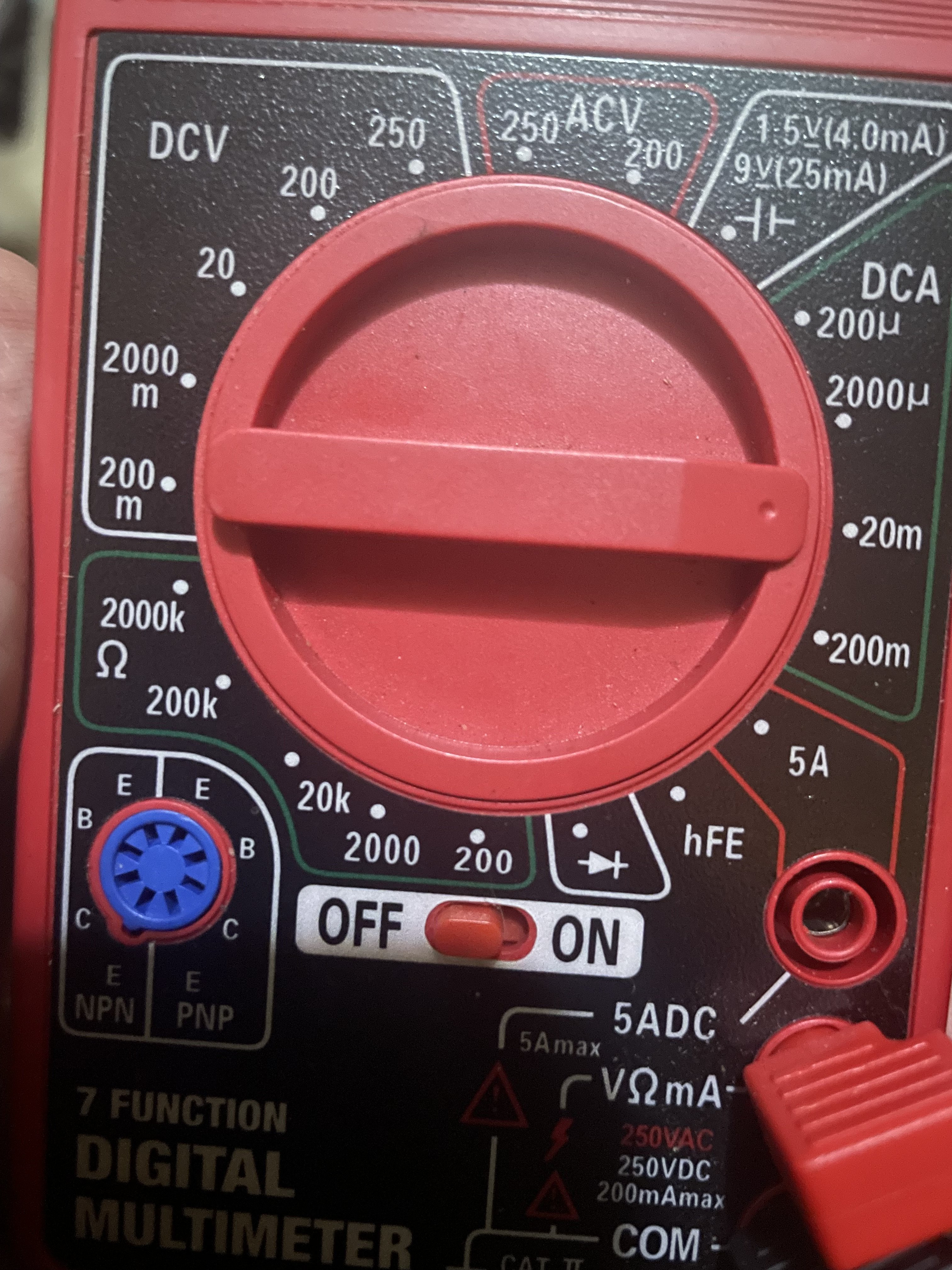

I am not real confident using a multi meter for this task.
I did hook up the meter using the setting 200m and it gave me an error code of the 1 on left side so I just put it away and used the test light.
So educate me because I want to try again using the meter because the test light may be reading the 50 to 85 m allowed drain.
My biggest setting looks like 5a.
What lead do I put on battery and what lead on wire.
I have used a multi meter to measure volts and ohms but never amps hence my low confidence level.
If I understand correctly that shows that your load is over 200 ma. That may be normal right after you shut the car off as has been mentioned as it takes a while for everything to go to sleep. It might be helpful for you to find the draw on a higher scale such as the 5Amp you mentioned. You have a digital meter so you could put it on "DC Volts" the lowest setting and start measuring across the tops of the individual fuses. Even newer fuses have bare spots on the top where you can stick the voltmeter probes. A fuse that has current flowing through it will have a small voltage drop across it (mV). The ones that measure a small drop are the circuits you want to check. Again, some will draw a small amount of current all the time. I have found this method helpful in the past and you don't pull the fuses to do it.
