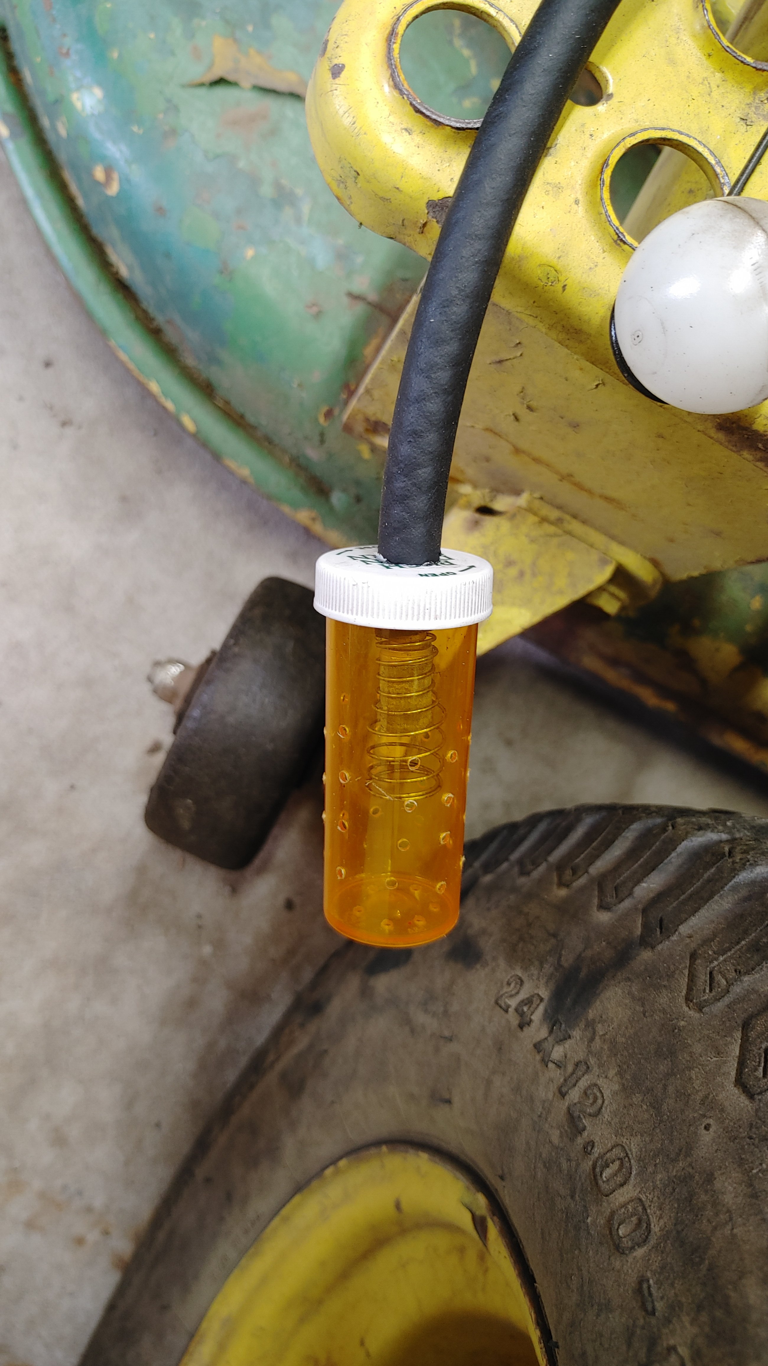

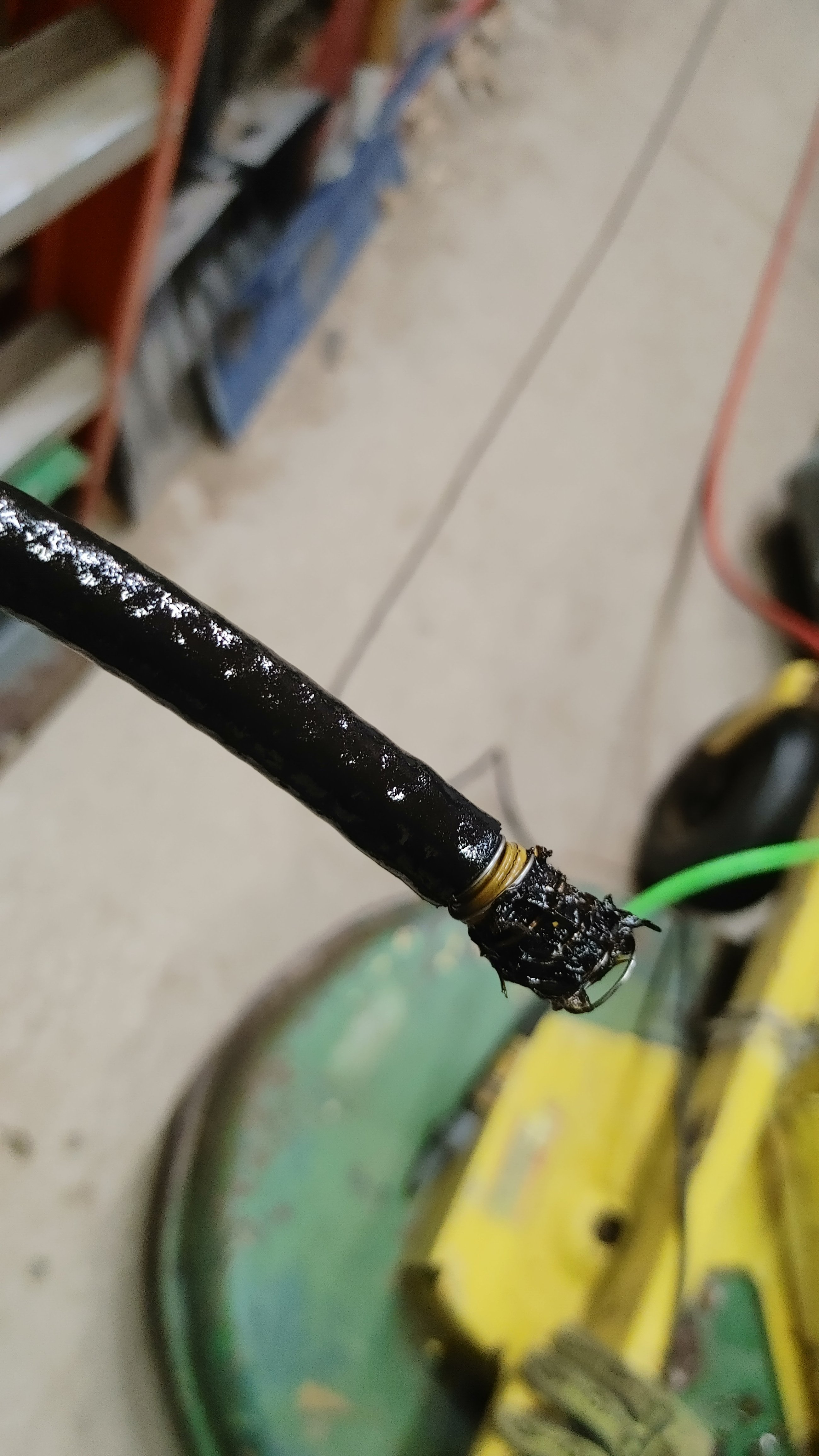

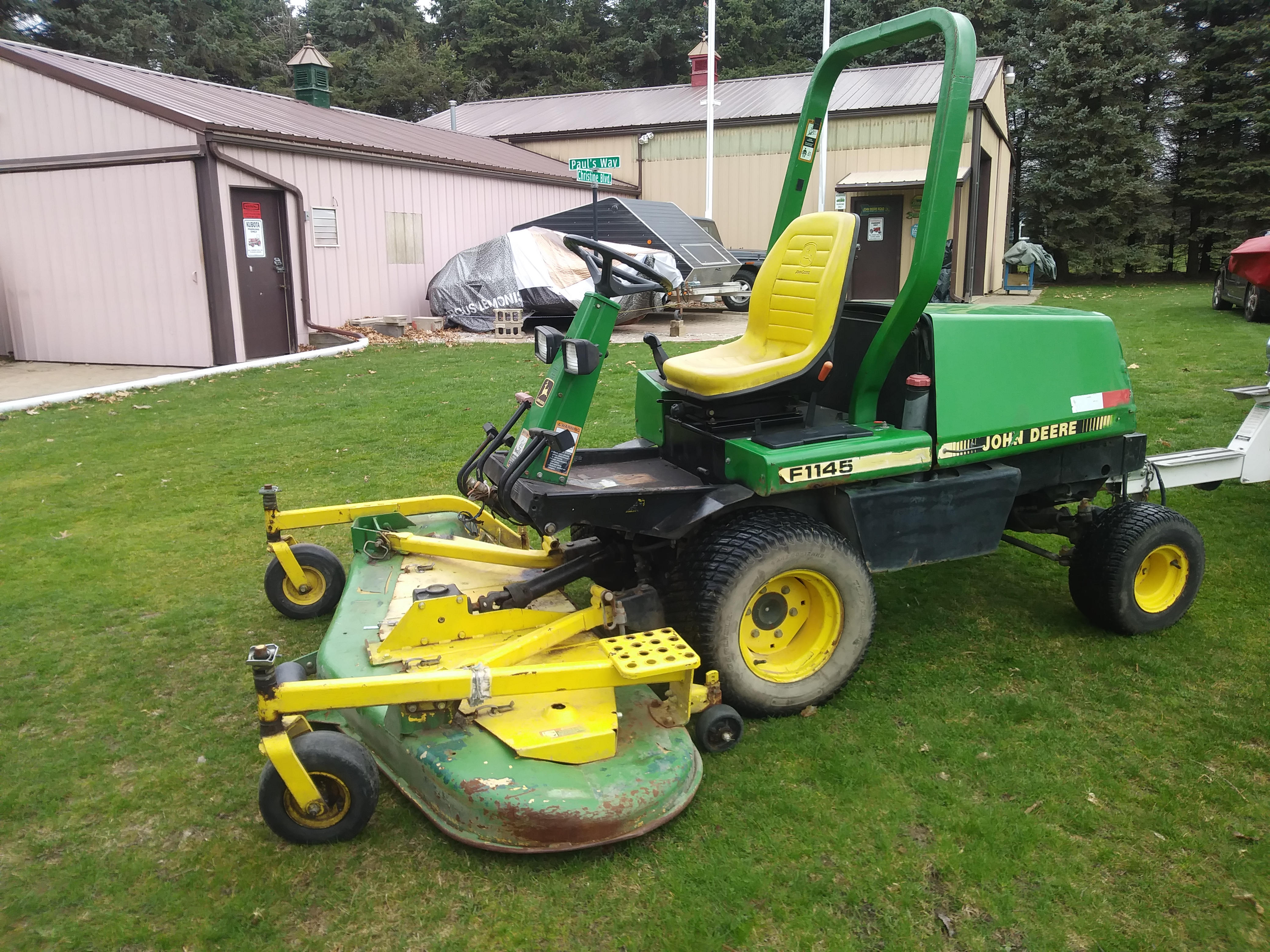

No where near apples to apples, but my JD 1145 with dual tanks would run out of fuel (diesel) on both tanks after about 20 minutes. This is what I found on the end of the suction lines in both and my fix. Fix has been working for 3 years.View attachment 80292View attachment 80293View attachment 80294
Both of mine are new, but the old ones looked fine. Thanks though as I had originally thought something like that years ago when i first started having this issue.
Was that tank shavings or gunk or the slimy bacteria/algae ?

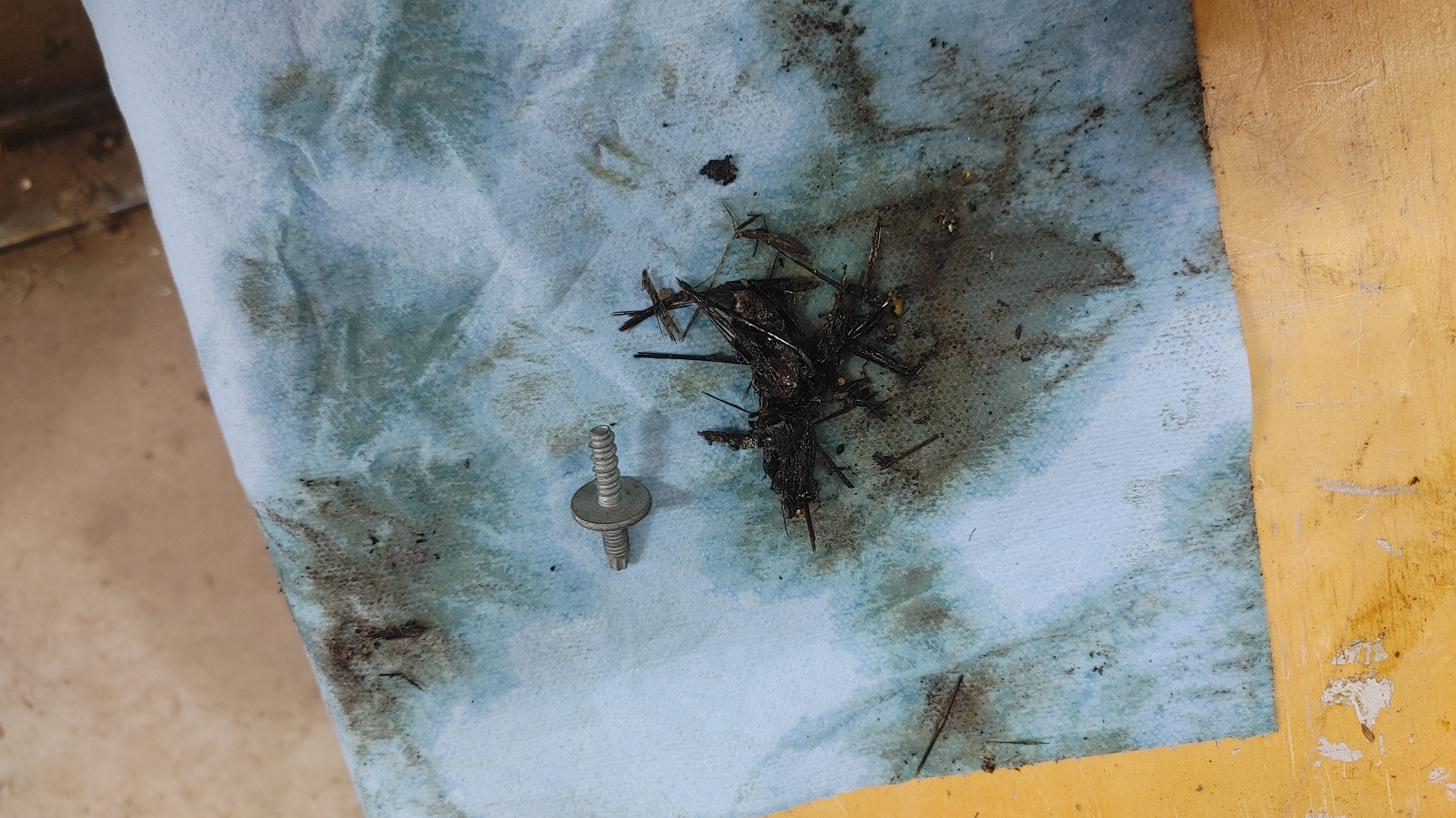

None of the above. Machine is a 2000 that I got well used in 2019. Mostly dirt, grass and other debris that got in the tank during fueling or possibly being run without the fuel caps at one time. Here is a picture of the total debris in both tanks. The screen/filter on the end of the lines were incredibly small.
