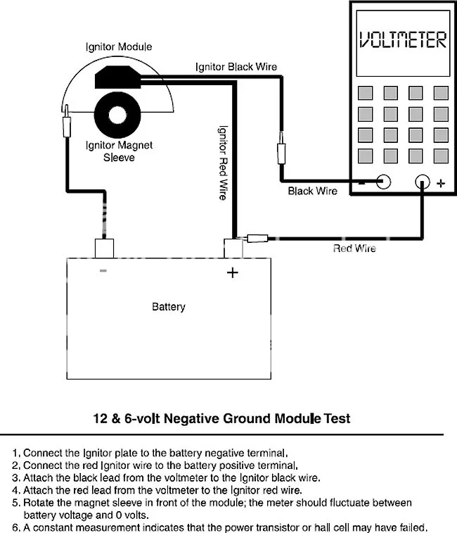

I recently put a Pertronix 91247 Pertronix Ignitor II in my 12v '49 front mount dizzy 8N w/ original coil. It never did anything but sputter on trying to start. Today I finally pulled it back off to bench test it and I'm getting no voltage at all, at any point in the rotation of the shaft.
I've hooked it up like this and double checked my connections and made sure nothing wasn't touching that shouldn't be. Igniter sleeve was still in the dizzy base. The magnet sleeve I assumed to be the aluminum plate everything is connected to - that's what it looks like to me below:
Is there anything I should check before assuming it's a bad module?
edit: I should have added that when checking for spark before pulling it off, only one of four had a decent, constant spark across 1/4" gap. 2 had no spark at all, and another had a weak spark occasionally. Battery was checked good

How old is the unit? DO NOT use solid core wires; they will kill the module, and, per Pertronix, will void your warranty. They specify resistor-type wires. BTDT. My first on my 8N lasted about a week, and had to walk back to the shop for the points I took out. Put a new module in, with proper wires, and haven't had any problems for four years now.
Unit is brand new. I didn't use solid core wires. They're the stranded copper core type, and they are brand new also. I made those up to replace my old ones when I was having spark issues after putting in the EI.
Is the copper core a resistance wire? By solid, I mean no resistance built into the wire, whether stranded or solid. A stranded copper wire would have no resistance, but be flexible. You MUST use some sort of resistance wire. It will not affect operation of the ignition system at all.
I have used Accel brand resistance wires on all my equipment I have a Pertronix unit installed on with no issues. Some have been in operation for six or seven years.
Damn. Looks like I fried my unit. Ignorance is not bliss.

From the Pertronix web site:
Its very important to verify that your spark plug wires are compatible with the ignition system, or any on-board electronics in general. Solid core wires have a copper or stainless steel conductor and generate excessive Electromagnetic Interference (EMI). This EMI can create confusion with electronics and ultimately damage them. With all PerTronix ignitions we recommend that a suppression style spark plug wire (also called carbon core) be used. The suppression wires do an excellent job of controlling the EMI with no degradation to the ignition performance.
If, you don't know how to identify the type of wire on the engine. Here's a articular written by our friends at Hot Rod Network showing pictures of the different wires. It should help with figuring out the spark plug wire being used on your engine. Keep in mind PerTronix ignitions need carbon-suppression, or spiral-wound wire: https://www.hotrod.com/articles/1006rc-ignition-wiring/
Also, in regards to leaving the ignition switch on:
With Ignitor electronic ignition systems, leaving the ignition switch in the run position when the engine is not running, can cause permanent damage to the ignition system, and related components. This does not apply to the accessory position of the ignition switch. Ignitor II and Ignitor III ignition systems have protections built into them that turn off the system prior to damage.
Bold and color mine. Seems pretty clear to me. Once again, most of us tend to forget to RTFM! zuhnc
