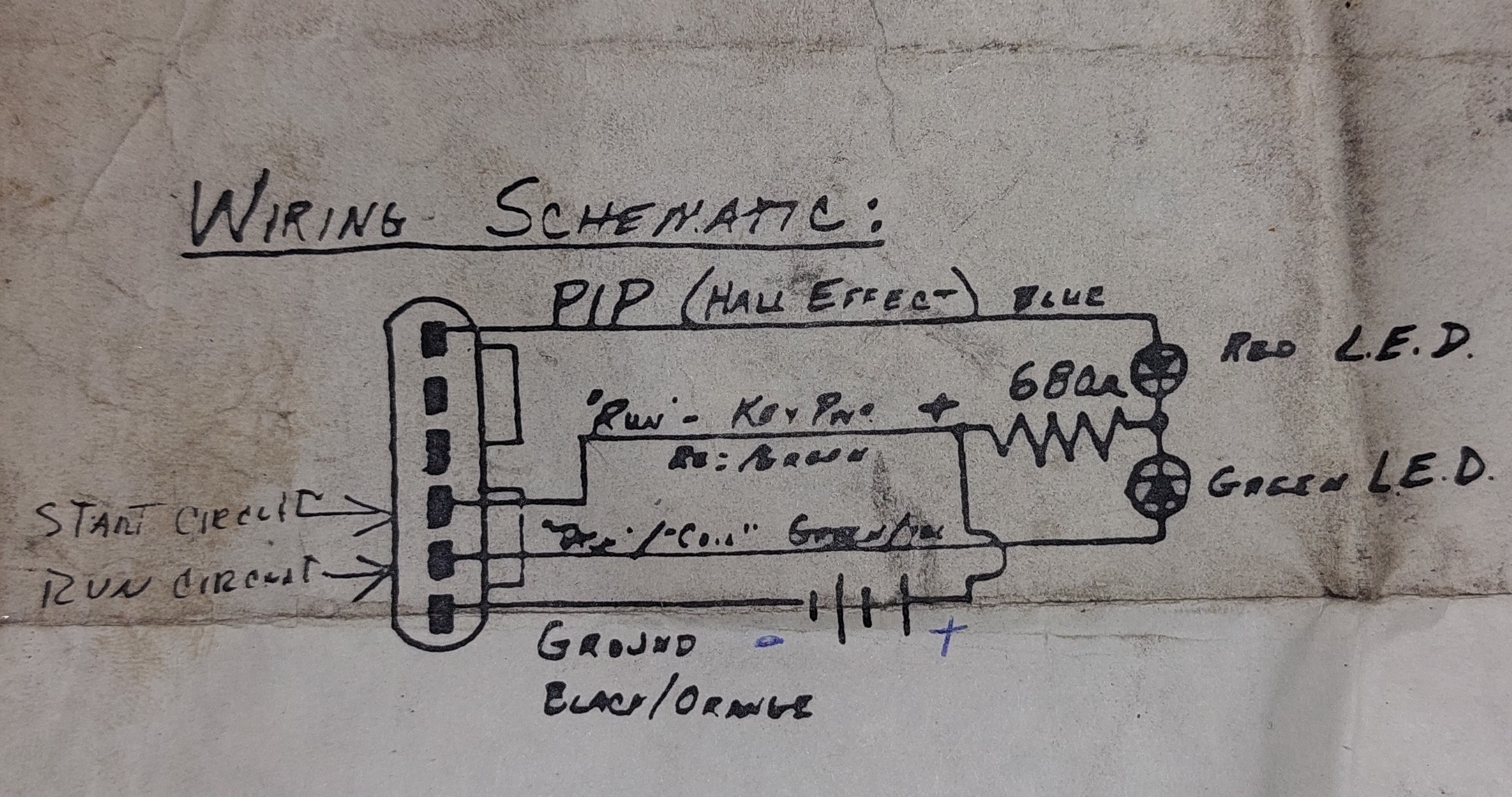

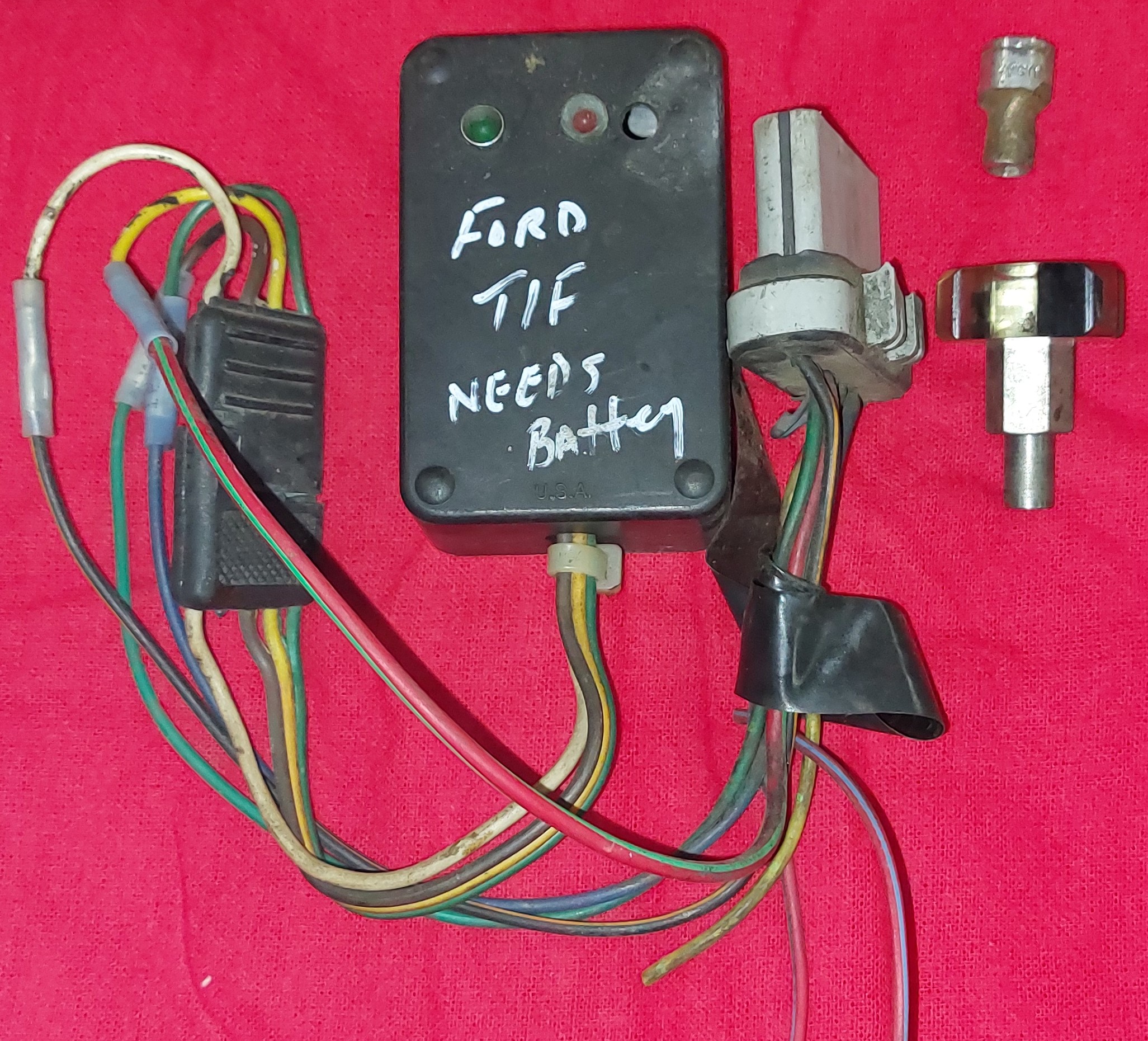

I just came across my special socket for TFI module the other day, used to carry it and a module with me in the glove box.
That may be the first 5.5mm I ran across. Until I brought a special tool I ground down a socket for this. I made a tester for this still have it. The best tester was a used distributor plug it in ground it and give it a spin. The reason for the tool is to remove the module without removing are moving the distributor as they are notorious for being stuck. All the modules (most all there were a black and a grey) were the same any dist. would work.

I am sure folks are dyeing to make a tester. My first ho-made socket a 7/32".
SnapOn had a 5.5mm socket back then, I bought the one with the plastic knob to keep in the glove box.
