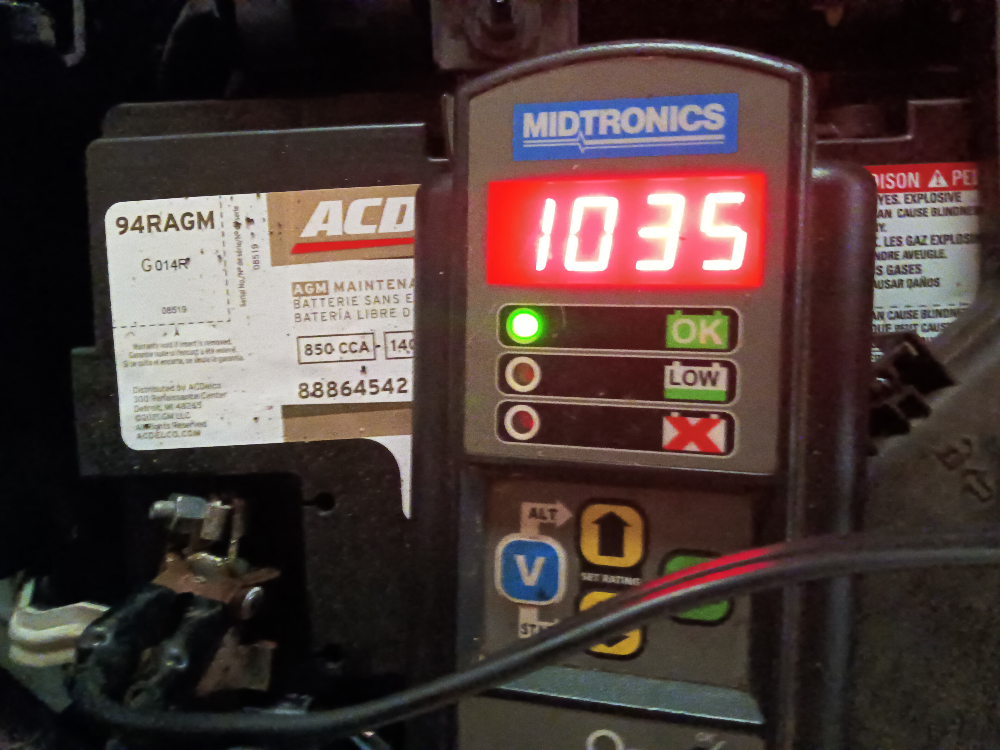

You can make 12v using 8 flashlight batteries.
The flashlight batteries can't produce enough current to start a car.
Just because a battery can produce 12v doesn't mean it can produce enough cranking amps.
This meter takes the guesswork out of how many amps a battery can produce.
This is a new battery rated at 850 cold cranking amps and over 1000 cranking amps.
The meter confirms the cranking amps.View attachment 72811
Well sir that's why I have a HF carbon pile, load tester. One of the best 50 bucks I ever spent. Not familiar with your meter. Considering 200 amperes being a common starting current for numerous sized and types of engines, and needing 10 volts min. across the starter when the battery is delivering 200 amperes, I don't know how that meter can instrument that test senario.
