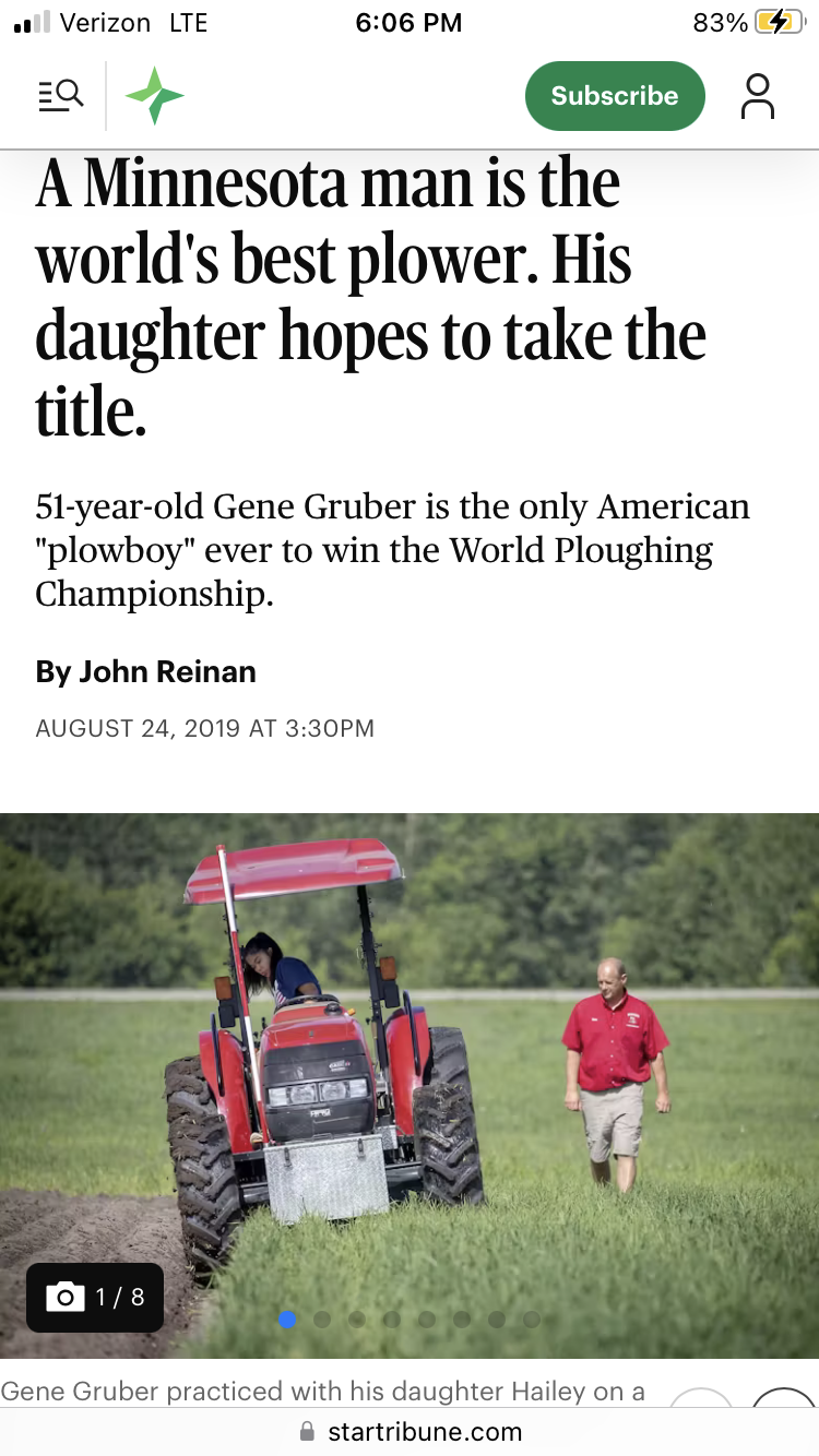

His 20 something daughter is no slouch either.
