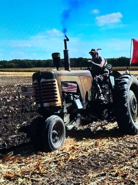

A couple of pictures, that’s me with my super 88
