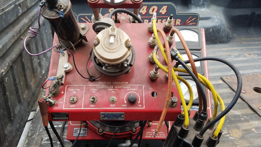

I'm kinda spoiled, I can just put it in one of my Sun distributor testers. Nicest are a pair of 404's that came from a HS shop program that was closed. One has the training Ignition Simulator so one can run the whole system, with a coil, resistor, and 8 plugs. The instructor used to entertain the kids by holding a piece of paper in a plug to light it on fire :giggle:
When I was going to automotive tech school in the early '80's, ALL cars that came in for a tuneup with contact point ignition systems had the requirement of pulling the distributor from the engine, disassembling it completely, getting it lubed and then put on the Sun distributor machine for the final dwell adjustment and ignition advance inspections. Was that overkill? Perhaps, but the customers loved it. That job was not always easy. A few cars have a tendency to have the aluminum distributor weld itself to the cast iron blocks. I also remember a couple of kids who pulled the distributor on their own car and didn't get the oil pump shaft to mate up to the distributor on reinstallation. Not a pretty result.

Those Sun machines are nice.
There's an add-on called a Pulse Amplifier that lets you do electronic distributors- I have a couple, they are a little rare and expensive. I had a Flathead Ford adapter, but someone with $350 wanted it, so... The FE Ford is one engine that doesn't actually get welded, but more like gets glued real good- takes a lot of patience, soaking, strap wrench and patience- and more patience. Nice as they show a point for each of the cylinders, so one that is a little off will show up
