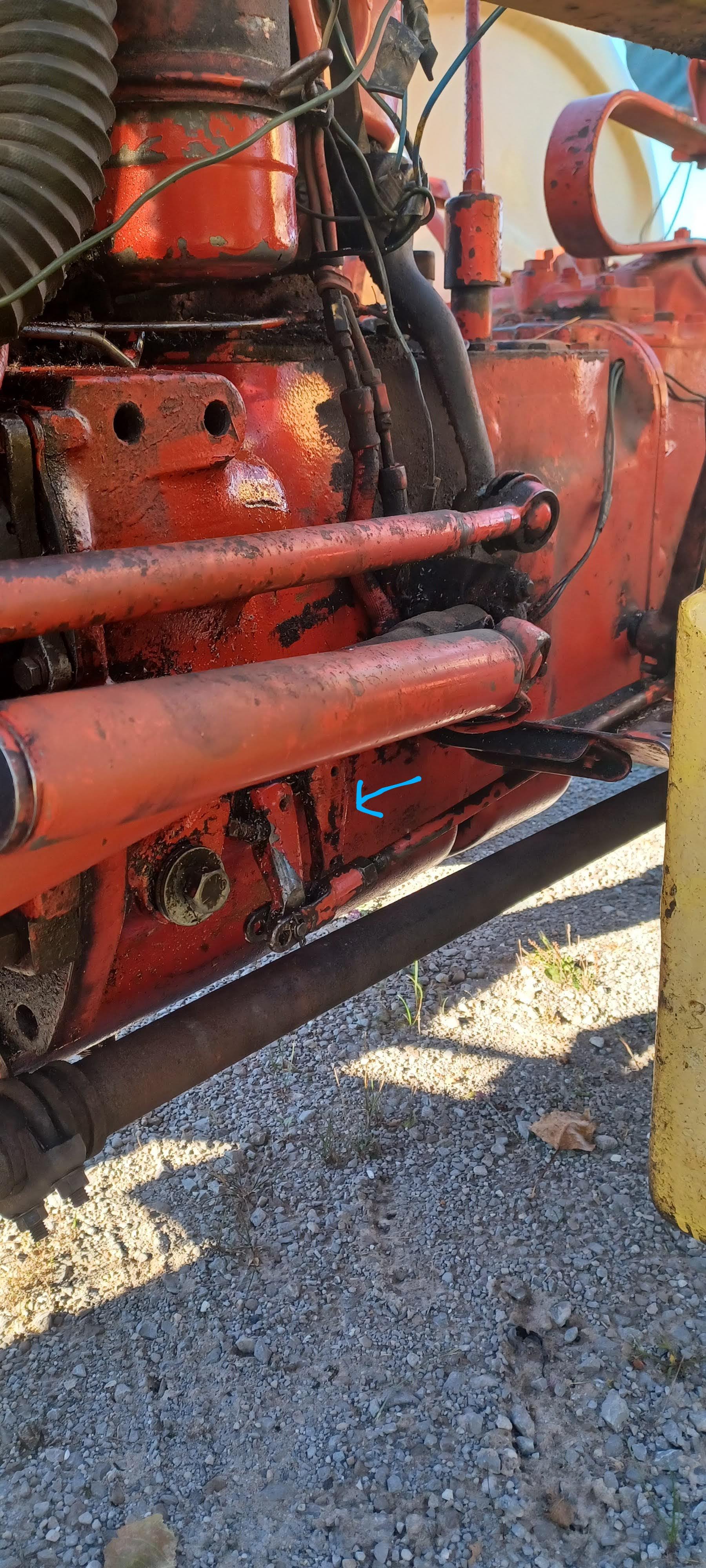

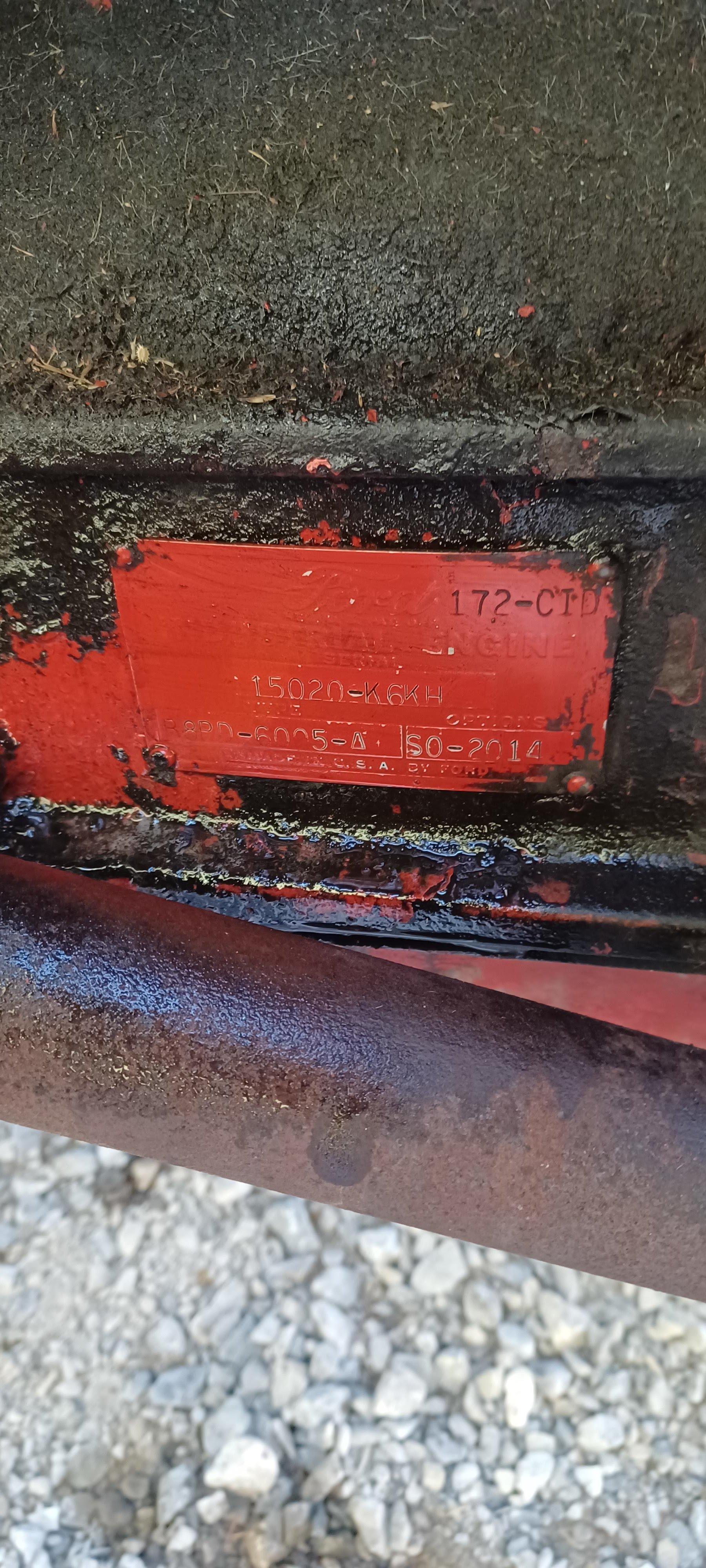

Look on the left front of the motor just above the oil pan. You will see some numbers and letters on a plate with a screw in the middle. Post that information.

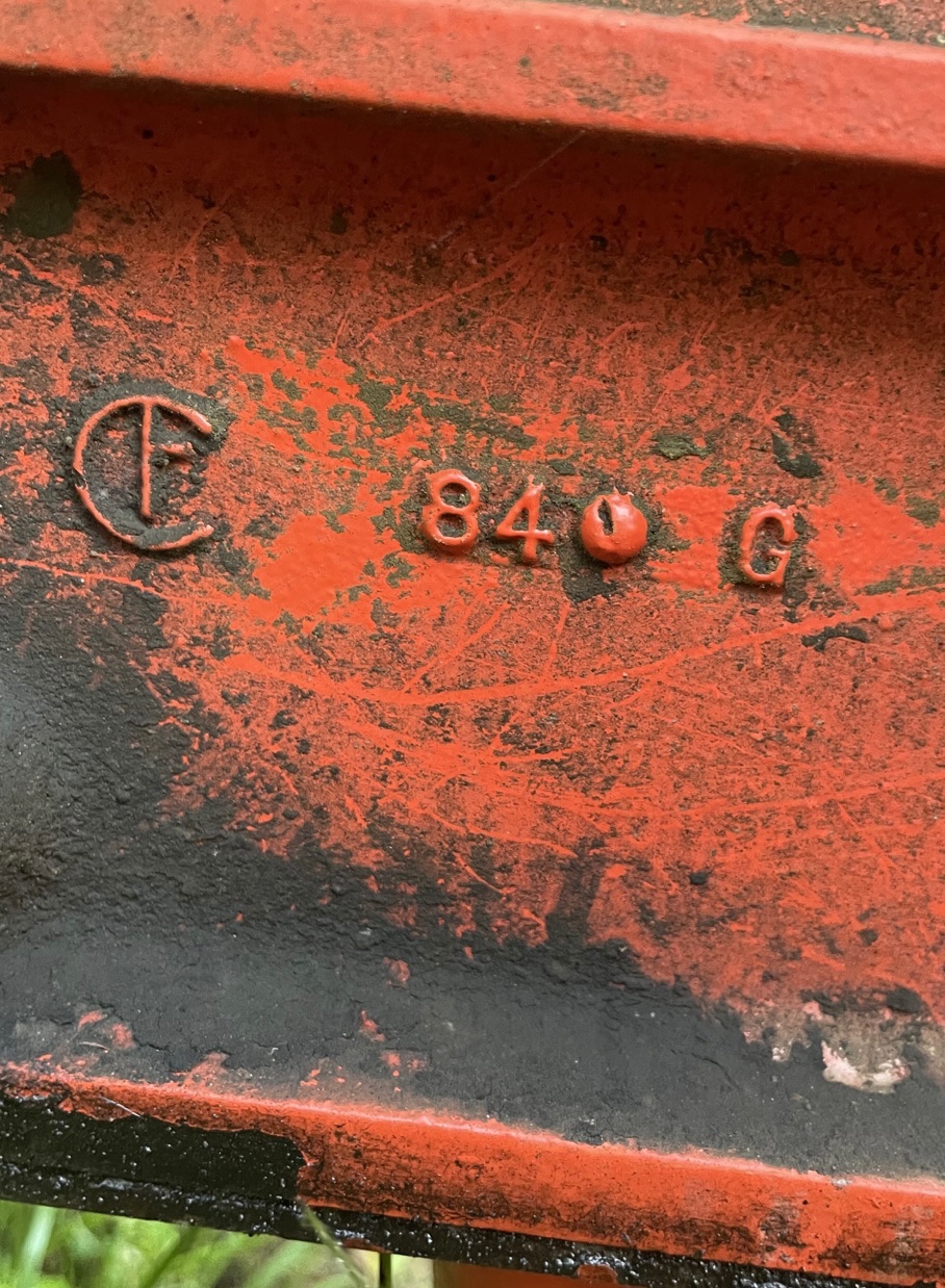

This should solve the engine ID problem. It was covered in 60 years of oil and grime. Tractor engine serial number.jpg
I have not yet found any ID on the rear axles.
I will add that I can see why some say this is a 1963 2000 because the serial number looks to be 15020. That fits a 1963.
But the 63 is blue and buff.
Your tractor is red and buff and that fits the 61 and 62 light industrial tractors.
I have heard of people painting their red tractor blue to make it look more modern but I have never seen anyone paint their blue tractor red to make it look older.
That is why I assume I am reading the serial number on the tag wrong.
I think you read that serial number correctly. I never gave a second look to the tag under the hood, I was looking at the transmission number...but the hood and the engine match, so that is something!

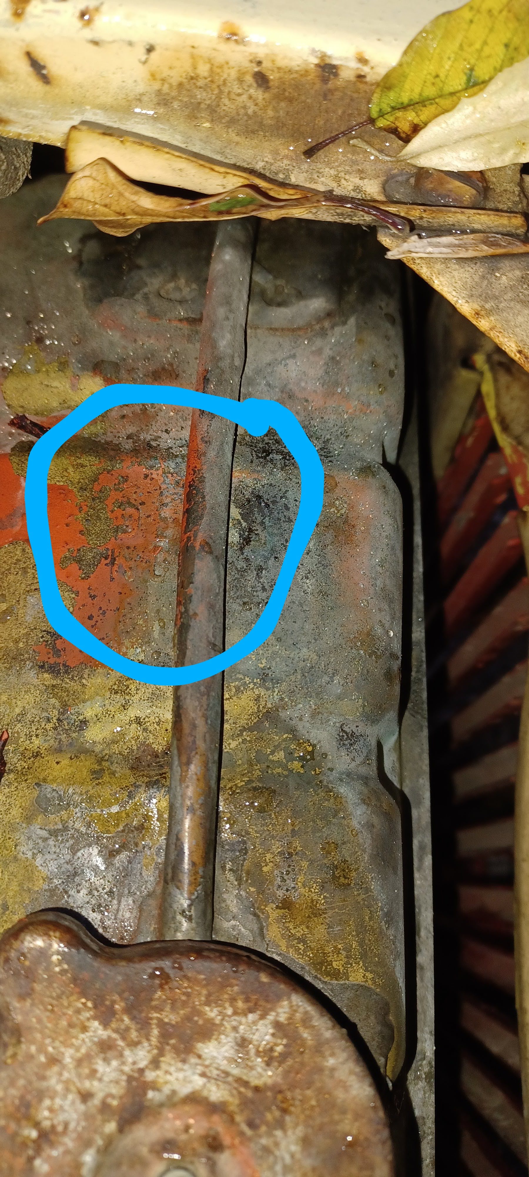

1960 engineering on axle hsg, Has power unit engine . Look on top tank of rad, have NDA xxxx and a date raised on it. Does it have rectangular hole below steering wheel.

No, the engine is a 172 CI engine, but it is an industrial engine that was originally in some other piece of equipment that was not a tractor, like a wood chipper or generator, or an irrigation pump. The engines installed in tractors at the factory didn't have those ID plates on them. Only the industrial engines had those.
This is looking more and more like a one piece at a time tractor.
What is weird is the 172 cu in industrial motor that would never come in a 2000 tractor (wrong size) has the same serial number 15020-K6KH stamped into it as the 2000 industrial tag someone put on the hood.
Then it has a 1955 transmission out of a 800 tractor with curved up foot rest that did not come on the 1955 tractors.
To top it off the rear end looks to be from the newer 1960 era 801 or 4000 tractor.
In fact the only thing 2000 light industrial tractor on this whole thing is looking to be the tin and solid front axle.

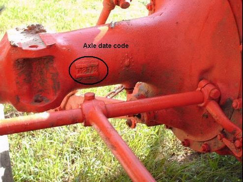

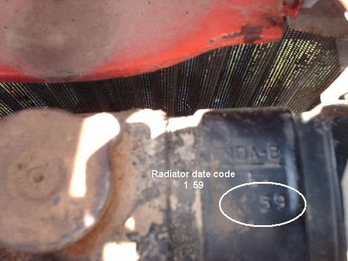

This is what a date code from a radiator looks like.

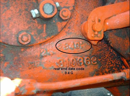

This is what the rear axle trumpet date code looks like.
And this is what the rear end chunk date code looks like.

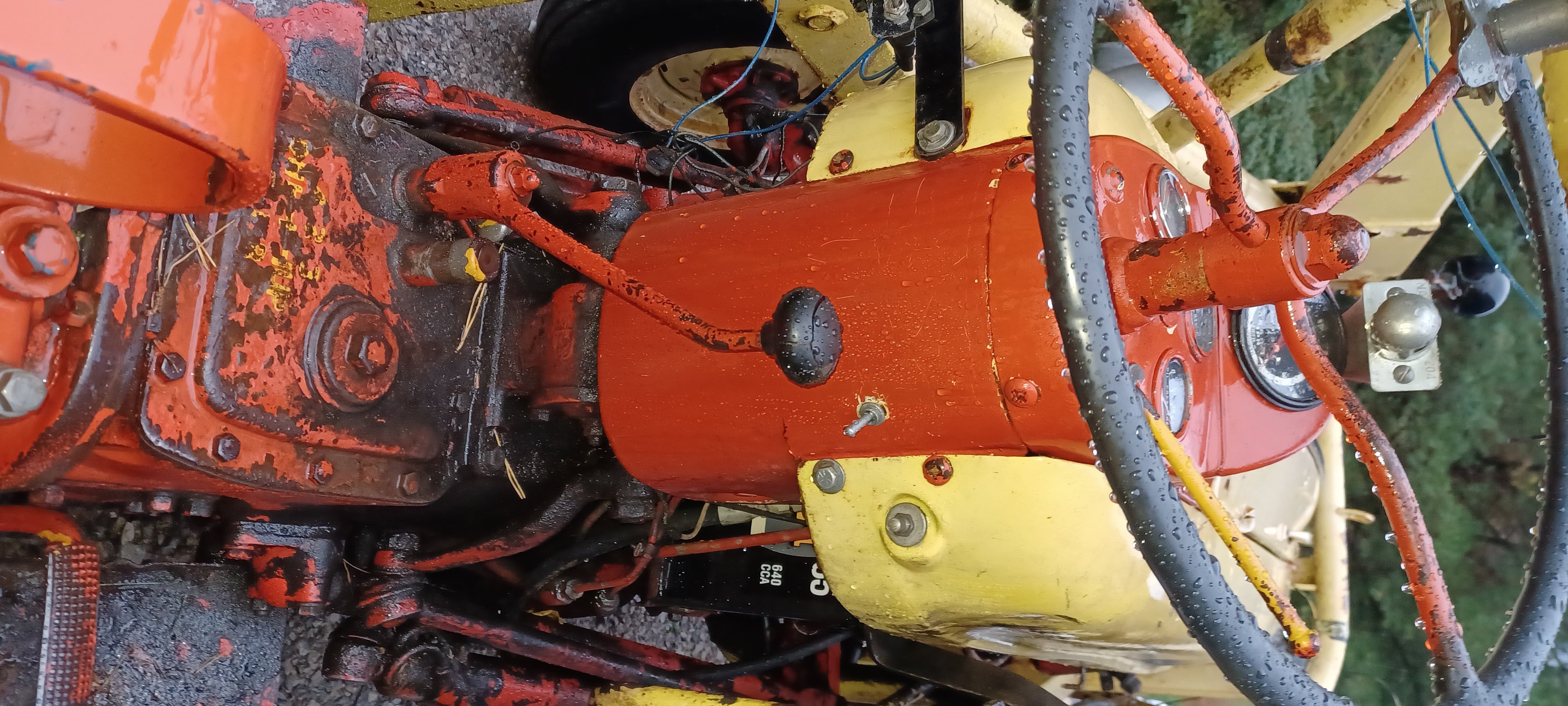

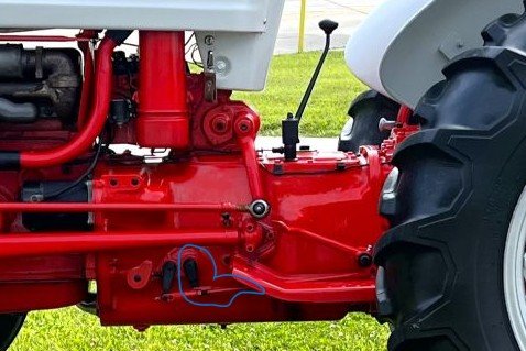

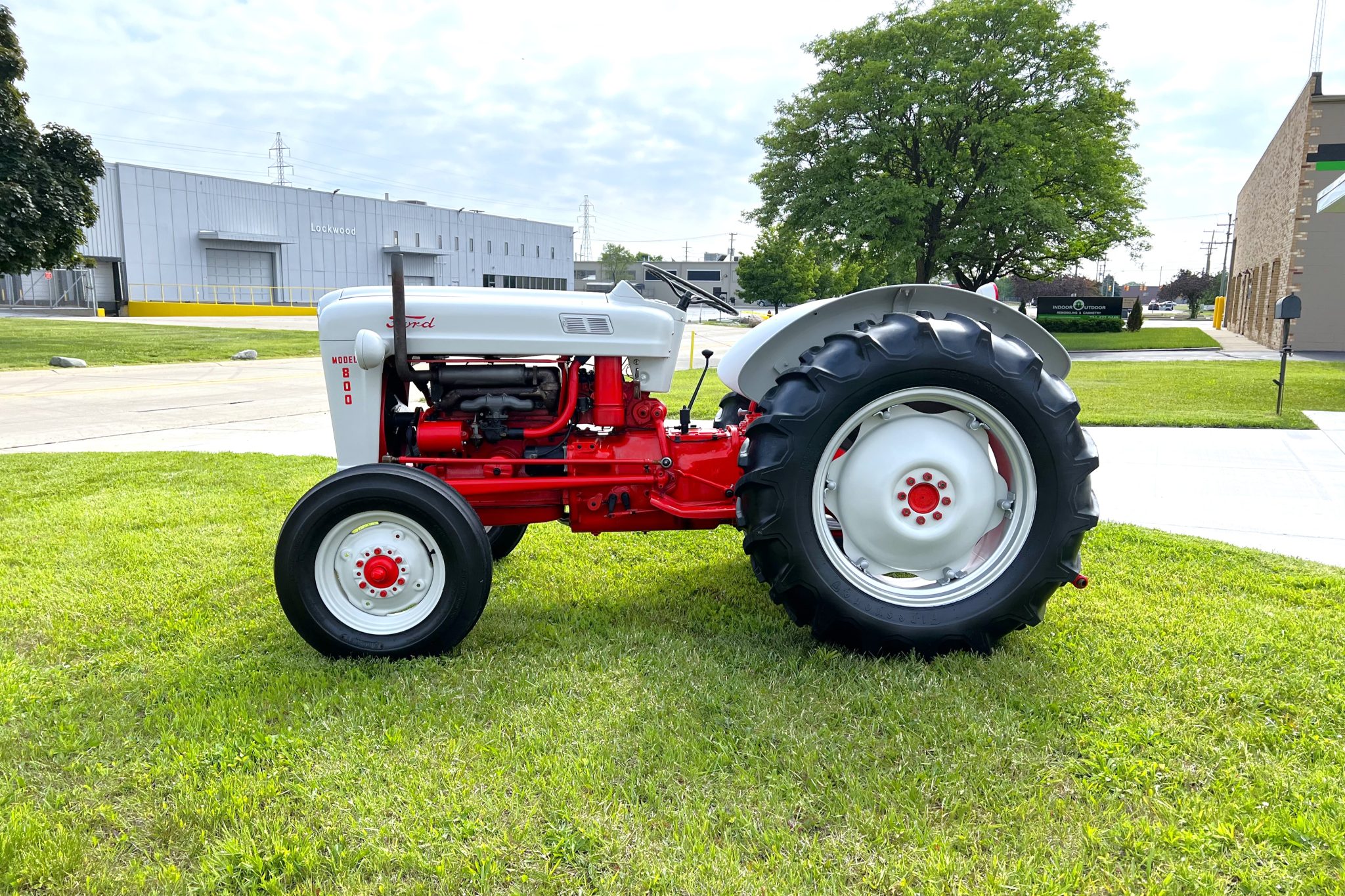

What does the rear lever on the transmission do? Mine is not hooked to anything and moves freely, but I do see pictures of 860s with something attached to it.View attachment 131693
This is not my tractor, but is labeled as an 800/860 by the OP and something appears to be hooked to this.View attachment 131695View attachment 131694

No hole below the steering wheel. I snapped a pic of the radiator but it was nearly impossible to make out the numbers. I will wait for the rain to go before trying again.

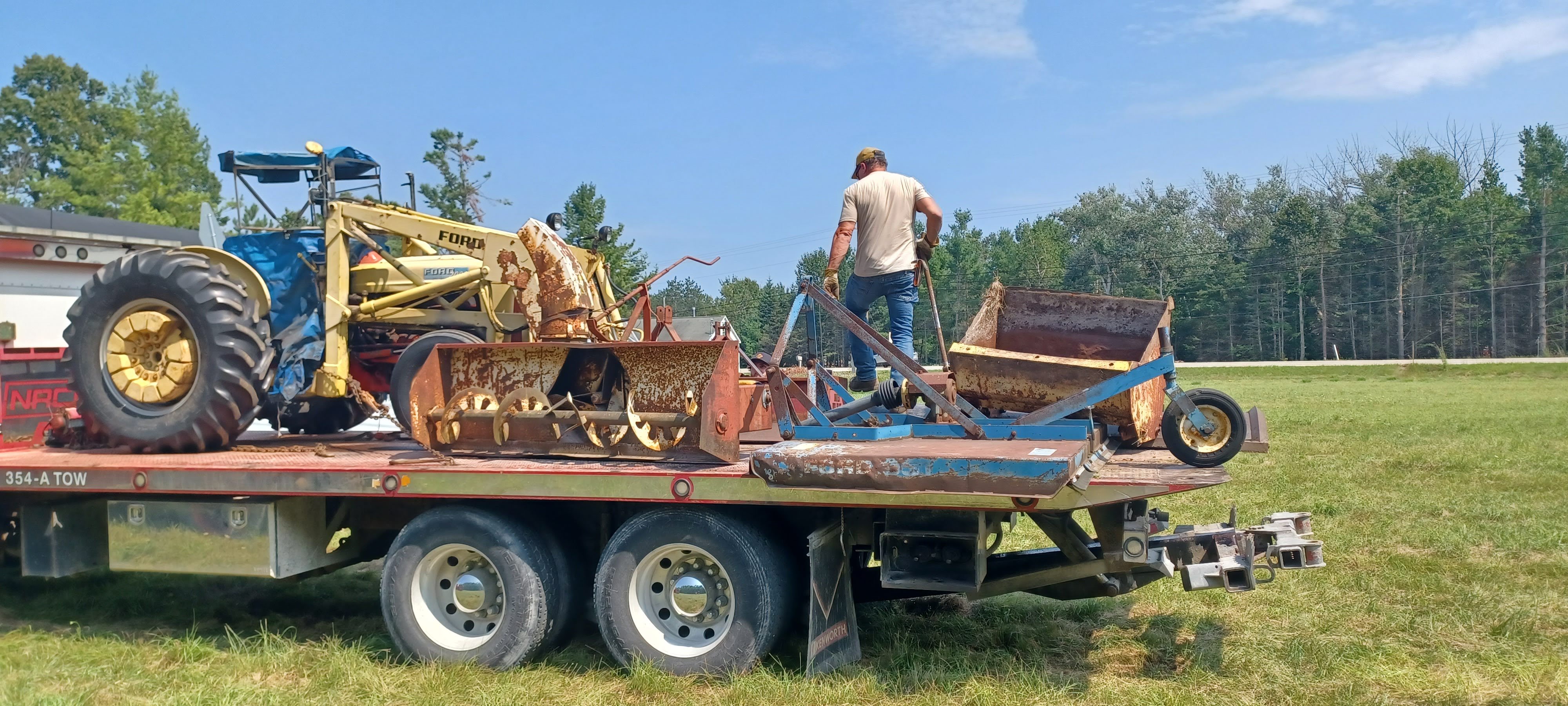

Not sure I included this picture before, but it had a "heater cab" on it made of tarps which did not survive the trip to my house. I still have the metal framework for it.
Tractor being hauled.jpgTractor Purchase Order.jpg The tractor is at least pre-78. Family says that it was owned by the road commission, which may explain the engine swap.

pre-1965. They stopped making the 4 cylinder 2000/4000 series at the end of the 1964 model year and switched to the new 3 cylinder models for the 1965 model year. They did continue to make the 4 cylinder models after that, but those were to fill fleet orders that were ordered previously for a large number of tractors to be delivered over many years. They even made the 4 cylinder 2000 offset model in small batches off-and-on until the 1710 offset came out due to the demand for a small offset tractor.
That is a rear end that was cast in November 1960 probably originally installed in a 1961 tractor. That makes it from the 801 era.
That radiator is not standard tractor installation. My have come with the motor from the industrial setting or was replaced over the years.
The only thing that matches on this tractor is the hood and rear wheel fenders both came off a light industrial tractor.
