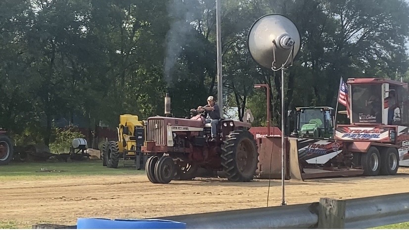

Recently we (Gransons) bought a 706D for tractor pulling and getting a gas JD 720 ready for next year, too. TRIAL AND ERROR IS GOOD BUT A LITTLE EXPERT ADVISE HELPS A LOT!!!! All is new 2 us, my other Granson has a WD and WD45 he has pulled a few times. I guess I am the metal man in the mix, spent a day today 95 degree day making the pulling hitch. He bought a different draw bar dedicated for pulling only and I fabricated a kick butt hit hitch for it. He pulled it (706D) once last year the day after he purchased it using a shaky hitch system with less than a desired outcome, but that isn’t where I am going😄.
The tractor (706D) has plenty of power there but he didn’t start out in the right gear nor did he use the torque. All you guys that have experience, what would you pull the 708D in???? Where does his torque come into play May sound foolish but he has a pull in a couple weeks and I really would like to see that tractor get down and pull like I know it can. *******Any personal input would be greatly appreciated.
I’m old and not born on a farm though some family had farms and back in the day that is where you worked as a young man and our first serious jobs but….. I only went to tractor pulls and I am -NO HELP TO MY GRANDKIDS CAUSE I KNOW NOTHING ABOUT THE DO’S AND DON’T OF TRACTOR PULLING BUT WOULD LIKE TO HELP MORE, OTHER THAN MAKING PARTS!
The old saying about the torque is it means your in the wrong gear twice. Start out win the lower gears ttill you see what it has and go up from there. Remember the heavier you pull the smaller the gear you want to run. Most guys that just start pulling think they have a beast and find out how hard that sled actually pulls. Good luck for the boys in the future. It is fun when you get it all right.
Appreciate the come back. I see pulling is a lot different than the old stone boats and guys having fun sitting on hay bails and jumping on the boat as it goes by….🤣.. Pulling in ‘idle speeds’ 3-5 mph is confusing to me and has to be hard on the tractors ain’t it???? Boys are having a blast and put a lot of sweat and blood into being able to buy their tractors. Wish I was more help!
The right gear 3-5 mph can work just fine but 3 mph for that tractor might be a little to slow. Does the places you pull have a tire size rule for those speed limits? Here you can run up to 14-9-38's or equivulant but 5 mph we can run 18-4's.

When we first got the '63 706D Demonstrator, it was of course turned up a bit, with 18.4-34s loaded and four sets of weights. It was matched to a 5-bottom Steerable plow, as IH was selling them as a 5-bottom tractor. It would pull it pretty well in Southern Tier NY dirt in L3 with the TA ahead but was working pretty hard, wouldn't happily have L4. Gramps switched to a 4-bottom the next year, and it would loaf in L3, and pretty happy in L4

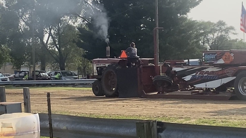

Mmmmm… Grandson pulled his 2nd time ever with his 706D on dirt. Tried a second gear config. but it never worked his engine. He polled in 4H TA ahead. No bellowing black just an easy walk to 175 ft (250 won by a hydro JD). He told me he had the throttle pegged but the engine wasn’t working hard at all… He’s still learning by trail an error but what are we doing wrong. CAN YOU PULL THE TA BACK PART WAY THROUGH A PULL TO GET MORE TORQUE??? Never spun a tire…. We have no access to a sled other than pulls to try and figure this out. He wants to keep it ‘stock’ so how many problems can be had by turning it up or is it all gearing. HE DID WIN ‘Best Original’ in the tractor show. Not to proud to learn!!!
This pulling org had him pull in the ‘Farm Tractor’ class not antique at #9000. He was pulling against newer hydrostatic JD which took the class. Each pull sponsor organization seems to have different rules. Out new 18” hitch on the 706D had to be changed before the pull (We weren’t prepared for this to say the least) to 20” which seems crazy for a 13” draw bar. Anyone have thoughts on this???? What do you all do…..

Back to the thread again fellas, I am still looking for input from you experience tractor pullers: The original drawbar on other Grandsons 706D is 13”, have any of you guys ever had to build a 7” high hitch adapter to pull in a local “farm tractor” class. This is quite a stack of iron to fabricate to make the 20” min cut. All other area pulls are “18 and I figured I did a good job fabbing a permanent hitch ( he bought a different drawbar just so we could set it up and switch it out for pulls. He is keeping it all original otherwise. I can build it but it will be a hunk of iron! What would you guys recommend???????

Usually you want your hitch as high and as close to the axle as the rules allow. Make it adjustable so if you pull with different clubs you can change it easily. Should be a lot of pictures on line to get ideas from as there are many many large frame IH tractors pulling out there.

Thanks for your reply. Ya I have no problem making an adjustable one, I guess doing it in a ‘practical way’ . Though I see many, especially in the antique class like my other Grandson pulls his WD and WD 45 in, the let loose hooking points go. He was told in this last pull ‘no pins’ everything had to be bolted. I have to design a way to move the 1” thick hook plate that is bolted (3/4” bolts) to be adjustable. MAYBE I JUST DON’T UNDERSTAND OR AM JUST OVER THINKING THIS. I was a metal fabber for 30 yrs, 10 for the DOD but I am scratching my head on this one. Removable plates and a bucket of different length bolts????? The downward pulling torque on a 7” high raised hooking point has to be excessive pulling 20,000#. Grew up working on farms like most of us did around here back then BUT this pulling is a completely new experience 😳😎

You asked about the 7” high adaptor. The drawbar is only 13” to top on his 706D. I have to raise it 7” to meet the last pulls requirement of 20”…. Am I getting this wrong. The sleds chain is anchored at the sleds bottom and not very long at all by the time you hook it up at 20” where from my experience puts a dynamic force downward on a farm tractor drawbar and the designed pulling hitch which on his last one I removed the ‘roller’ off the drawbar he bought for just pulling and used grade 8 -3/4” bolts through the existing drawbar holes and 3/4” on the entire hitch. A zillion times more structural stress than the toughest implement you would ever do field work with, concidering he had to pull in the farm tractor class, even though it’s a 50+ year old tractor. What is usually the age limit to be concidered antique class? *Just trying to figure it out on how to compete with newer more advanced tractors if that is the way the rules go.
