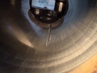

Here is a pic. I am tending to agree with loose snap ring. There was one loose but not on that piston. I am guessing Maybe they took it apart again after and put in a snap ring.
Here is a pic. I was liking the wrist pin idea, as they had snap wring loose on another piston. But the gouge should be 90 degrees form the crank and it is about 70.

It would be a long list. One wrist pin snap ring not seated correctily, No 4 rod bearing was not put on right. It spun and the cap was loose enough to wiggle after. Replaced rod bearings but not the mains, still discovering stuff.
Last time (2 times) I dealt with that I went to bare block and started over. It worked for me.
The current snap ring is intact. No parts missing out of the piston rings. What ever happened was repaired (except the sleeve). I am going to try to pull, but not going to force it as in Scooter's picture above. THanks all for the input.
