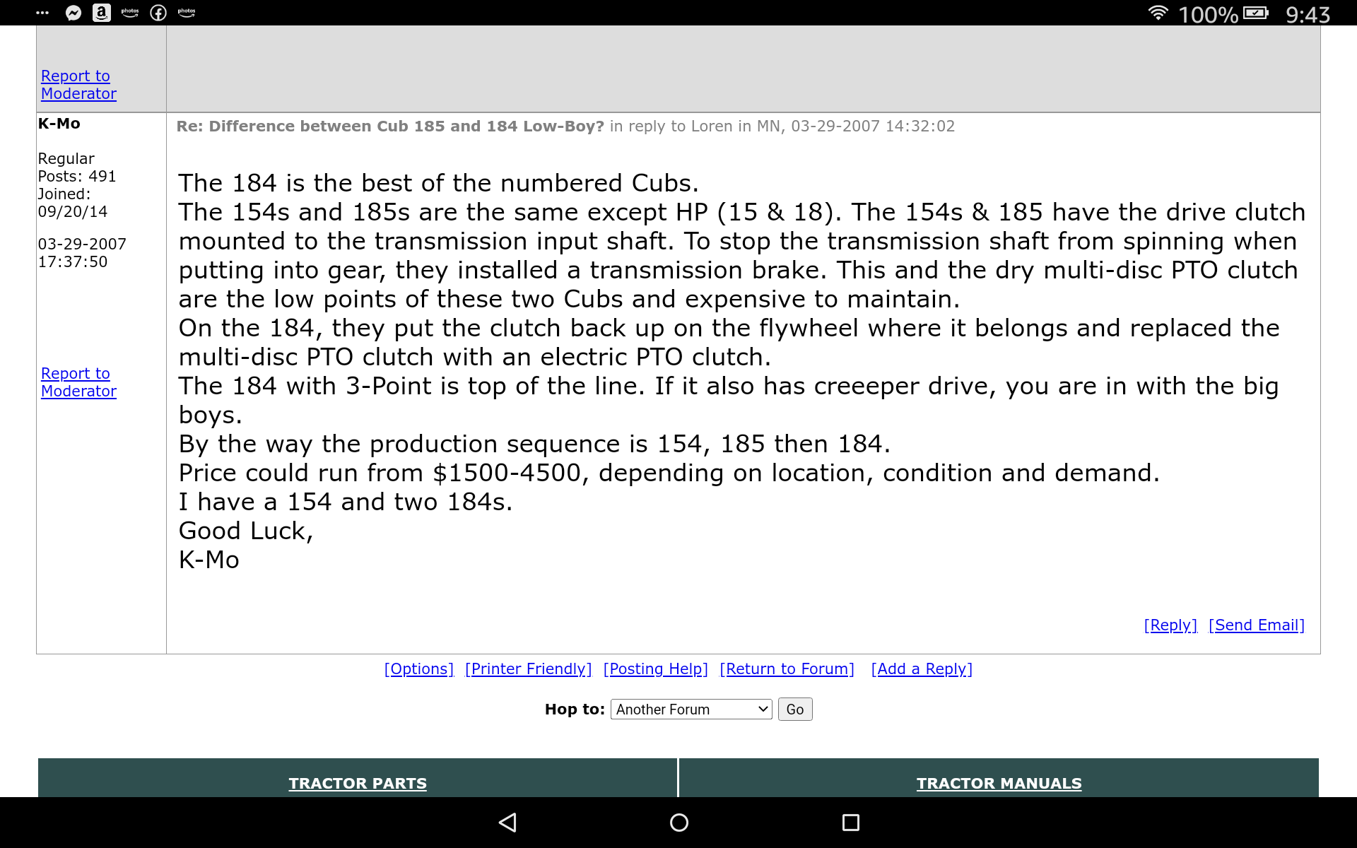

This here is a screen shot of K-Mo's YT post in 2007.........
Interesting. I didn't think IH put much thought into the 184 other than updating the styling to match the current lineup.
If the clutch is back on the flywheel then how did they get IPTO? The 154 and 185 had the IPTO belt driven off a pulley at the flywheel, and that's why the clutch was mounted on the input shaft of the transmission. With the clutch back on the flywheel, where was the pulley? Parts book is unclear as it shows the IPTO parts with no context as to how they fit in the tractor.
