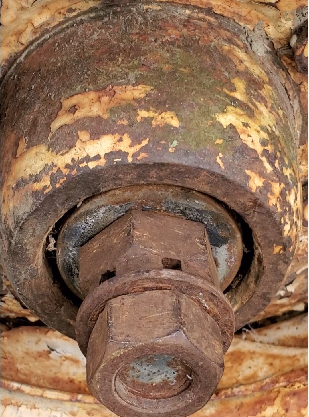

Every tractor I own was used, probably by more than one owner, before I got ahold of them. All have had repairs that reflect a hurry up job, with no care to keep the tractor original. The latest tractor I've purchased from a daughter, whose dad has advanced Alzheimers, and no one knew any history on the tractor, other than it had set for 10 years. It has a few repairs that make me think somebody liked to use his welder. Here's a picture of the front wheel axle repair. Any suggestions on what to do with this and do you have a quick fix repair that somebody did,

Washer on the wrong side of the castle nut! JIM

I never wonder what they were thinking. Very rarely if ever are such repairs made out of malicious incompetence, meaning they are purposely trying to make a bad repair. Time and money are the major driving factors in field repairs. Farming wasn't always the lucrative enterprise it is today, and you didn't always have the money to fix everything "the right way."
To fix that you'll probably need to find a good used spindle, probably new bearings and seal, if not an entire hub.
Them spindle threads don’t usually stick out that far to screw another nut on. Lookin pretty dry in there also. Maybe he just ran out of cotter pins and had no 4 inch nails. Lol.

My guess is it used to have the two piece nut and he replaced it with a castle nut. When doing that you need a couple extra of the big washers with a keyway notch. Been there done that but I found the extra washers.

The kind of fixes I have come across and are referring to are: welded seat mechanism because the rubber torsion spring gave way, holes cut in side panels to access sediment bowl shut off or wires behind dash, shortened drawbar by cutting off the front and blowing a new hole in it for the belly pin, lengthening the drawbar by welding a sandwiched piece into it, drilling out front wheel lug bolt holes, after stripping the originals out, and putting bolts with nuts on to hold the rim in place, putting a steel bushing in the steering wheel column and welding it, instead of the original bronze, etc. The NF front axle in the picture had the castle nut stripped so the repair was to weld a piece of smaller threaded stock on the end and use the castle nut and four washers to shim the bearing tight. The normal notched bearing washer was all that sealed the bearing. All the things I've mentioned, and there are more, I just can't remember them all, I have repaired. I'm no expert at any of the skills that they require but I trudge through them until I have them fixed right and as original as I can make them. I like a tractor to be as it came from the factory and take pride in making it so.

In the OPs wheel spindle example, if the tractor was worth $500 when it needed fixing, it would have cost probably $200 to have the spindle welded and rethreaded. No point in throwing good money at it when not necessary. It obviously served out the old man’s needs and is not his problem anymore.

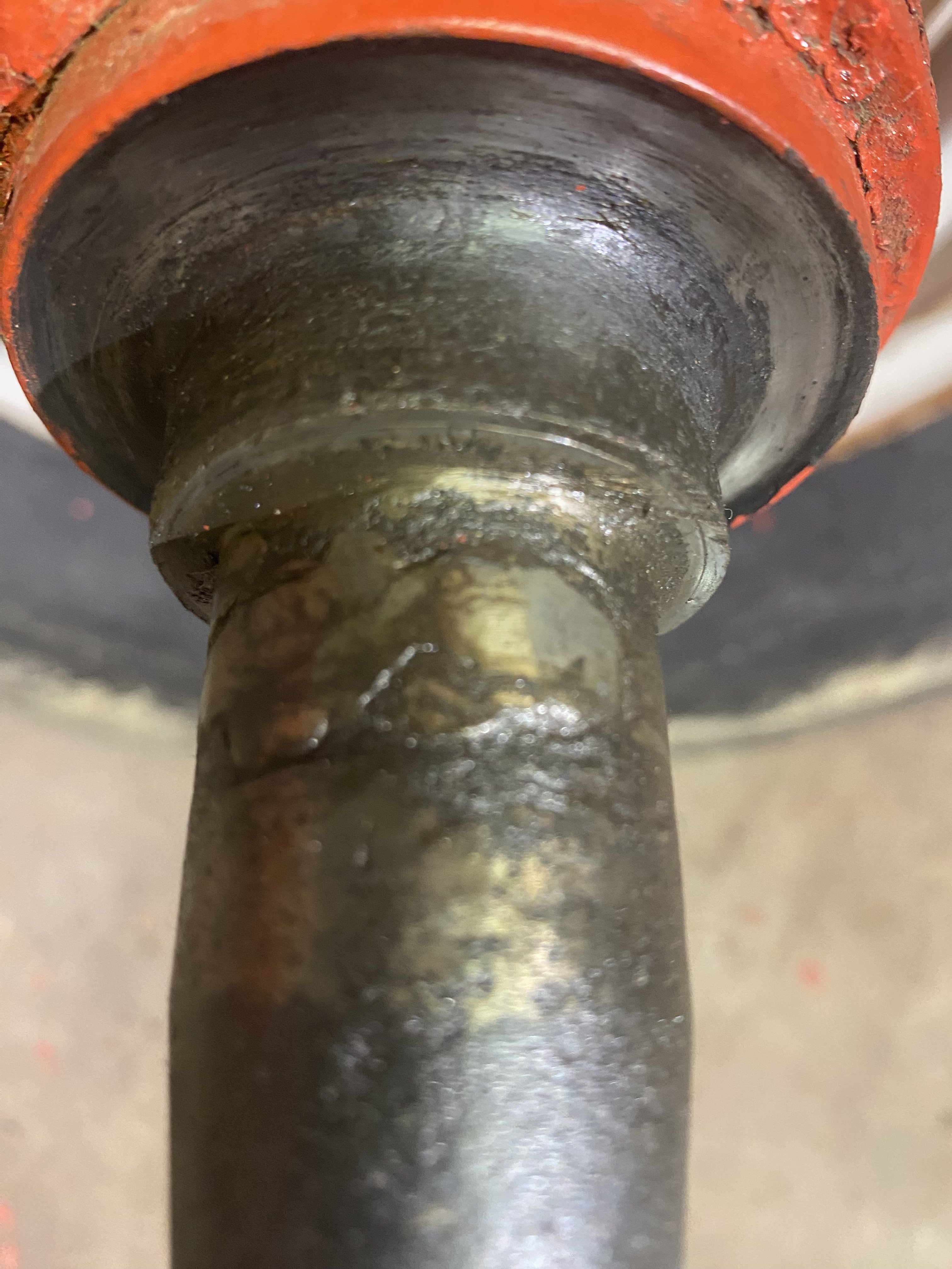

Here is what I found after removing the hub and bearings:
The bearing race had been broken by forcing it over the weld. There was little left of it. There was no surface for the seal to seal to either. I had to source a new piece of smooth tubing to have a seal.

Wonder if there's enough thread on there to use a clamping nut.
Wheel Clamp Lock nut
As far as farmerized fixes...before I learned about clamp nuts, stripped the spindle on my 5000, which was my only tractor at the time. Wound up getting the preload set on the bearings, then a few tack welds to hold the nut in place. Been there 25 years now.
