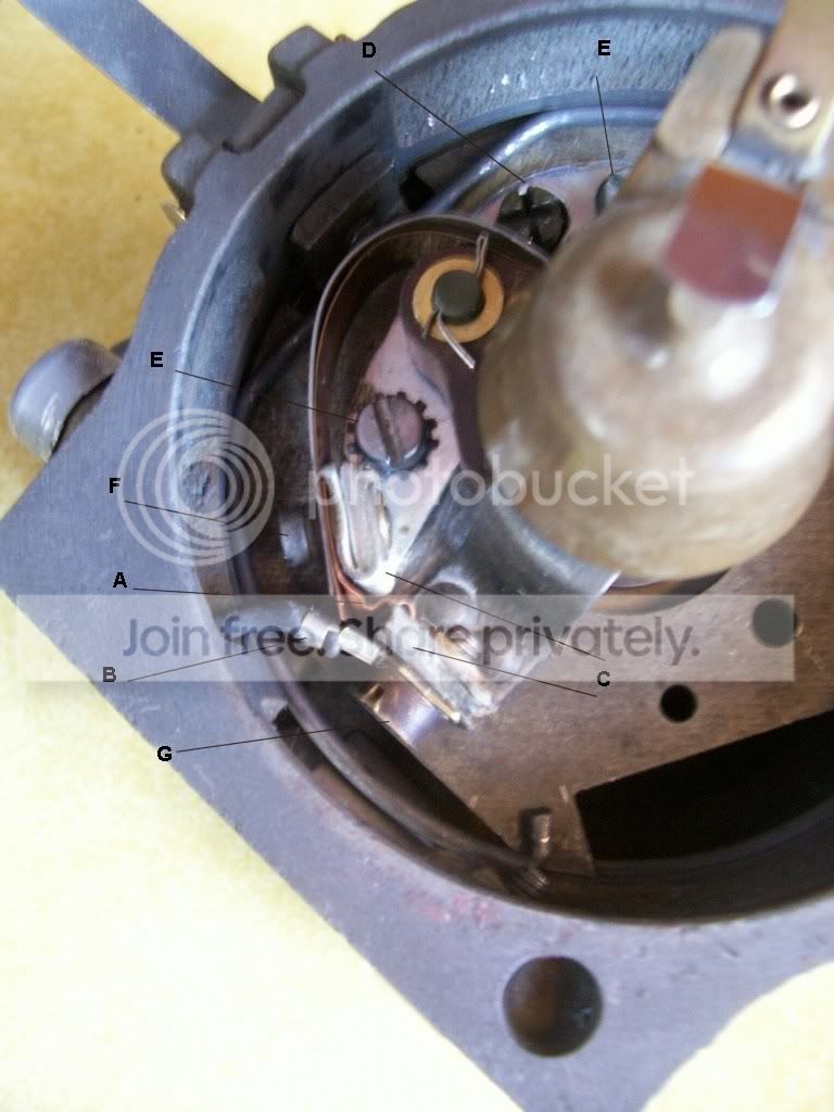

Power to top of coil but no spark....Did you check to see if the points are grounded to the case even when open? If so, not good, and means most likely shorted out where the concave screw goes through the copper strip(where the coil spring contacts) that concave screw is insulated(suppose to be) from the case and that insulator is famous for breaking down...or maybe you let the condenser wire connector twist around and ground out against the case......points set on .015 and open and close like they should. Copper strip could be broken...check these things and let us know how it runs......I'm betting it is one of these things
Are you sure that the other coils are bad? Sometime when you have a spare few minutes, try one of the other coils again with the cork gasket removed from under the coil..Lots of times the spring contact on the coil does not contact the concave screw as it should..With the gasket removed it will contact the screw...with gasket removed, fold a piece of paper to put under the coil bail so the bail will still hold the coil down tight..If it cranks and runs like this, then the pigtail needs carefully stretched so you can put the cork gasket back under the coil but still let the springy pigtail make contact....
In addition to what the others are asking......what is a "12v to 6v" resistor? You should only have one resistor in the circuit if the tractor is 6v & it's not a 12v to 6v resistor. It should be p/n 12250. It should measure about .3 ohms cold.
