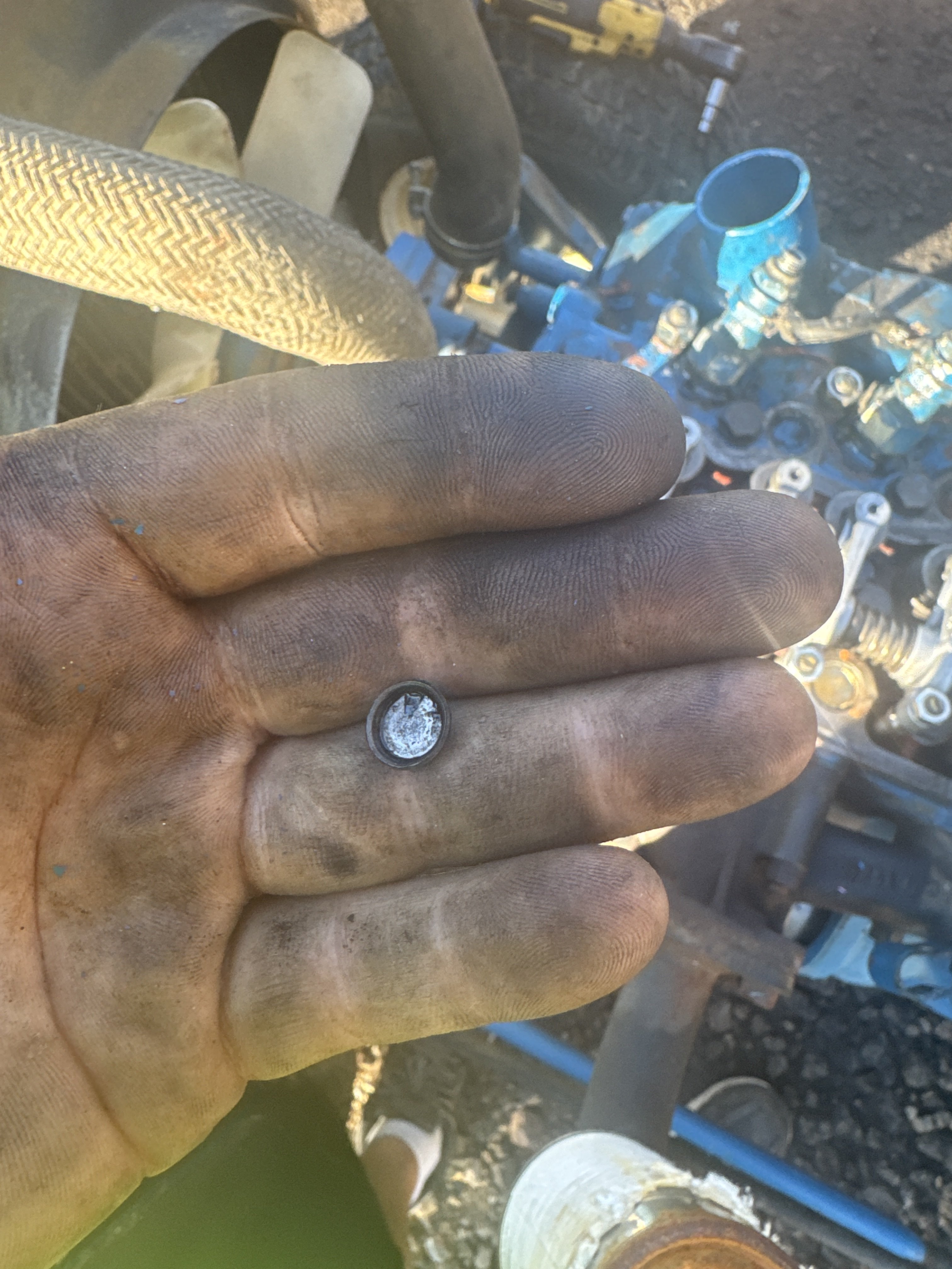

When I was taking off the rocker arm assembly and the head. This piece fell out. Where does it go? All help is very much appreciated.

What you have in your hand looks like a cap that was used on some valve stems to protect the end of the stem. It looks like you are working on a Continental engine.
Agreed, looks like a lash cap. If you have one probably all valves will have them, or At least 4 depending.

I have not flipped the rocker arms over, but could these perhaps go up inside the boots and go on top of the push rods?I had this thought after asking this question.
