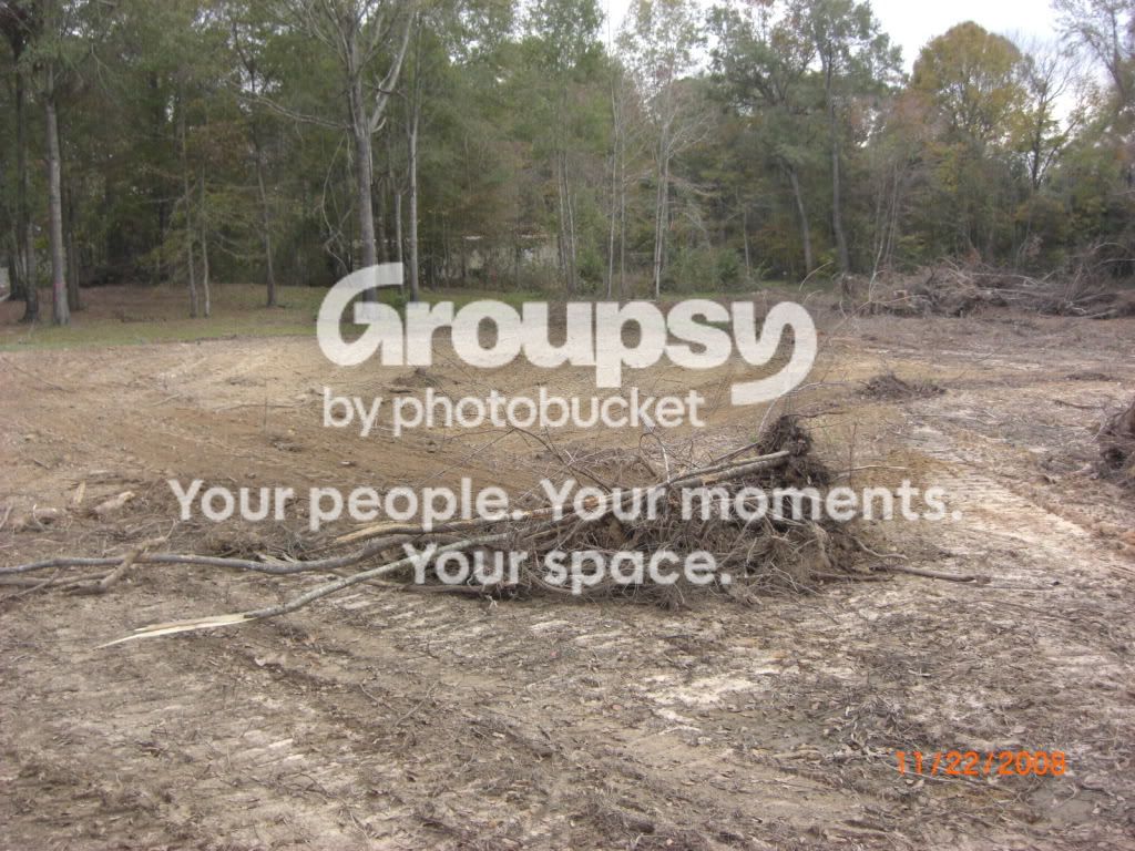

For those that have seen the pictures of my "Root Rake", these are the pictures of it in action. For those whom have not seen it there are pictures a few pages back. 50 HP (42 HP drawbar) is adequate for 7' rake. I feel the hydraulic top link makes the rake just that much more useful. When trash hangs up in the rake the added pitch from the HTL will usually dislodge it.
[b:44039570dd]Loaded Rake[/b:44039570dd]
[b:44039570dd]Two passes[/b:44039570dd]
[b:44039570dd]Small Tree in Rake[/b:44039570dd]
[b:44039570dd]Tree that was in rake, I pulled it up by the roots[/b:44039570dd]
[b:44039570dd]WindRows[/b:44039570dd]
[b:44039570dd]More WindRows[/b:44039570dd]
[b:44039570dd]King of the Pile![/b:44039570dd]
[b:44039570dd]Cleaned Area: I love this Rake![/b:44039570dd]
Sorry for posting so many pictures, I am just excited about the land clearing, building the rake, CMM hydraulic top link, and cleaning up 50 acres of land!
Enjoy,
Charles

Any land I have cleared was for grain, forage, corn or potatoes, in an area where frost each winter keeps heaving up left behind roots up to the surface. Our goal is to remove every root 12" deep in the soil. Everyone who has had the misfortune of getting a 4' long root, 1" in diameter tangled up in a combine, stalk rolls of a corn head or potato harvesting equipment will understand what I'm saying. Not only can these roots cost one a lot of lost time, but the damage they can do to harvesting equipment is prohibitive.
Having said this, I judged your rake as I would use it, rather than just cleaning off the 20% of roots within 3" of the surface. If you don't plow it again for 20 years, and given the fact you don't have frost in LA, the rake will be a success. I still say if one of those teeth snag a stump 2" below the surface, the 504, has the ability to rip a section of pipe wall around tooth, right out. Believe me, I know the ability of that size tractor.
Looks like it's going to work dandy for your conditions. Didn't see any rocks in the pictures of course. It would last about 10 minutes here.
Looks like a neat fabrication job, and for those conditions it did a nice job. Must not have engaged the ground too aggressively, all stumps must have been out first too, as I can see where hooking onto a substantial root or small stump would stop the tractor, as I've had that happen working areas I've cleared, tractor stops and you lose traction. Interesting to see how things like this, something you've fabricated yourself, actually perform, a lot of these implements/attachments started out that way, then trial and error, until the design holds up to the conditions, and even then, site conditions and methods used can still cause problems.
What Hugh mentioned is interesting too, when putting land that has been cleared, back into crops, never thought to be aware of roots coming up like that once broken up with a rake. I suppose one would have to clear and work the ground a bit, a season or 2, see what comes up.

Thanks again for the replies. It was built for the soil conditions and matched to the tractor. I'm not sure what Hugh ment by "20% of the roots 3" deep"? After I make two passes at right angles to each other it pulls almost ALL the roots and trash out.What little roots are left poking up will get bush hogged down by next year.
I respect Hugh, he has been farming for about 80 years and has a lot of good experience. If I am not mistaken he has owned a 504 gas before. I have my 504D loaded about 90% pure water (No freeze threat...) in 14.9"x38's. The rake can stop it cold in its tracks when it connects. I am running 1st and 2nd gear DD. I can set the draft control to heavy and bury the rake or set it a little lighter to scratch a few inches deep. The HTL is AWSOME! I feel this implement would have been a near disaster without the HTL.

Charles: I hear you, but my customers wanted 95% of all roots gone down plow depth. With the frost factor, that meant chisel plow had to run 12" deep to get all.

Looks like it worked to perfection! Of course it ISN"T a chisel plow OR a rome plow, OR a clearing rake, or a dozen other tools. From your description, it wasn"t intended to be any of those tools. It"s a purpose built item that works. Simple enough.
Out of curiousity, have you totalled up the material cost on that rake?
I"ve started using hydraulic top links on several tractors. They add another dimention to the 3-point hitch. Just about every mounted implement can benefit to a greater or lesser degree by using them. I"ve found them extremely useful on mounted plows. Makes for fast and easy adjustment to plow out dead furrows among other things. Those HTL"s can"t be beat for use with a box blade!
Cost... That is always a tricky subject when you build something.
Running cost:
2 - 21' joints of 2" sch 80 pipe = $200
2 - 20' joints of 2"x2"x1/4" angle = $140
1 - 20' joint of 3"x1/2" flat = $60
50 - pounds of 7018 welding rods = $60
1 - HTL and shipping = $200
2 - hoses and fittings for above = FREE...
51 - shanks = FREE, cut from scrap metal
I would say less than $500 actual cash... Including the HTL, about $700.
