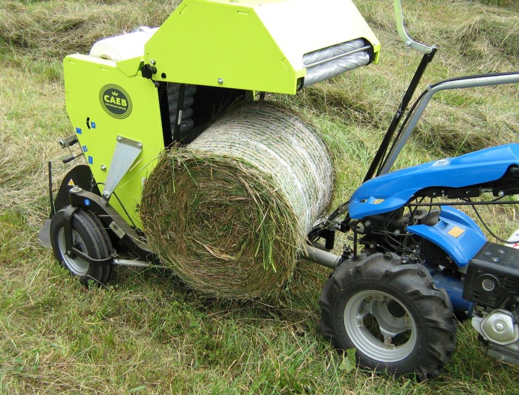

The New Idea 484/4484 was a decent, mid sized round baler. Unless you really want a small round baler. They (Caeb) make them tiny enough to put on my rototiller.
