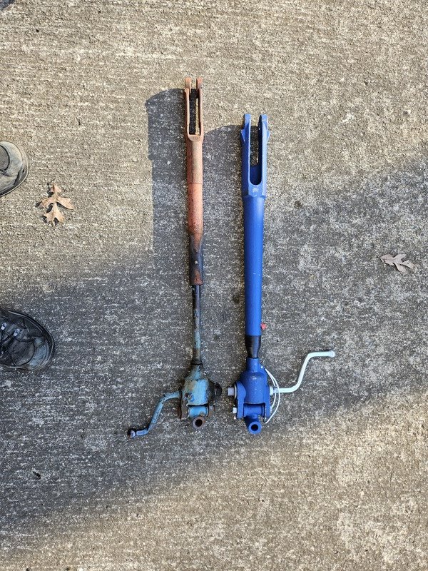

The unit I decided to go with is part number C5NN569AM. These are widely available from YT, eBay and other sources for around a hundred bucks. I bought mine from an eBay supplier, but I assume they all come from the same manufacturer. Here is a comparison of the two units; as you can see the top ends are pretty much identical, but the bottom of the three-cylinder unit is much bigger. Not only is it wider, it uses a 3/4 inch pin instead of the 5/8" of the older unit.

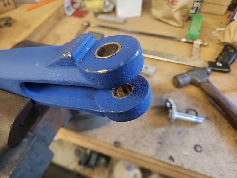

To eliminate slop I inserted a 5/8 x 3/4 inch bronze bushing from Ace. It was an inch long, so I drove it halfway down one hole, then cut it off and used the remainder on the other side. I'm pretty sure this is unnecessary, given the amount of slop in the lift arm balls.

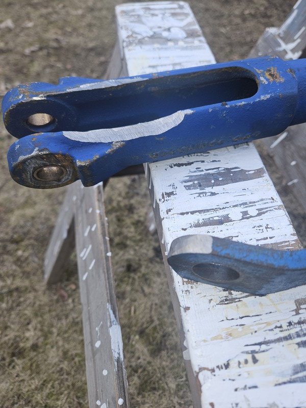

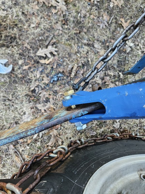

Since the pins for the older tractors are too short for the jaw of the new unit, I substituted a 5/8 x 3-1/2 inch grade 8 bolt. (I'm sure grade 5 would be fine, but Ace had the grade 8s so that's what I used.) I knocked the chain eye off one of the new pins (it's just a press fit) and put that on the 5/8 bolt. The original pins are shoulder bolts where the nut tightens on the shoulder; I secured the new bolt with a double nuts (regular nut with a jamb nut). The new chain shackle was too fat to clear the bolt head, so I reused one of the original shackles. Here's what that looks like installed.

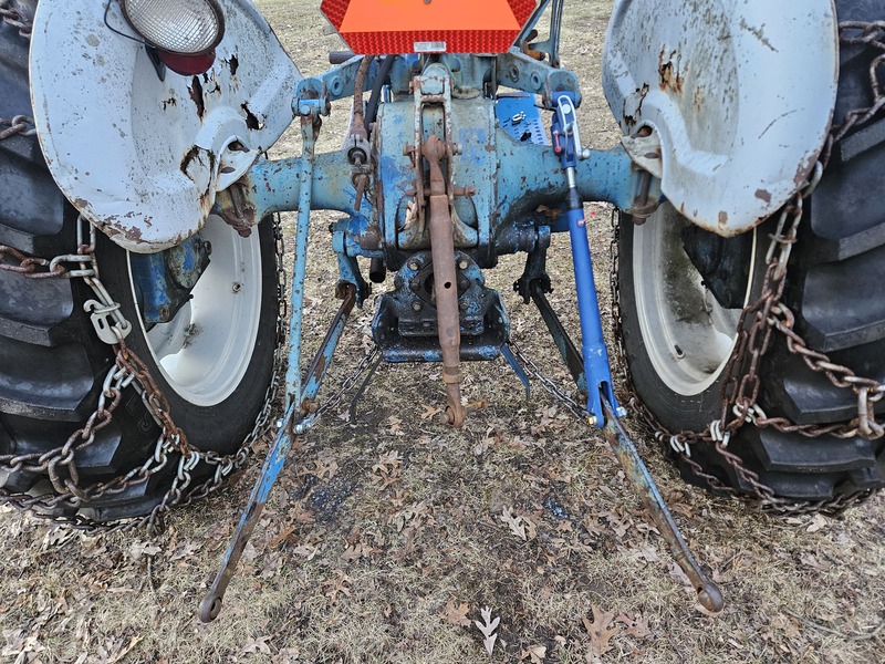

Here's the completed installation. Frankly, that big leveling box assembly looks totally out of place on my tractor, but I think it will work. So I give it 8/10 for functionality, but only a 3 for aesthetics. I may need to do a little more work; I think I'll have to grind down the end of my right-hand sway bar to clear the leveling box jaw. And I may add a couple of washers to center the jaw on the lift arm. Hopefully somebody else will find this information useful.
If the one large arm aesthetics bother you enough, replace the left one with another big leveling box assembly. Might be pretty handy even if you dont find it handsome :).
Or even the standard left side link from the same 3 cylinder thousand series as the new leveling box.

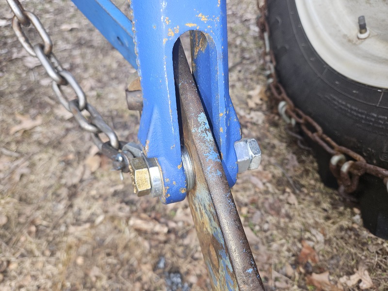

Addendum: I ground down my stabilizer bar (aka sway bar) and the jaw of the new link so there's enough clearance to install stabilizer bar. I also added a stack of washers inside the jaw to provide a bit more clearance for the stabilizer bar. It looks a bit tight, but there's plenty of room when the three point is up in its normal operating location.
One last followup: I put the tractor to work yesterday, grading the potholes in our driveway with the heaviest implement I own, a Woods HBL- 84-1 rear blade. I think it weighs around 600 pounds. It worked well. I have noticed that the crank on the knock-off leveling box operates more roughly than the original. Maybe it will get better with time, maybe not. At any rate, I'm satisfied with this solution.
