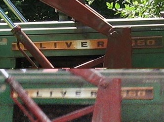

Trying the Rust-Oleum. It's kind of so-so - not near as fast as it says. Waited the 30 minutes and didn't see much accomplished. I put on a good coat and left it set over-night. Worked and didn't work like I wanted but better wearing out Dremel wire brushes.
Trying it here and there.

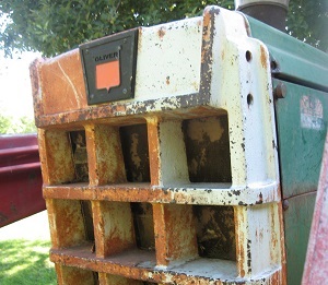

Leaning over the end loader, I spilled some on the grill, not much at all and this morning I found this. Guessing spilling it on is better than a brush, but won't push my luck. Thought about just pulling the grill and having it blasted. Wonder how much the grill weighs?

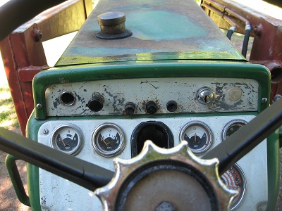

More pics of Rust-Oleum at work. Wet whatever down good and then wait. Wiped the hood down with wet hand towel - see above.
It doesn't convert rust, just makes it go away. None of the Rust-Oleum shown were wiped down. Some places there was a white residue, easily wiped away.
