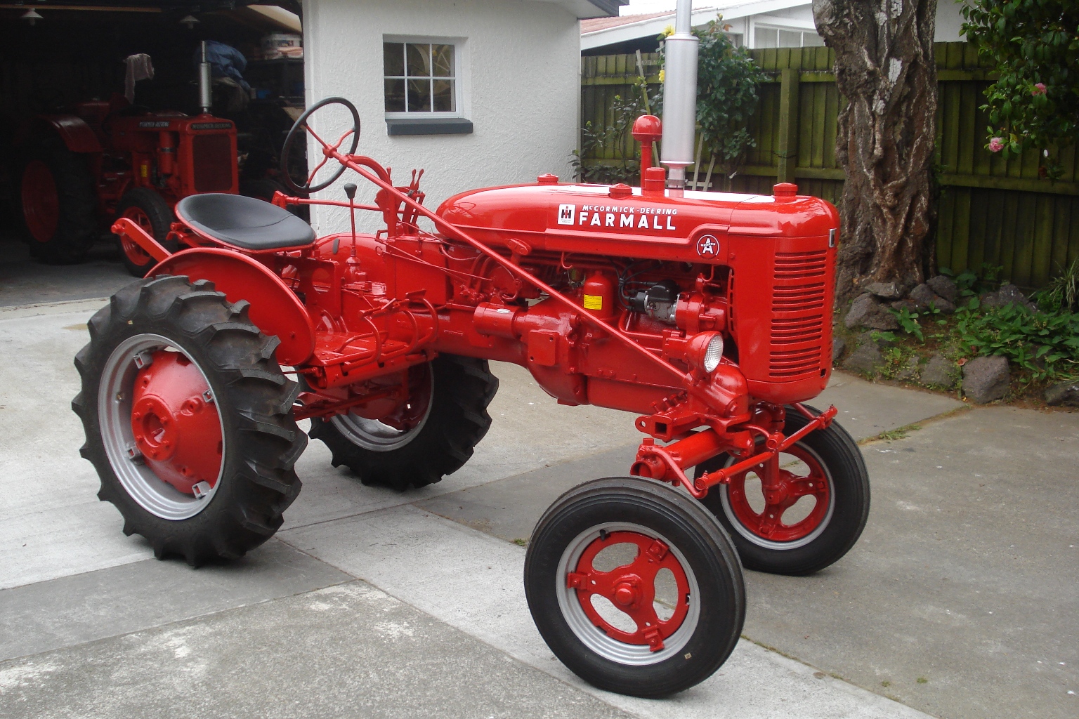

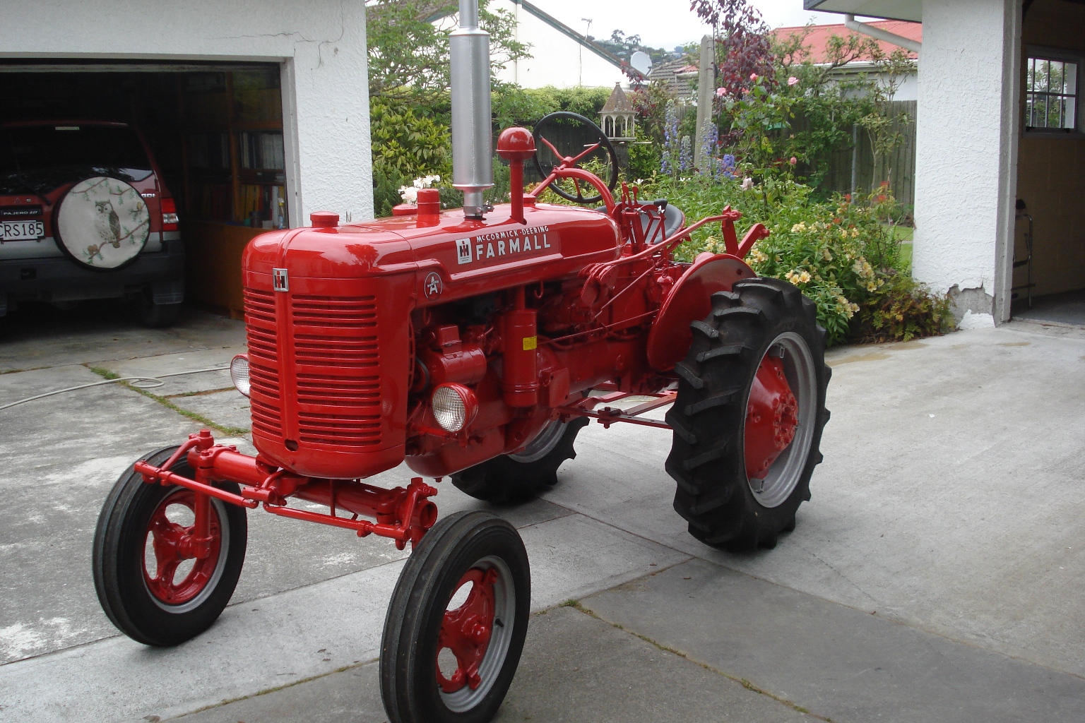

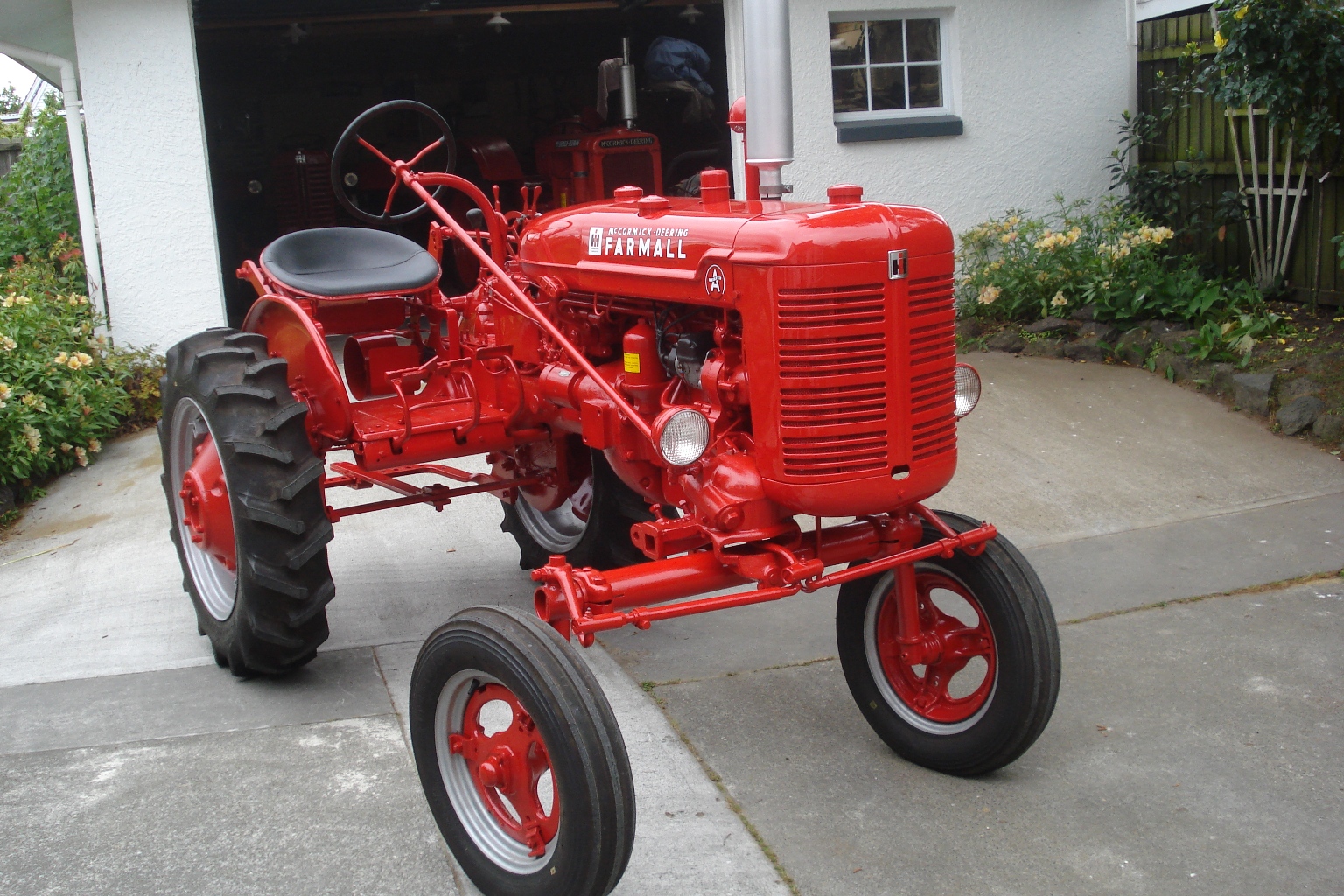

The Farmall Super A came with choice of gasoline, distillate or kerosene pistons, mine (1948) was kerosene. The last two versions had the gasoline starting tank, radiator shutters and the hot manifold.
anything can be done, if you have the money. so why ask, if your up to it get her done.
Here is mine
