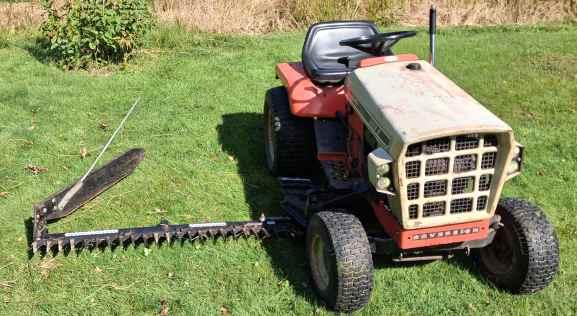

Next big project on the 3416 will be figuring out and mounting the sickle bar. Fortunately, I have the books for that.

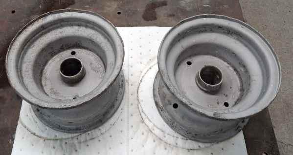

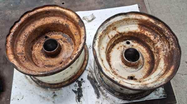

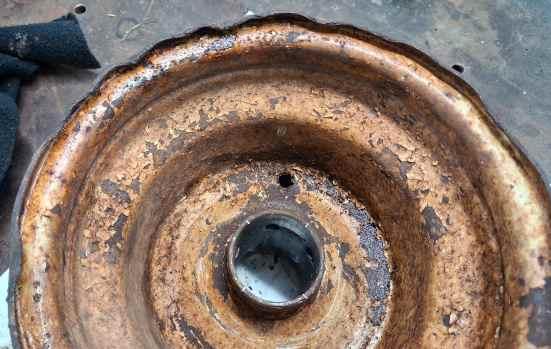

None of the tires hold air, the front ones are complete trash. Pulled the front rims/hubs off to facilitate changing tires and found the outer bearing missing completely on one, and the other three growling pretty bad. Fortunately, commonly available. Left kingpin/spindle assembly hacked together with keys mangled.
Did a little pre-treatment with phosphoric acid on the battery box and seat pan.

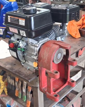

First goal is to get the engine running. If it's pooched, there's no point in messing with the rest of it until I figure out a re-power. I do want to "save" it as it has a hydro trans and hydraulic lift.
