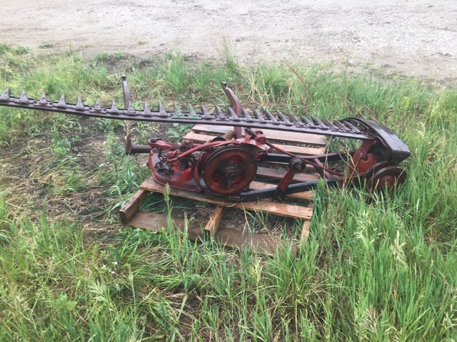

Here is the mower. I have the seat for the tractor, the battery box under it just rusted out and came loose. Once I get the tractor running and can see how well the loader works, I will decide if I want to keep it or not. I can make use of a loader tractor.
The mower fast hitch prongs look to be for a Small frame tractor like a Super C or 230 tractor. The fast Hitch on the tractor looks like a 300 or larger FH. Jim
Not claiming to know for sure anymore but from what I remember all fast hitch mowers were the small point. Needed to use the spacers on a large socket hitch.
You are correct, the mower prongs are the small point 2-1/2” tall. The sockets in the fast hitch are 3” tall. I don’t have the factory spacers, but it won’t be hard to make some out of 1/2” thick steel.
Oops I misspoke. I had a CP-24-P and that is what that mower is. The IH dealer used the 25 and 27 V to look up a lot of the parts for the mower since they are basically the same except for the 2 point.
I don’t think this one is that either. I do have another fast hitch mower that is the pitman type and the sickle bar and drive mechanism is the same as the 27v, but this mower I just got is the pitman-less type. The cutter bar may be the same, but everything else is totally different.

That looks like the other fast hitch mower have, but is very different than the one I posted pictures of above. The one I just got is what is called a “balanced head“ mower.
Oh heck I'm sorry when I first looked at it I thought it had a pitman arm. This mower is a 100 since it has the wobble box. The pictures would not open up so I could enlarge them to see the wobble box. I sold the CP 24 many years ago and bought a 100. I had to have the box gone through by Rouse rakes since it was full of water, but is twice the mower that CP 24 was!!!!!
